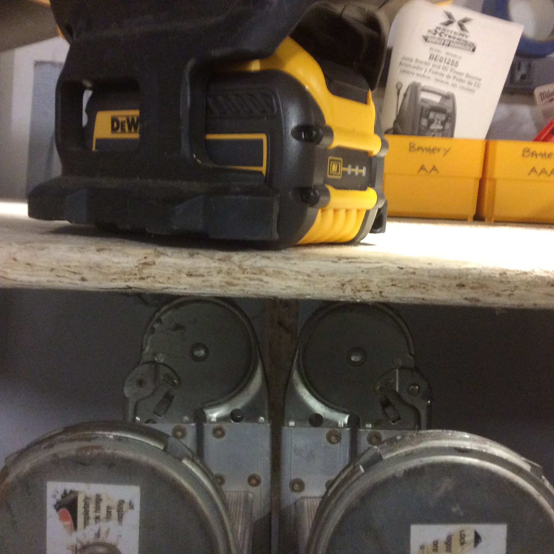

Hi,,thanks for the videos guys…..the new 9ah will fit in the blower ,very tight and it sticks out the bottom ,so your battery rests on the ground  not the cage..
Framer joe wrote:
Cool man Thank you??I love that blower! How’s the runtime with that bad boy on there?
Double the run time…really don’t notice the weight,,but b careful setting it down
