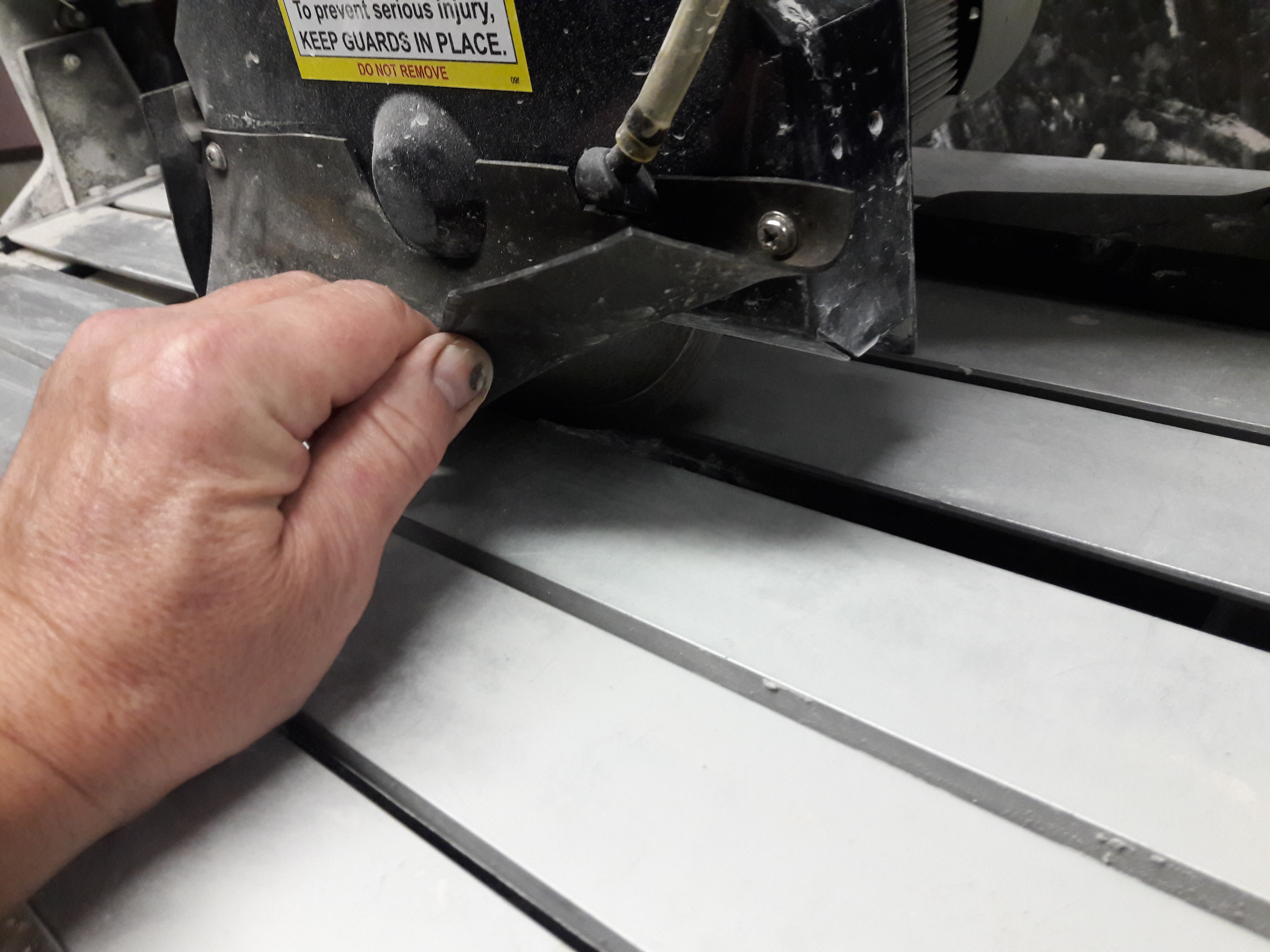

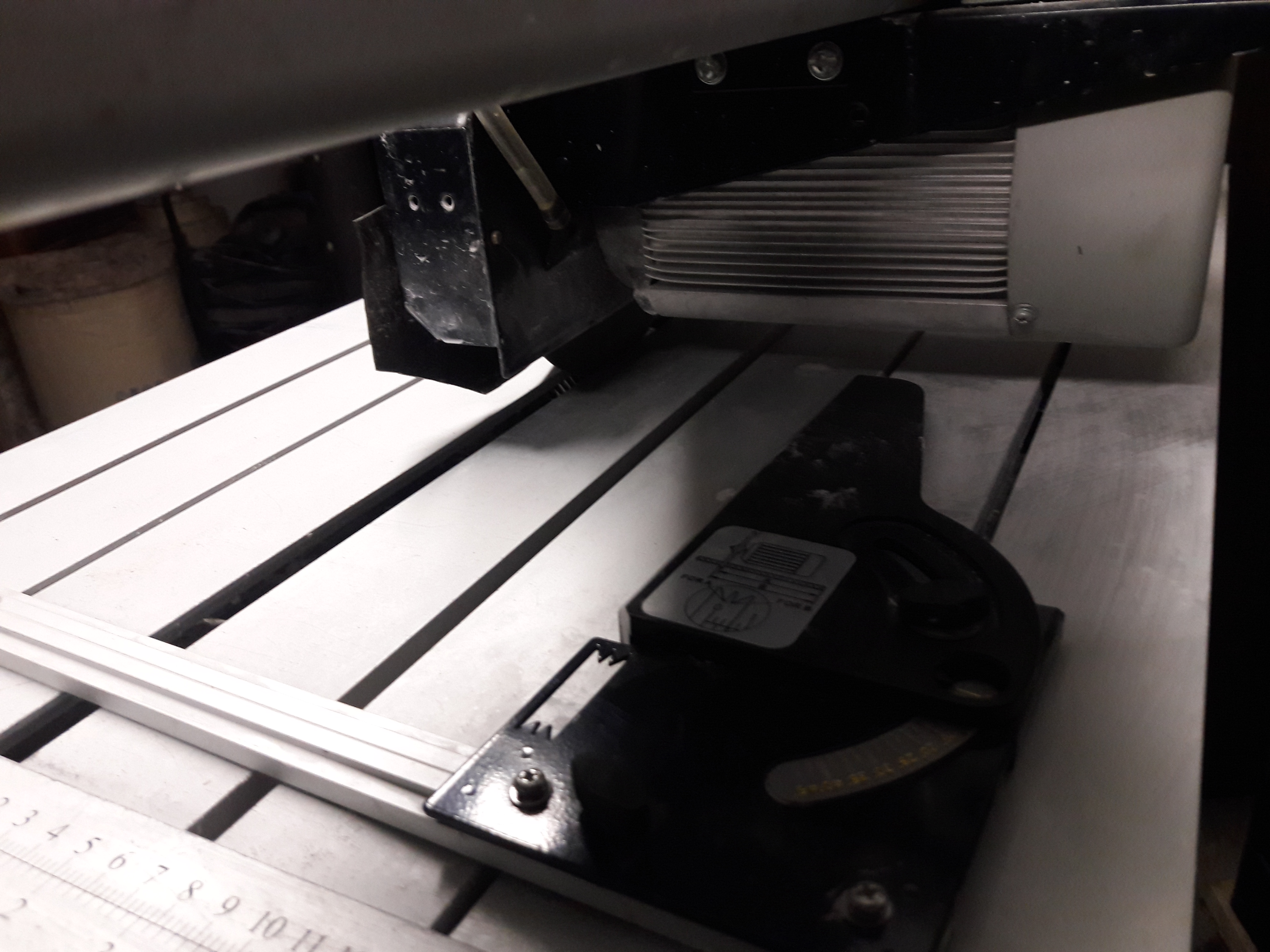

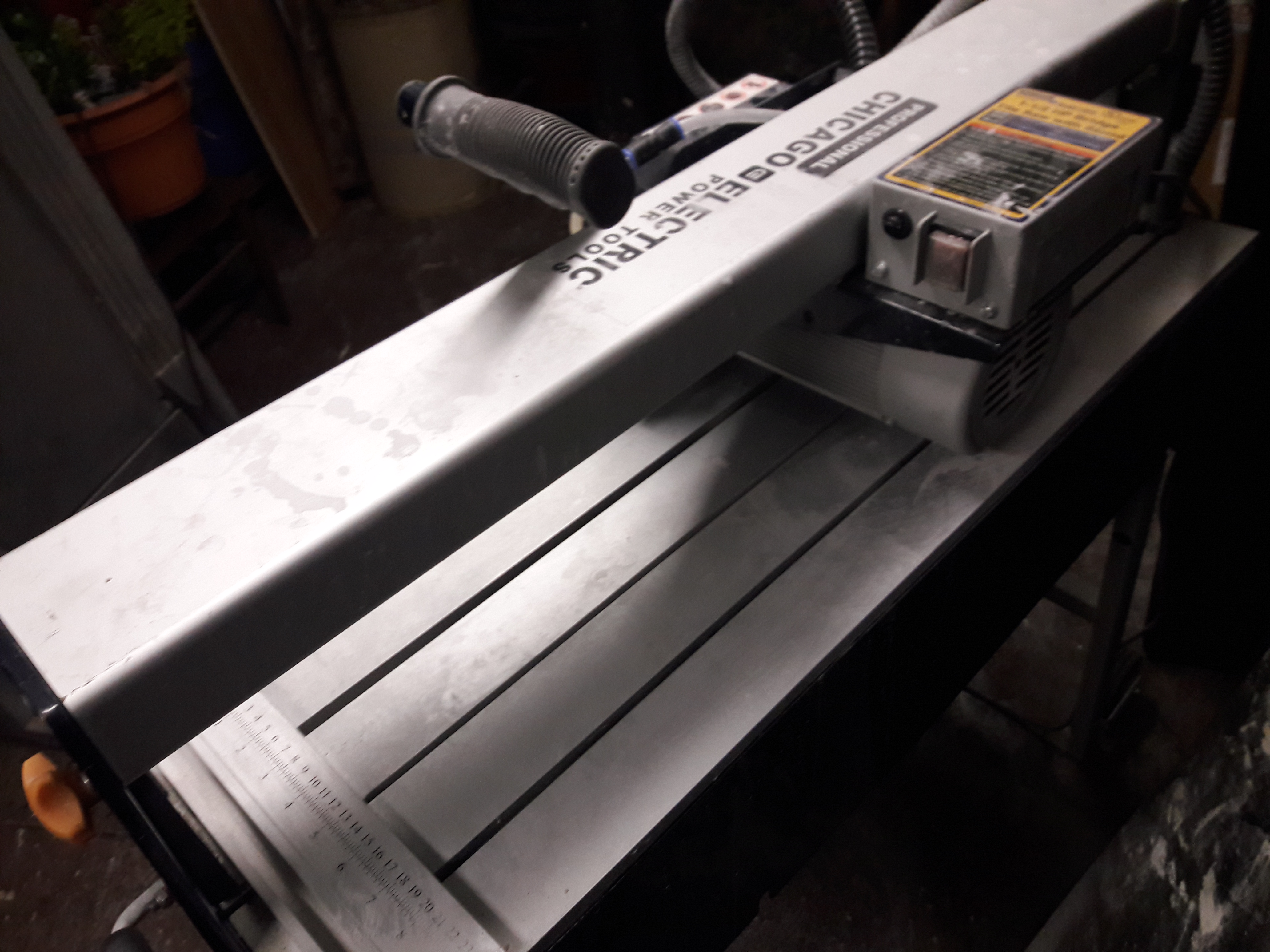

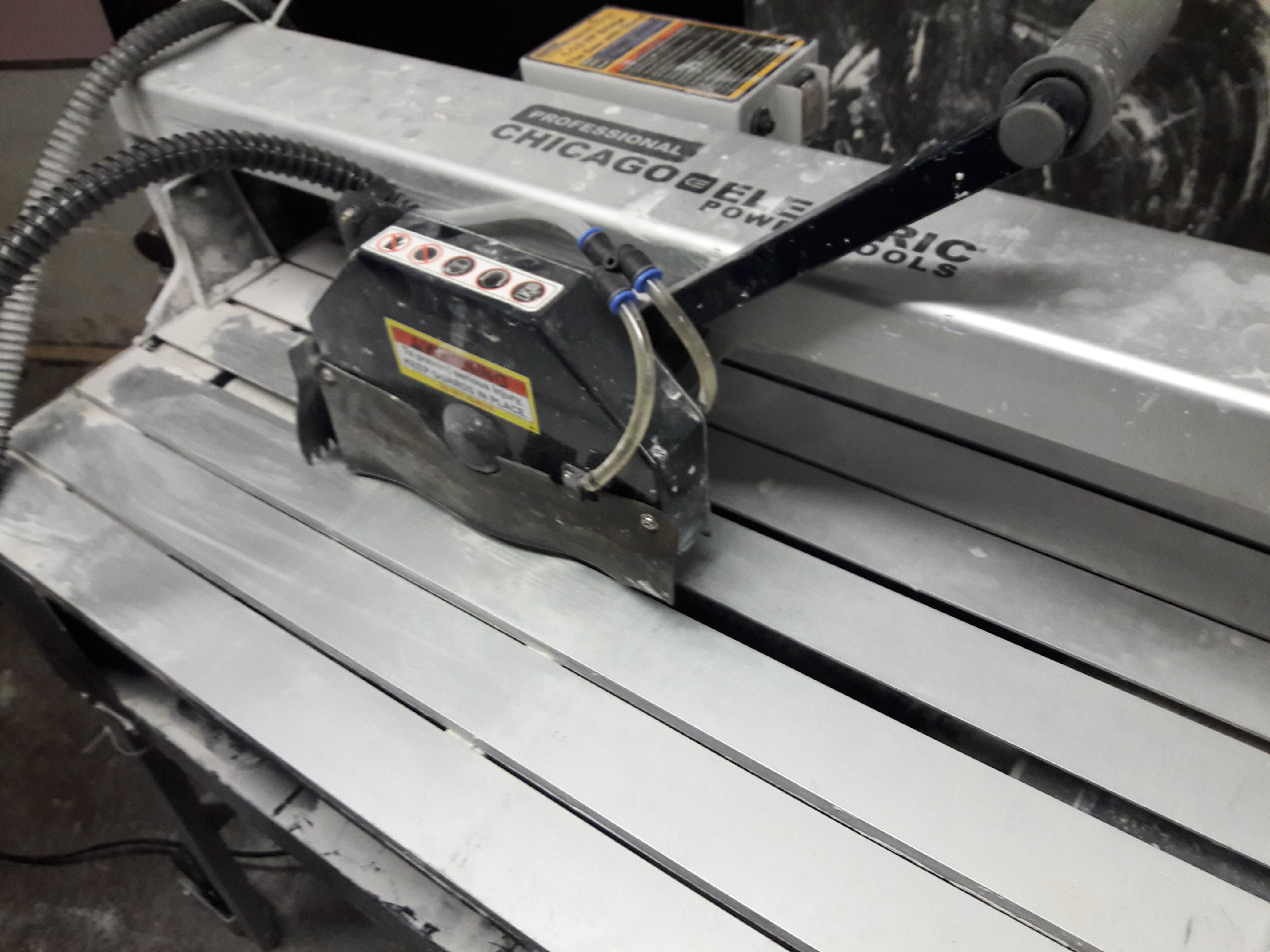

harbor fright beam type 1.5 hp wet 7” saw. #62757.bought last year to do 2nd floor bath, about $250.  tool worked somewhat satisfactory, the legs are cheap shit, 1 got mangled. saw blade is (was) true to beam/fence. water pump was more than adequate, had to attach rubber flaps to minimize over spray. built a visqueen ‘cocoon around the saw work place. placed ‘strategic’ rags on the table to minimize overspray.  sump does drain from bottom, a big plus. miter gage was useless, as it is strictly right handed, and the motor (on the right side of the blade) has only about an inch of clearance over the deck.

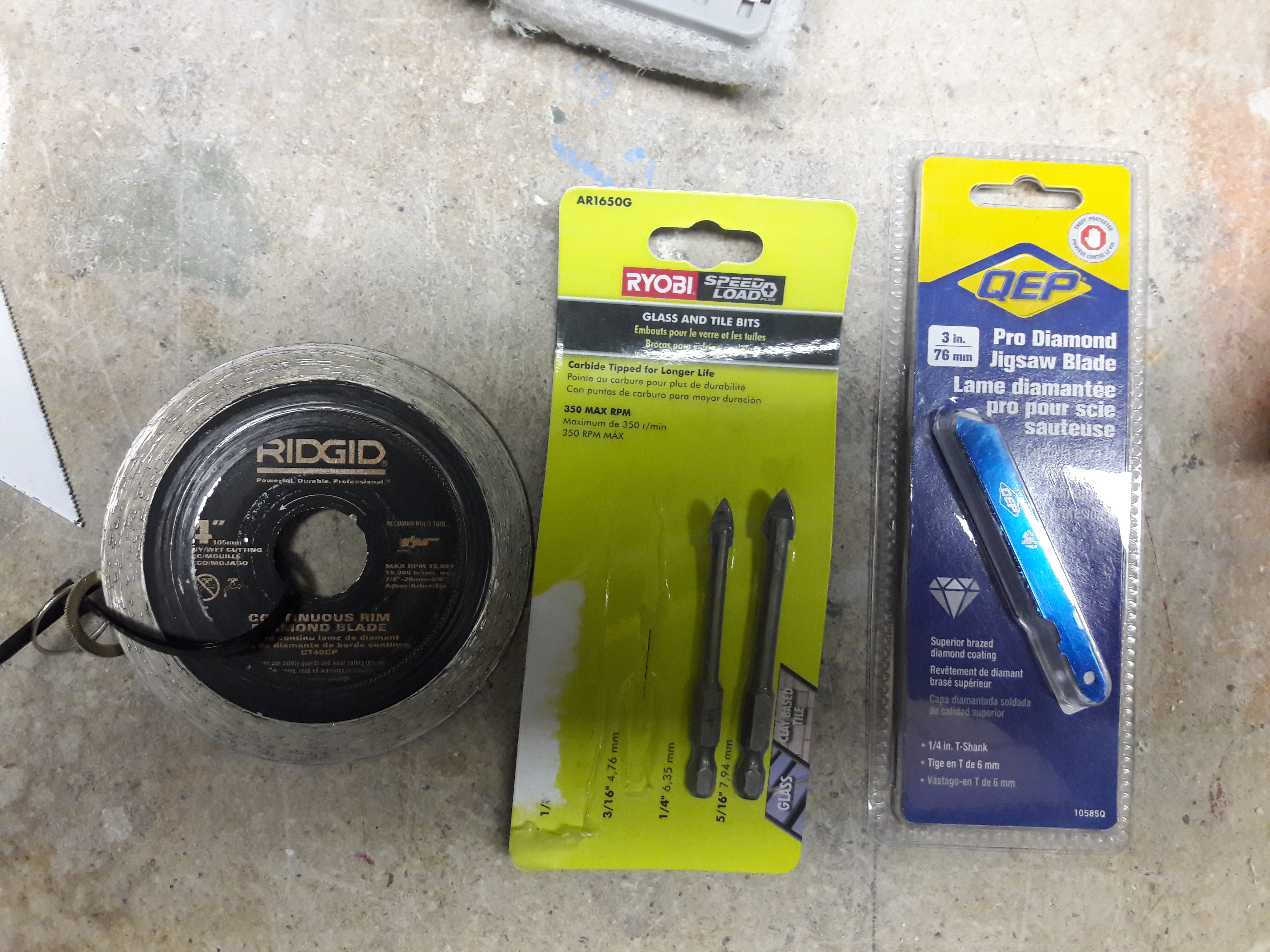

holes drilled in tile, used ryobi glass/tile bits. poor tool, or mis application by me. the no name bit given to me out lasted the mulitple ryobi’s i trashed.
electrical device square holes were cut with a 4” continuous rim ridgid dry blade. worked very well, and did not kick up as much dust as i thought.
