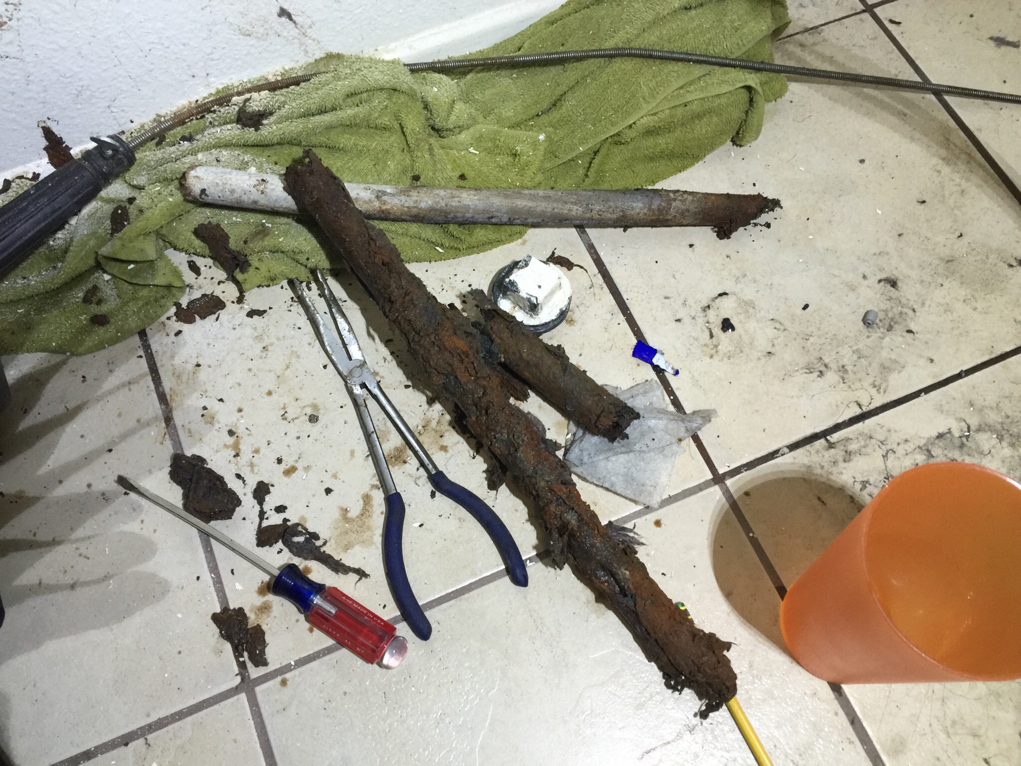

So check this out crew a pipe in a pipe wtf?!?! Not normal right?

Huh wow, almost looks like the material from cast iron pipe that, the inside of those pipes start deteriorating, chunks of rust break off and work their way in certain spots, start backing up the whole system.  Then eventually, the pipe itself just ….. becomes nothing, a shell of its former self
Were you able to pull it out of there? Or break it up and flush it out?
Look at this crap crew I can’t believe I pulled this out of there WTF?!?!
Had that issue at my house luckily I’ve been able to clear the debris
dude jimbo couldn’t believe I pulled out cast iron pipes!?!?!?!
My parents house was built in the fifties and over the years what’s not in the slab we’ve replaced with pvc, couple spots busted bad and a few years ago in the main sewer line my old man and I fished out large chunks of cast like that it’s amazing really
I believe it man, it’s rusting away from the inside out. Don’t mean to cause alarm, but that’s about the worse pipe your house could have, and the worse to deal with fixing. This is one of the main reasons slab homes are a nightmare, if something like this happens, the floor has to be cut up and pipes replaced. But, hopefully there is enough pipe left you can just auger it out.
Sorry to hear you have this problem man, auger it out and hope for the best
