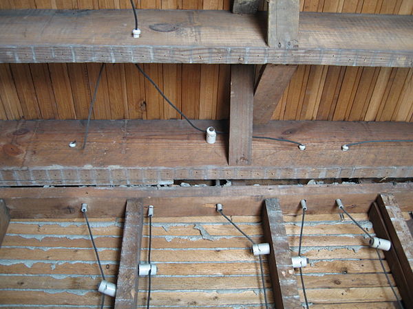

Ah, brings back bad memories. I ran into this when I bought my current home. Was built in the real early 40s, so all the wiring was knob and tube. Without replacing the wiring at the time, but replacing the switch with an x10 3 way module, and NO color wires for reference. What a nightmare to wire, but I eventually got it lol. And as luck would have it, there was only 1- 3way switch from the ground floor the the upstairs hallway. Let me tell you what a apsolute pain in the butt to replace the wire without tearing walls open!Photo from the original forum this is a stock pic just for reference in case there are people out there that don’t know what knob n tube is.
