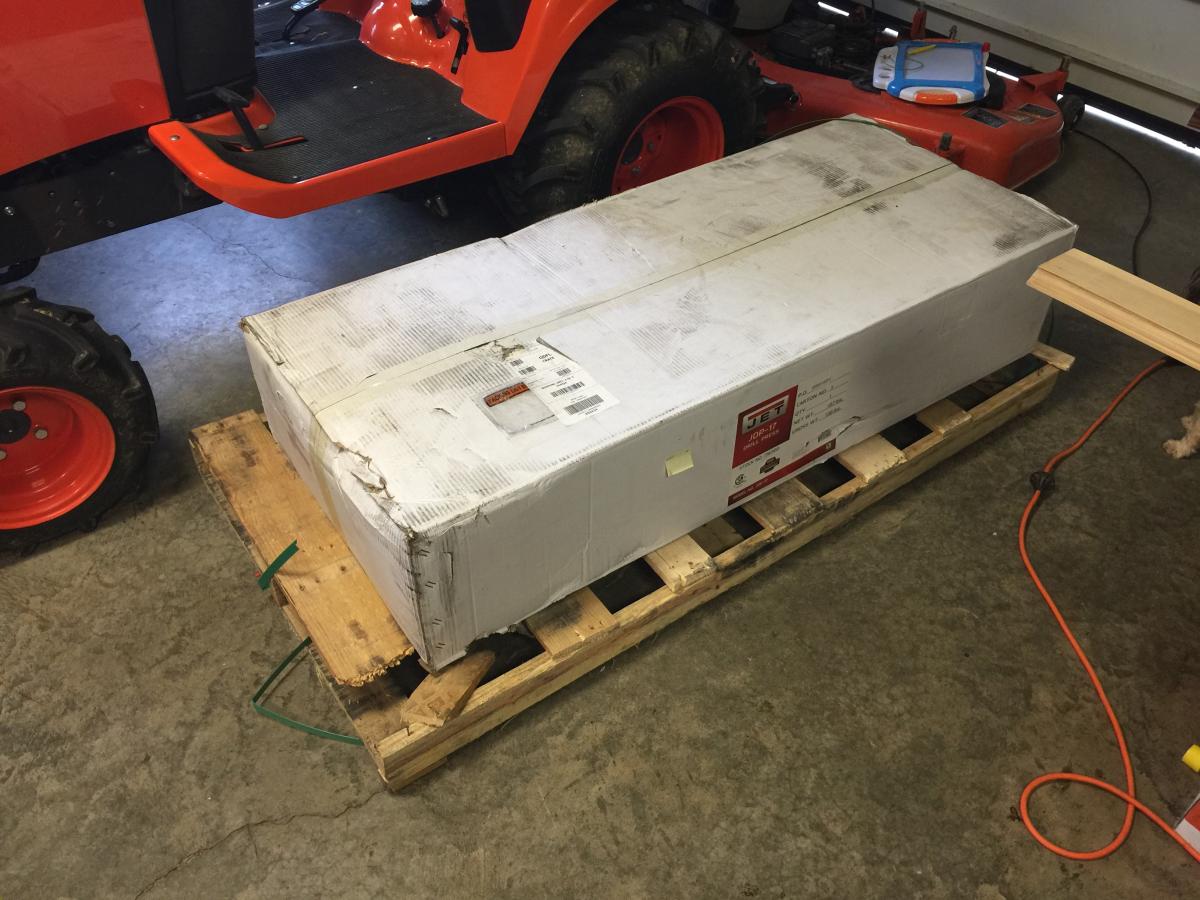

When I arrived back from Jacksonville last night the press was waiting on me. I put it together today and started putting it through its paces.

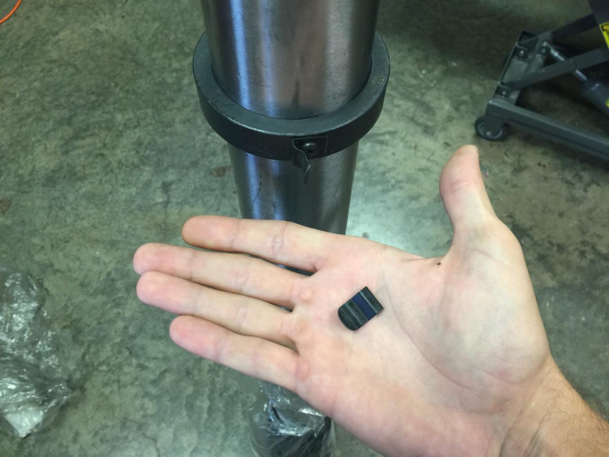

Out of the box the chuck holder was broken. I’m not too concerned with it, but I’ll have them send me a replacement clip.
