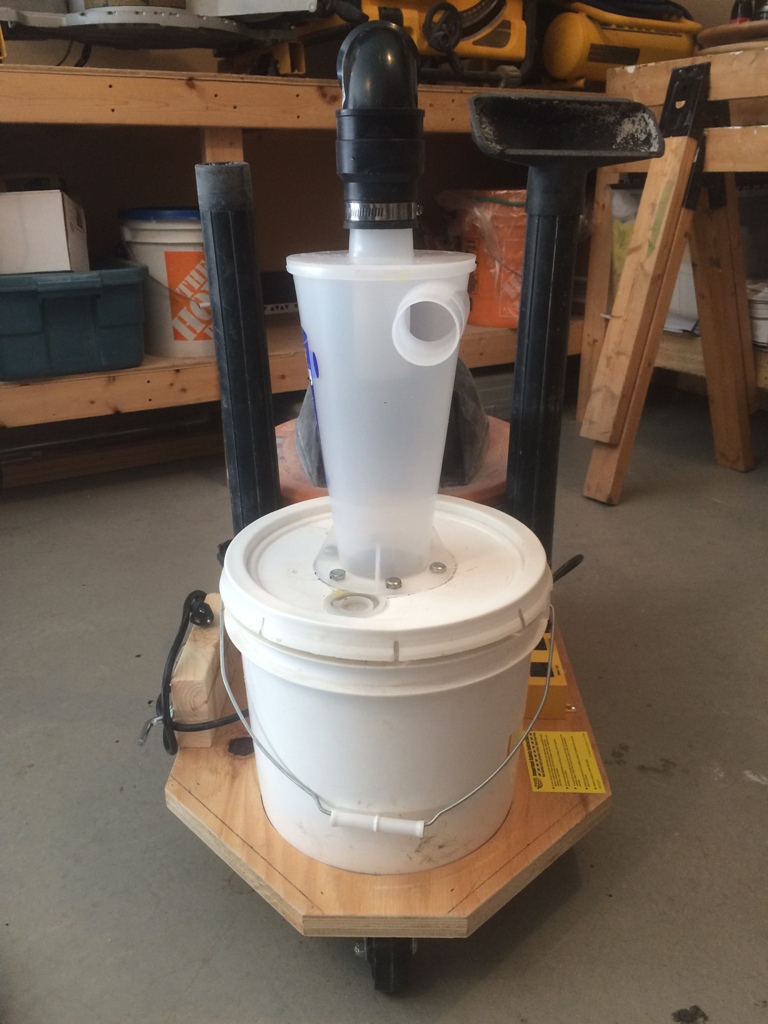

deedub35Member since Mar 2010
I bought a dust deputy and thought it was fantastic. I wanted to come up with something that attached the dust deputy, bucket, and vac together. I had time this weekend and came up with this. I was also able to include my I-vac unit as well.
I built the base out of some scrap 1/2″ ply. The ridgid casters fit a 2″ ABS coupling perfectly. I used 1&1/2″ ABS for the vac tool storage.
I built a removable “J” pipe to attach the vac and dust deputy from 2″ ABS and a couple rubber fittings.
Everything works great. The unit is completely portable and can be carried with one hand by the vac handle. Just need to lengthen the cord a bit on the I-vac.
Exactly one of my requirements as well. The board is a friction/gravity fit into the 2 vac casters via the 2″ ABS couplers. The board simply lifts up to remove. I lift the entire contraption by the vac handle and the board stays put.
