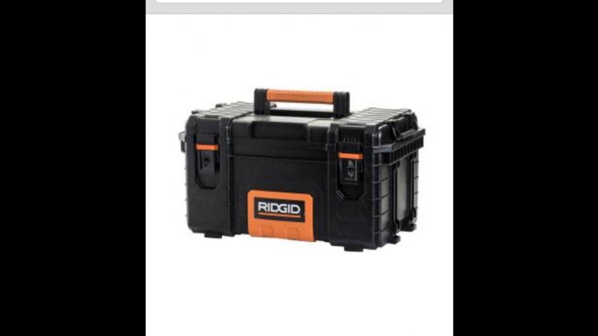

This is the Ridgid case I used. I also have a roller version with a much bigger battery. Everything is indeed modular and because it’s also custom, I’m not worried too much about fit. I can hack, cut, and 3d print what I need to make things work. But if I go the M18 route, I’ll switch over to a Milwaukee case so everything matches. 🙂

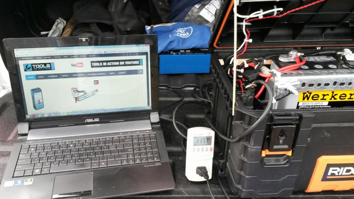

First pic from the field test are in. Looks like the guys are checking on Dan & Eric
that Yeti is insanely overpriced. But in fairness they do make a $400 unit that works very well. I’ll have a build log of this thing, I’m not trying to sell them so I don’t mind sharing what I learn. This first build was quick and dirty. I wanted to get a system up and running and start testing. The next unit will offer more protections and capabilities.
This build was cheap, but mostly because I already had most of the parts. I had the battery, new from one of those solar powered parking ticket booths. Bought a cheap 150Watt solar kit with charge controller. $50 inverter, USB waterproof panel mount chargers were about $20 on Amazon. I had wire and fuses, the Ridgid box, and LED strip lights.
I want to upgrade to a pure sine wave inverter, better charge controller with auto AC charging switch, and the bigger battery. I think a proper inverter will be the bulk of $$$. But being an electrical engineer I’m certain I can build one, still the transformer is $$. I’m co-teaching a microcontroller class and have a few ideas for building a ‘smart’ generator but I don’t want to get ahead of myself. The goal is to build a cheap unit that’s easy to use.
