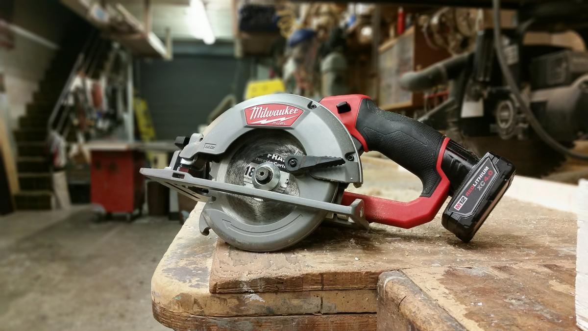

Here’s the little M12 beast i’ve been using for little over a week:
I refused to invest in either a cordless circ saw or grinder for the longest time. They simply didn’t have the power or runtime to be legitimate options IMO. Last Christmas I got the 2731 and 2780 grinder and holy shit was I surprised!
The 2731 goes through 2x’s and 3/4″ ply like it’s no big deal at all. I’d used several cordless circ saws before and owned a couple as well, but the 2731 was really next level. I’d strongly suggest upgrading to it if it’s an option for you
