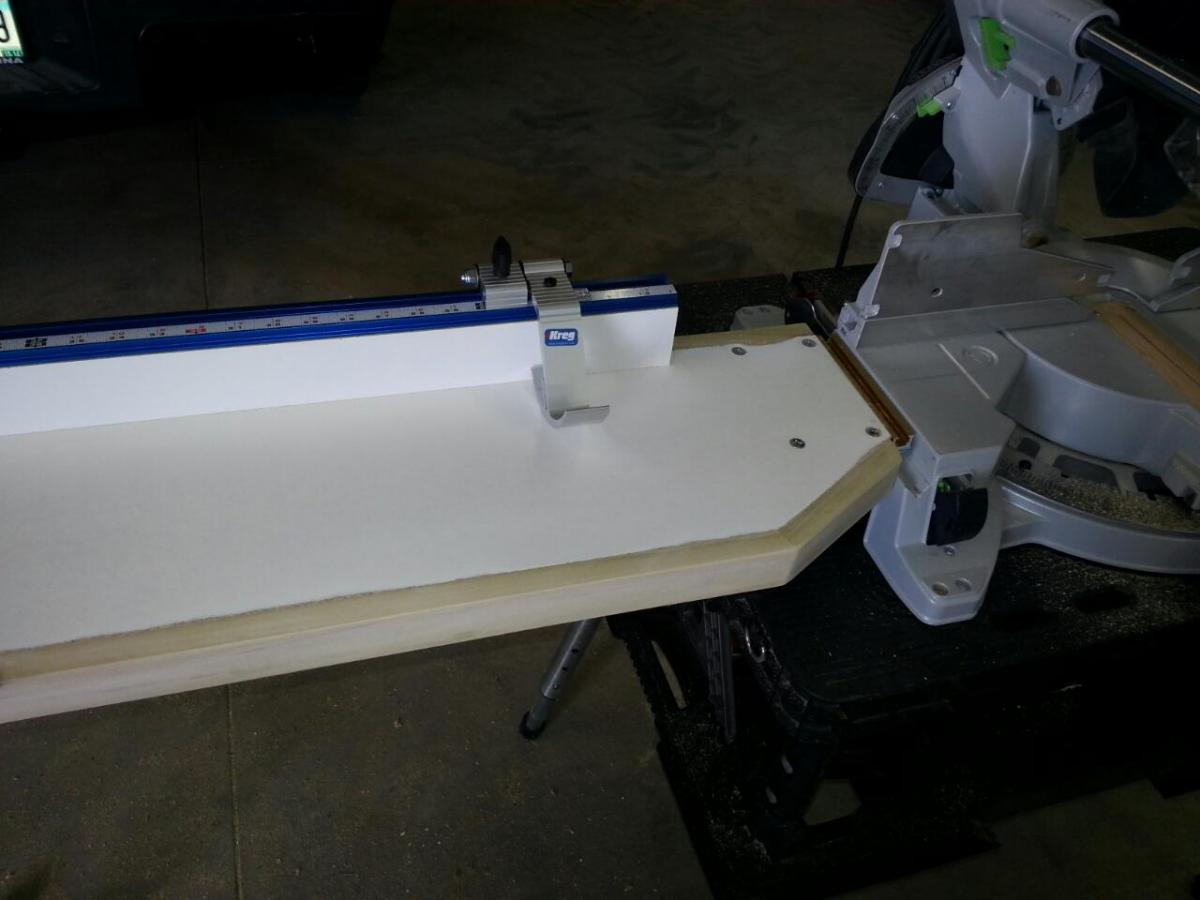

Here is my setup. ChrisK1970 wanted to see it. I use a Keter work table, Multiblades adapter, Kreg fence, and custom made wings. Also made a custom crown jig for it. I made the jig so I can store it under the wings so I always have it.
One more picture showing the entire setup. It is multiple pieces to bring along to the job, but it is solid. I like the wood wings over aluminum for some reason. I looked at the UG wings and the BestFence from FastCap and decided on this direction. I have been very happy with it.

We have a Ridgid SVU stand. I wanted the wings for full work support regardless of the length of material. One thing that would drive me nuts is when cutting smaller pieces, if the piece wasn’t long enough to get to the roller it would fall down after you cut it. The wings give excellent support for the entire piece. Also it gives a great work sufrace for coping trim too. I wouldn’t lose the wings regardless of what stand I used.

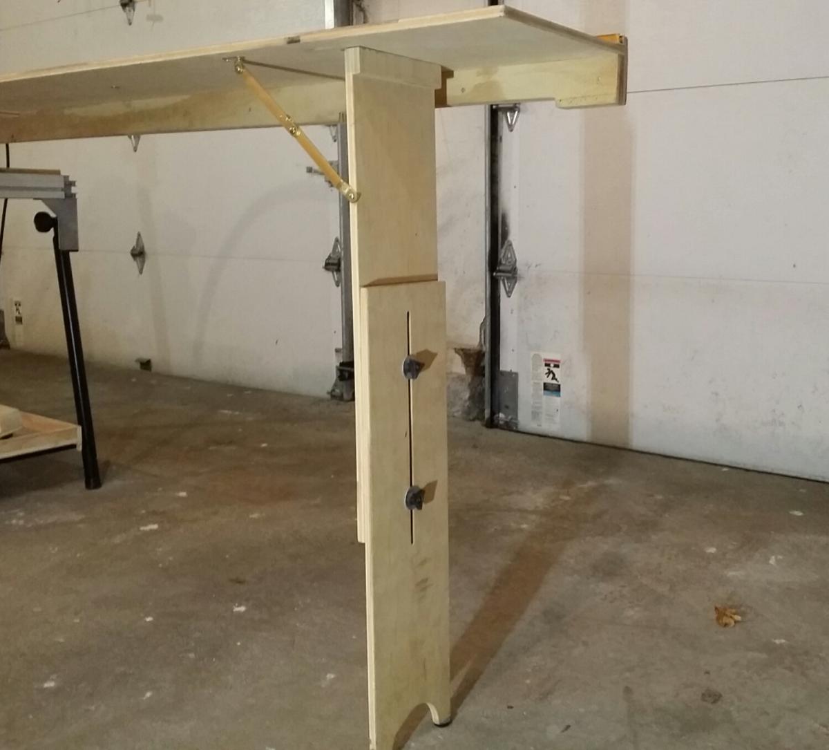

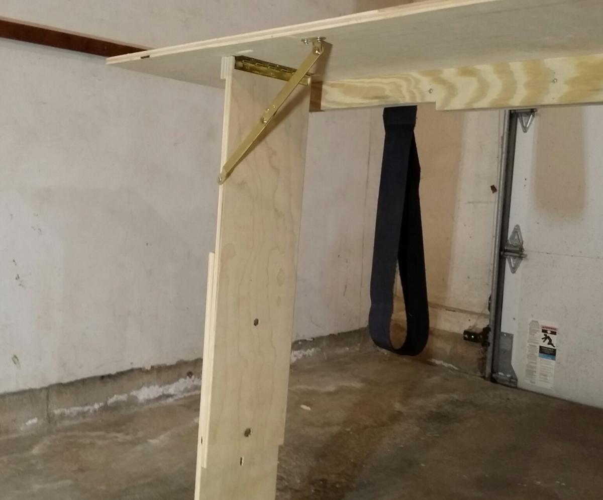

I like the leg setup you did!! I may have to copy that somehow. It is the one thing I don’t like about my setup is I use roller stands for the support. It is just one more thing to bring and they are bulky.

Hyena john, in the adjustable legs to you put in a t track or is it wood on wood?
look like wood to wood with a washer and wing nut to tighten it up
Madman nailed it… wood on wood. The friction between the plywood when tightened with the 2 knobs is rock solid. I’ve never had it slip

Copy away man!! If you want more specifics let me know
