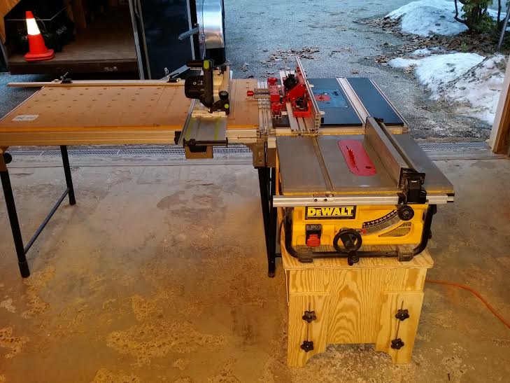

here is a few pics of my setup.  i work onsite so i have to be able to break everything down and store/transport it in my trailer.  this breaks apart into 3 pieces and then those 3 pieces can fold up or disassemble even further.
when using the router i remove the table saw fence and drop the blade. i do the same to the router table when using the table saw or track saw.
i dont always set this whole thing up, it needs to make sense for the job   the only thing that cant be used by itself is the table saw stand, but if im only making a few cuts and have no need for the router table i just setup the table saw on the ground or horses
since these pictures i have made a few small tewaks but nothing major.. made a shelf for under the router table, swapped the ridgid vac for a festool Midi are the main 2

Yours looks like a smart set up too man.
Specifically for job sites.

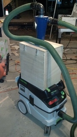

You use a cyclone? I can see under your table

Thanks for that clarification ner, I like your setup. Is that an actual Festool router table or was that something u put together from one of the mft tables.

yup, its the metal dust deputy mounted to a custom box that works with my systainers..    oneida sells something exactly like this (ultimate dust deputy) but i already owned the cyclone part so i just made the box
http://www.oneida-air.com/inventoryD.asp?item_no=AXD001002&CatId={2C6BB449-99F9-4CB9-BC27-CAF1BB570002}
i really only break it out for the router table/table saw setup since they make a lot of shavings/dust and that fills the bags on my vacs very quick.. i can fill this box before there is a handful of dust in the vac!
i also use it if im doing a lot of drywall sanding so the fine dust doesn’t clog the vac filter or bag.
Ya those cyclones are a smart idea. But i would never pay that kinda money for it. I bought all the parts to build my own clear cyclone dust separator for 4″ pipes. I’ll start a thread for it as soon as i start the project
