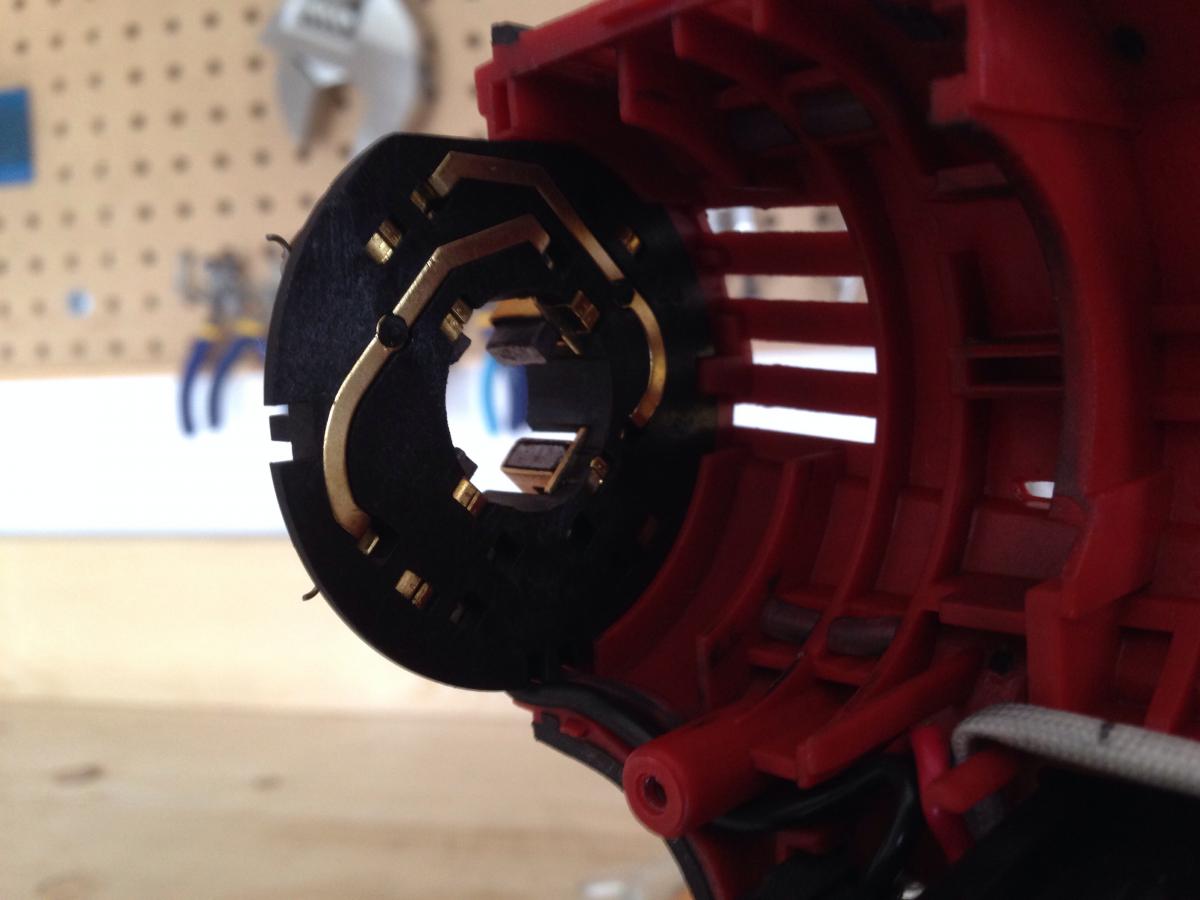

When I popped the back cover off I quickly noticed that one of the brush card springs was unseated leaving one of the brushes not in contact with the motor. I fixed that and thought “can it really be that easy?” The answer is no, it can’t. On the bright side, I have plenty of brush life left.

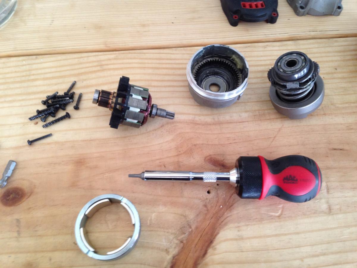

Looking over everything I couldn’t find any loose of broken connections, or any other visible damage, which left me scratching my head. Needless to say I started complete disassembly.

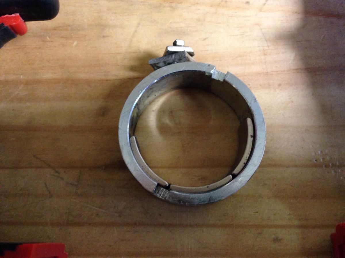

When I took the motor out I believe I discovered the problem. One of the service field magnets was broken and left several pieces scattered inside. I removed the service field and cleaned out all the pieces.

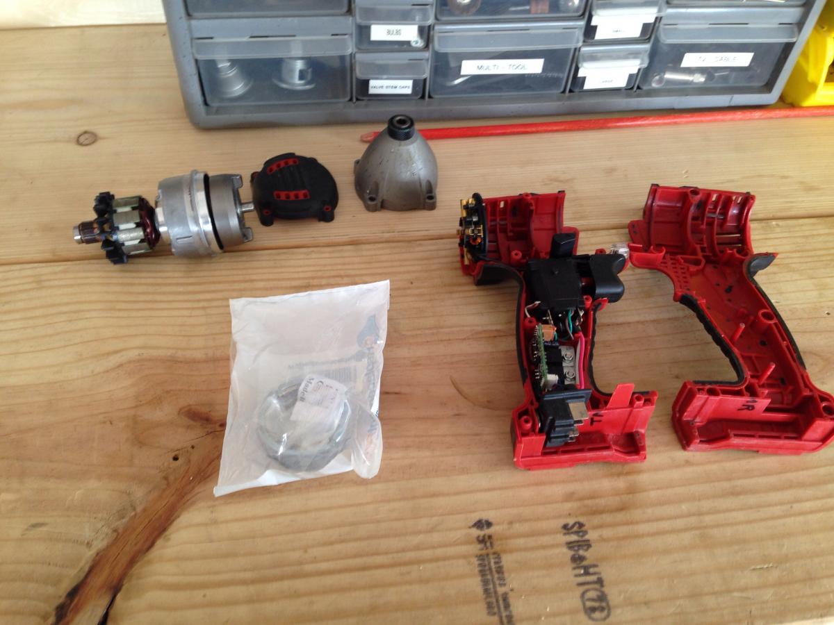

I went searching online, and while I couldn’t find just the magnet, I did find the whole service field assembly on eReplacement parts in stock for $16.99. I ordered it promptly. We’ll see how it goes. I’ll either have an old beater impact for shitty jobs, or be out $17.

The part arrived today and as advertised, it was an OEM part.

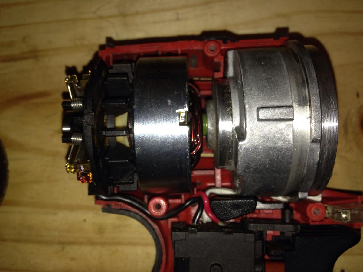

The parts in play are relatively simple. The top end of the gun consist of 5 components. The brush card is the only wired component and it is not nessecery to remove it.
The service field magnets are very strong. It just slides over the motor, but as I’d find out later, it tends to try to pull itself back against the fan.
Once I got everything in and pulled the trigger, it sounded like a North Korean Helicopter trying to take off. The magnet was so strong it was pulling itself out of position before I could get the other part of the handle on. After my second failure, I was ready to toss it, but I gave it another shot and finally managed to get it right the 3rd time.
