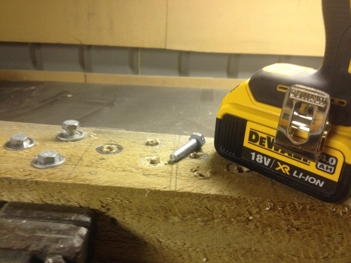

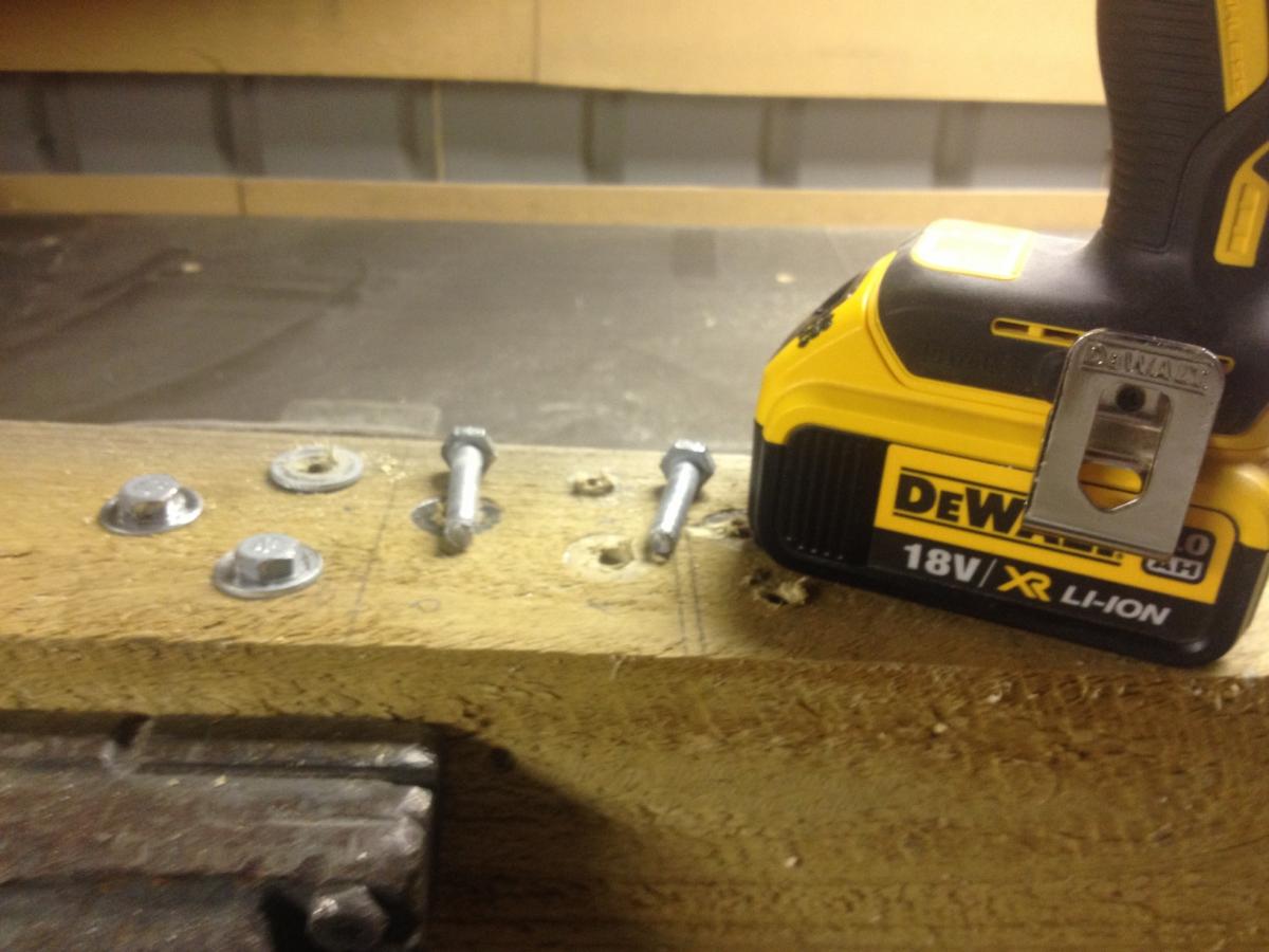

Being a skeptic of this, I decided to do some testing myself. I have a new respect for anyone who makes a decent video with a fairly scientific approach to testing, it is much harder than it looks. I just took some photos. Here’s a couple of setup photos:

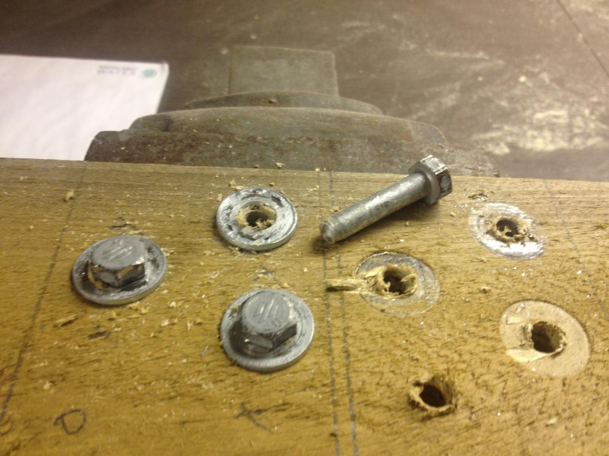

Everything was done in 4×4 rough cut treated pine (very soft). Screws were timed going in, not backing out. The 25mm auger bit tests were in and out. The batteries were always on 2 or 3 bars charge.

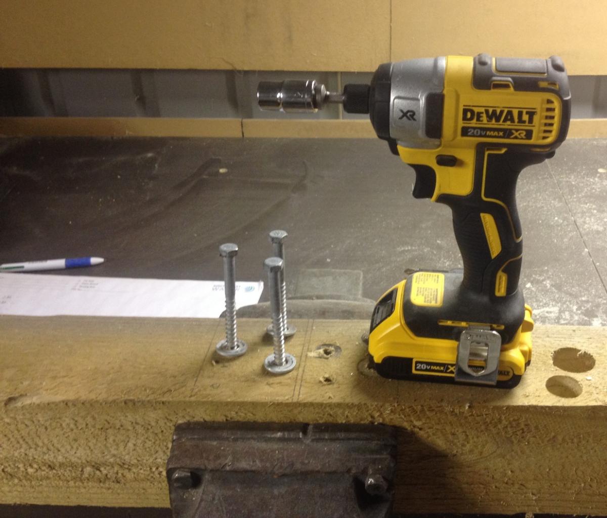

DCF886 Impact Driver driving 3 No. 8mm x 90mm lag screws. I did this test twice (one at the end of other tests since it was so different). Both batteries actually sheared the third screw at the same depth! Very uncanny. It didn’t happen in the second run, which took much longer on the 2.0Ah for some reason…
2.0Ah – 59.7 secs & 99 secs
4.0Ah – 46.7 secs & 49 secs

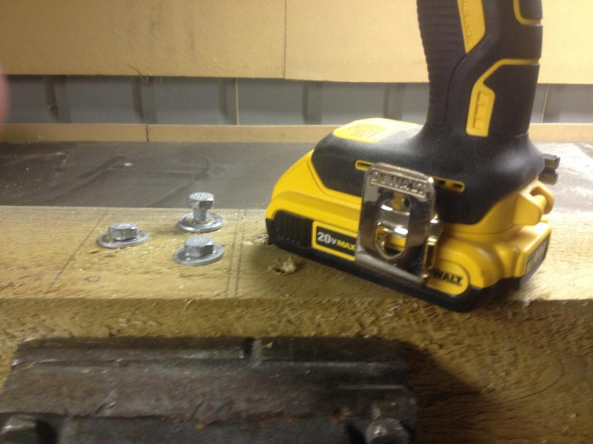

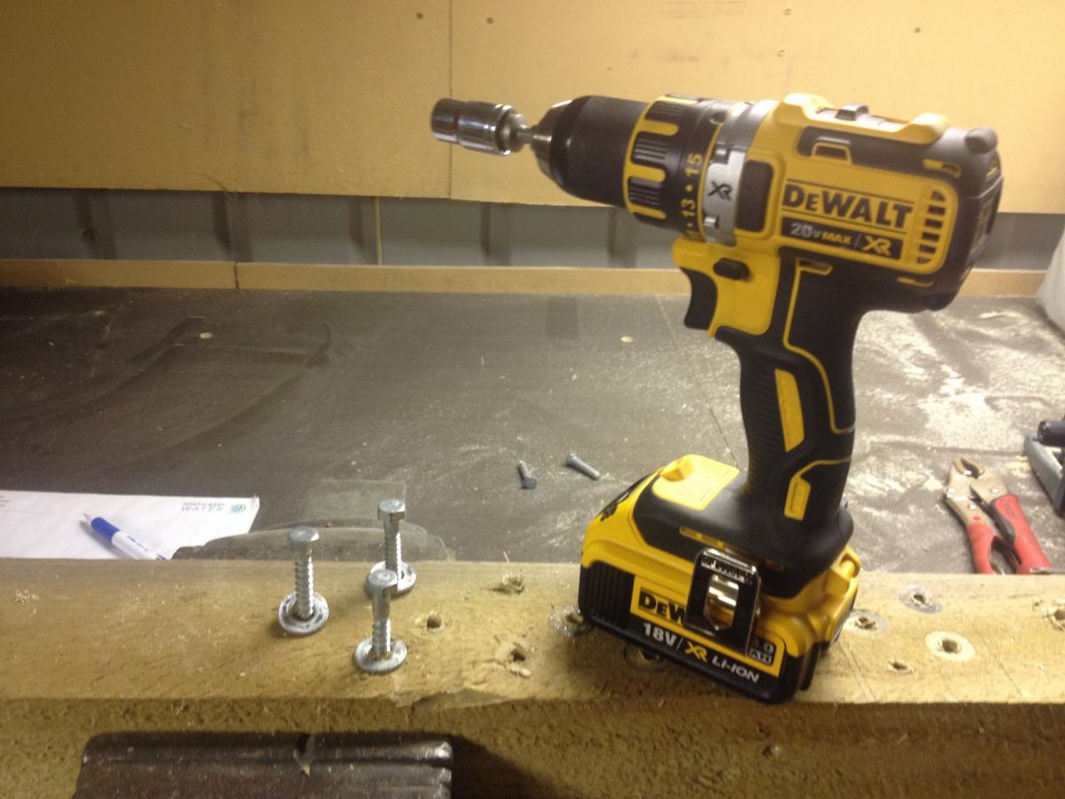

DCD790 Compact Drill driving 3 No. 8mm x 50mm lag screws. The drill cut out every time as the head of the lag hit the washer.
2.0 Ah – 15.0 secs
4.0Ah – 15.3 secs

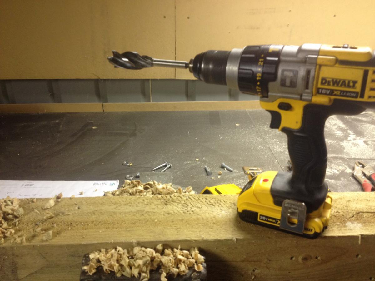

DCD985 Premium Drill drilling 4 No. Holes with 25mm auger bit. On both batteries I had to switch from 2nd gear to 1st gear on the third hole.
2.0Ah – 43.4 secs
4.0Ah – 44.5 secs
The results surprised me immensely! There was a clear power difference in the hand when using the impact driver with 4Ah batteries, but no difference with the drills (as reflected in the results). All scenarios were a big test for the tools. I would have guessed that the impact would be the least affected by battery size, but the results clearly disagreed.
The testing was not perfect, but I am definitely convinced of using larger batteries in an impact driver for large screws. It would be harder to measure, but an angle grinder and/or circular saw test would be interesting.

Ha.. thats good to know. I would of thought the same. Didnt expect impact driver would give more clear power with the big pack. I would do the test on ciruclar saw. But it was missing for over amonth now. Might have to buy a used one somewhere soon. Good post tho.

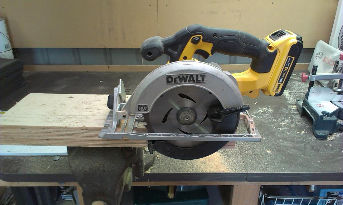

OK, so I did a bit of a circular saw test today. I used an LVL offcut, 460mm long and 42mm deep, three runs with each battery. Each battery was on 3 bars charge.
Obviously there’s a bit of difficulty with this one as user error plays a part (cutting straighter is easier on the saw), and i decide how hard to push the saw. I tried to push the saw to cut the length as fast as possible, which sometimes meant letting off the pressure to let the blade speed up again. I stopped the saw once on each battery.
4.0ah test – 78 secs
2.0ah test – 69 secs
Surprised again! Its true the 2.0ah batts are newer, but the 4.0ah’s would still have much more capacity. Are you surprised?

Nice update Dwain.
So, when using 2.0ah pack finished off and cut faster than the 4.0ah pack on the circular saw! Thats surprised me. Did you notice the difference on the battery useage somehow in the test?
dwainMember since Aug 2013
nah, couldn’t notice the difference really.

Now I’m confused
Something isn’t right at all here. Could you try the test again?
the only things that could possibly be affecting the result are user error (which wouldn’t be much), that i got the 4.0ah’s second hand, or that the 2.0ah are US sourced, where the 4.0ah are Aus.
I could do it again, but I believe Dan & Eric may shed some light on it shortly 🙂

Hum. Thats strange the batteries wasn’t a noticeable difference on the useage. My thought is since the circular saw draw higher amp power then the drill or impact driver. I assumed the the 2.0ah pack will be more noticeable decrease on the battery juice than the 4.0ah. I have heard using the 1.5ah pack on the circular saw would drain the pack way faster than the 3.0ah pack. For the fact I’m thinking it could because of the circuit board in the pack is pushing more power using higher amp to spin the motor faster than and create higher speed. I dont know it could cause the small pack cut faster on speed thou.

I would assume that a circular saw would be a conatant draw, so that blade rpm wouldn’t be affected.
I’m not hacking on your saw test, but there is a lot to consider with a saw. In order for a truely accurate test you would need a new blade for each test to account for dulling. Then there’s density of material, and a constant pushing speed/pressure.
yeah there is a lot to consider. Re: the saw test, it was only 1.2m of cutting each test, and on a used (but reasonably new) blade, i don’t think that would be significant. In any case, I did the 2ah cuts second. LVLs would be fairly consistent in density, but the user push is the hard to control aspect…
