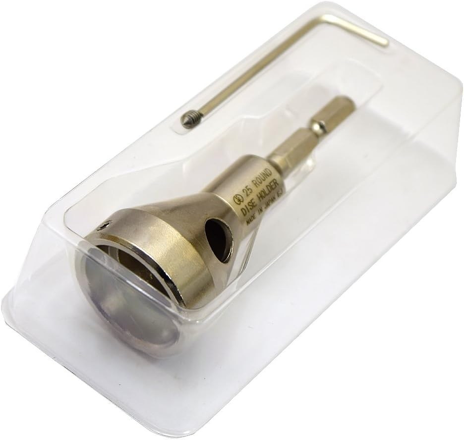

Japanese brand Onishi has made a hex shank die holder
I was digging amazon Japan and I found Japanese brand Onishi making a lot of japanese made tool accessories and one is this amazing tool. You will need to grind it 4-5mm to shorten it to make it compatible with the western impact drivers. Made in Japan

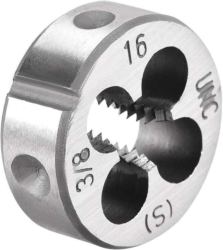

The purpose is to use the dies with a power tool, specifically with a impact driver or a drill with a hex shank adapter or chuck and not manually. Basically you attach the dies in this die holder and secure it with the grub screw and use it with impact driver to make threads on a metal bar.

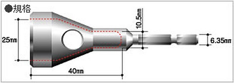

As you can see in the drawing the external diameter of the dies should be 25mm.
Also the maximum diameter of the bars to be threaded can be 10.5mm with the maximum length of 40mm.

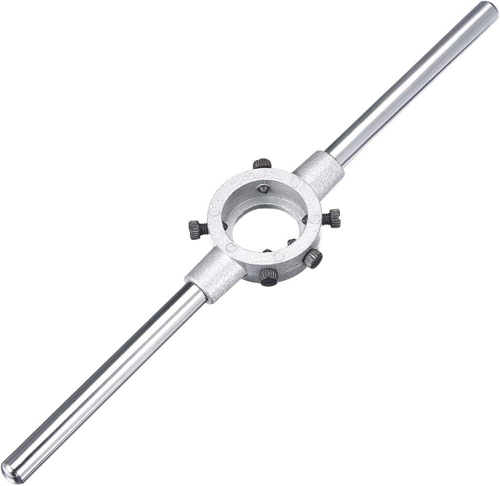

My preference has always been by hand, w/ a back and forth motion.
