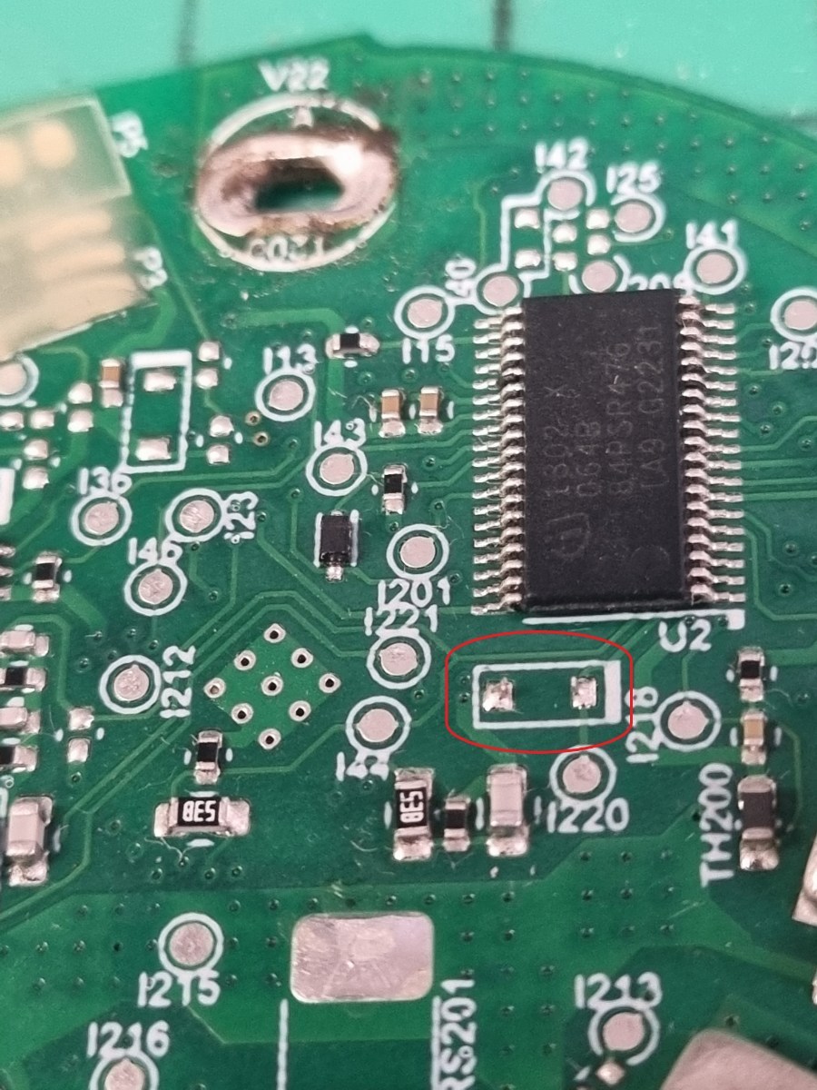

If you pull the trigger and only get a tiny ‘bump’ from the motor, that’s a pretty classic symptom of the motor driver board being bad. That can also show up as nothing happening when pulling the trigger.
I’d pretty much guarantee you it has some bad MOSFETs on the thing now, as I just tore one of those down here looking for that exact problem. It’ll probably come as no surprise that none of that stuff is even remotely easy to replace. Even if you can get parts, you’d have to replace the entire field/driver assembly of the motor to avoild any soldering or real PITA PCB de-potting, unless you’re far enough off your meds and rocker to replace the FETs like I’ll be doing to this one.
RDCMember since Dec 2019
OK, replaced the FETs (only the one damaged pair as the other 2 pair were still good) and replaced the 2 Capacitors that are missing in the last posts image, and she was still a dead duck. So I dug a little deeper and found an open Resistor in there as well, one of the 53B, 3.48k. Replaced that and she took right off. After I pull the PCB back off one last time to clean it up and recoat it then she’ll be ready to wack some more weeds.

yakimonMember since Jun 2025
Does anyone know the rating or marking of the missing diode?
