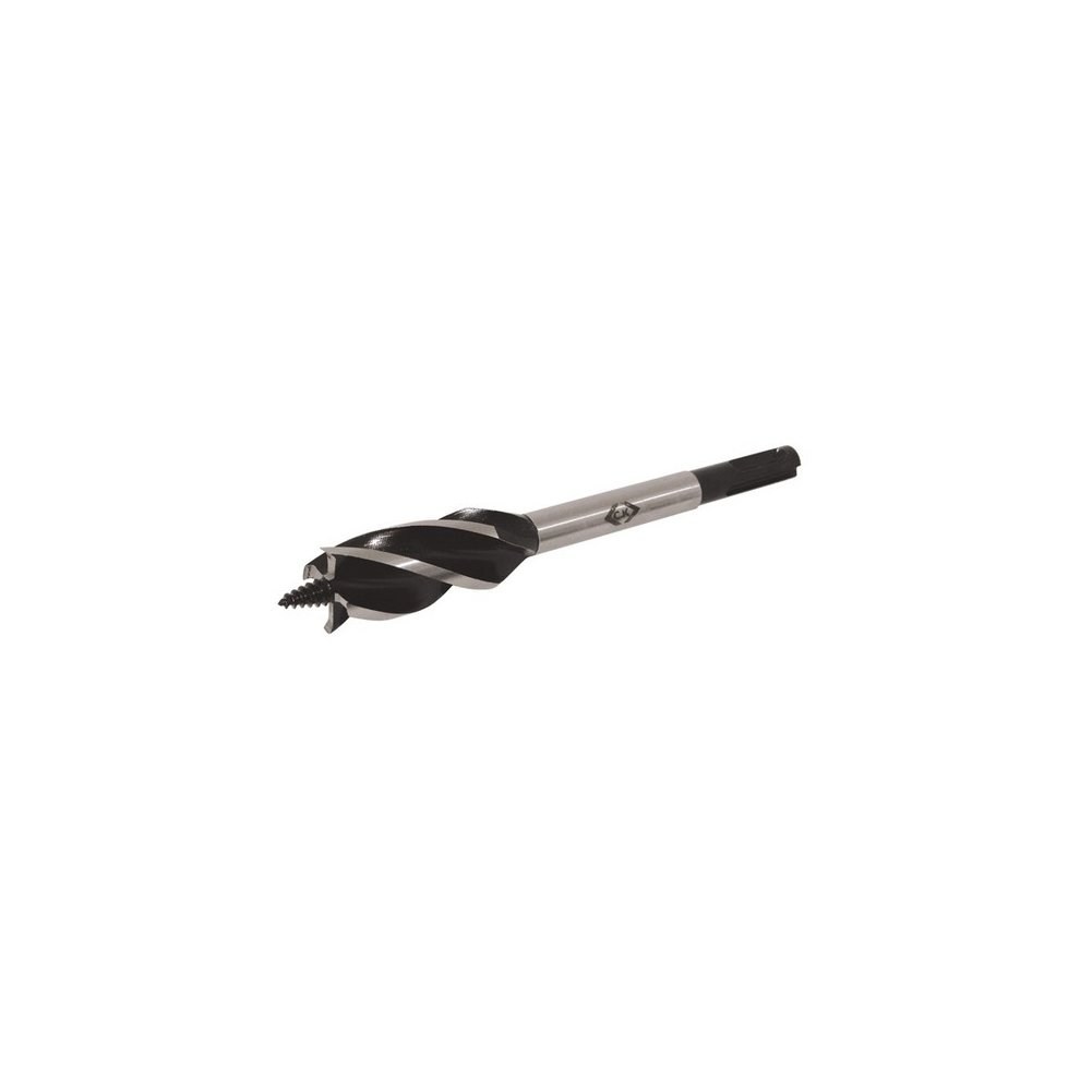

There are some SDS+ Auger wood drill bits from a German brand called CK in 6 Metric sizes only as much as I remember. 12mm, 16mm… SDS+ shank brad point?! First time here I found out about Makita ones, I would not use SDS+ brad point drill bits in these small sizes, they might break easily. I should also say CK is a German brand but their Auger bits seems to be made in Far East (China/Taiwan most probably) Currently none of the well known brands do make their Auger drill bits in Western World, Only quality but expensive Auger drill bits are made by Star-M (Known as WoodOwl in USA and kwb in Europe) made in Japan. Also Fisch makes some in Austria. What I said here is about 1/4″ E6.3 hex shank Auger drill bits, if you go for round shank auger drill bits you can find German made FAMAG Auger drill bits but very expensive.
These Makita SDS+ brad point drill bits are not made of one piece of metal, they are plugged.

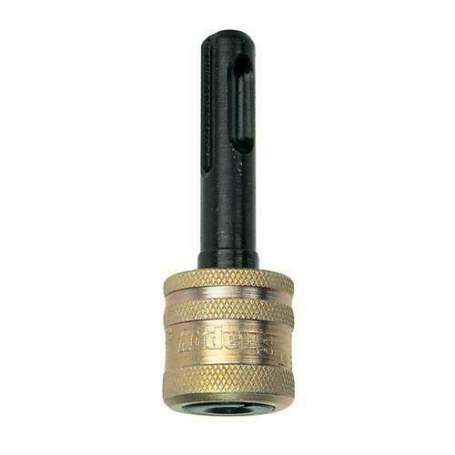

Also you do not need to buy any drill bit with SDS+ shank, You can buy any type of drill bit with 1/4″ hex shank to use with impact drivers and buy this adapter for SDS+ from Snappy

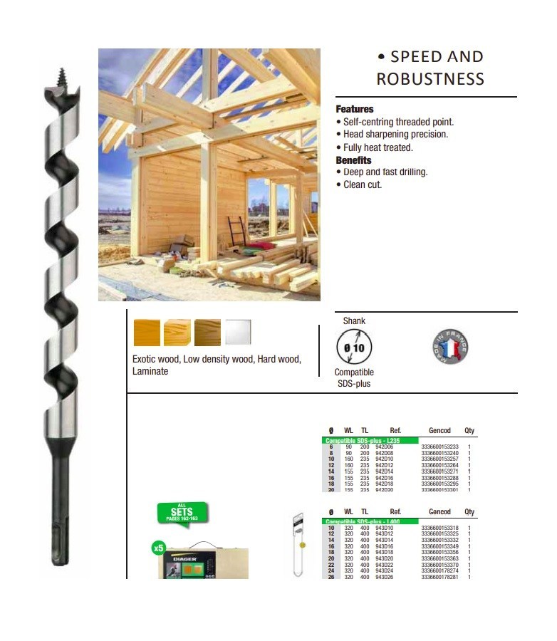

A brand called Diager makes SDS+ Auger drill bits made in France.

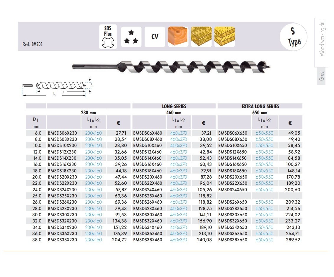

Another brand called “Blue Master” has a good range of SDS+ auger drill bits.
