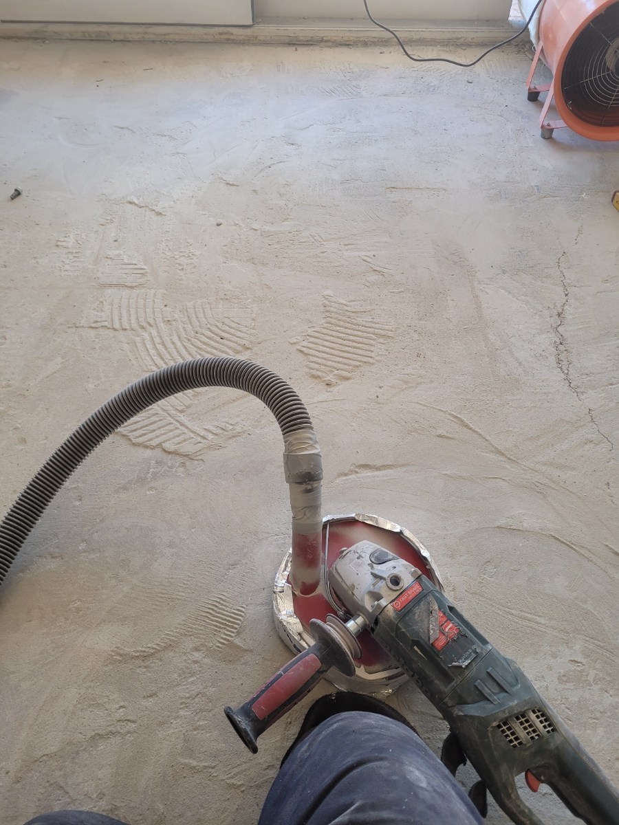

I used this attached to my 9″ grinder to grind approx 25sqm of concrete after removing tiles prior to pouring self levelling. With the fleece bags, it couldn’t keep up with the dust (granted it is only rated for 5″ tools) and the alarm would not stop. I removed the fleece bags and it was like a different vacuum, the suction power increased enormously. I would guess that the dust clogs the fleece bag almost instantly. No more alarm and the tool kept up quite well with the dust as I ground. I was amazed how well the filter cleaning worked. Some photos below.
If you ever have issues with the audible alarm just remove the bags and it will solve your problem.
