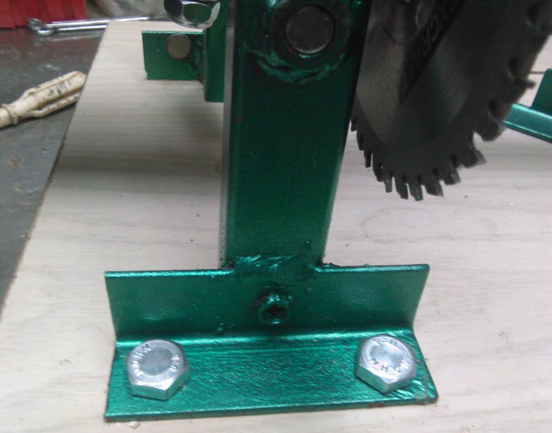

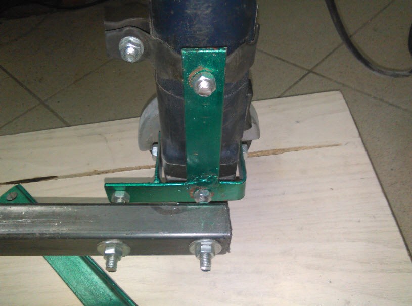

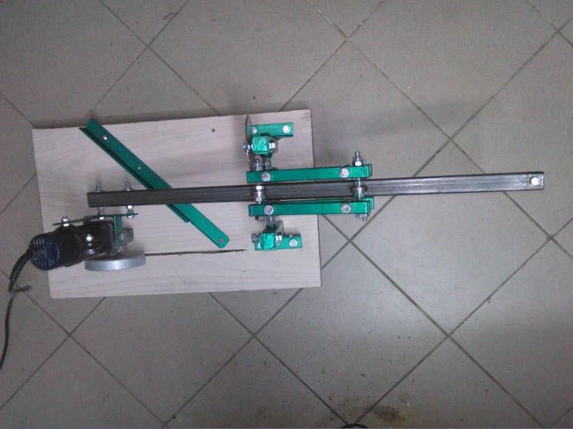

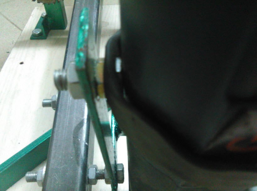

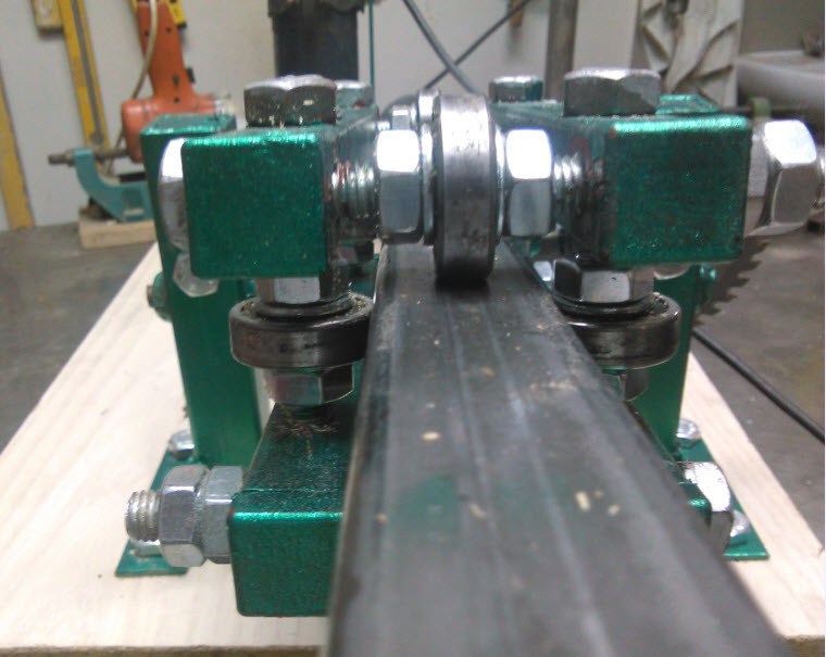

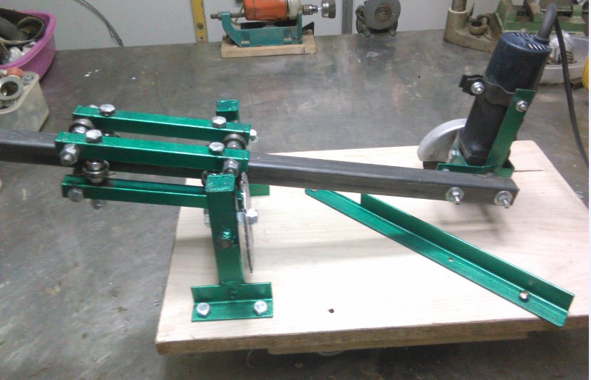

You can watch how to make an easy accessory for your angle grinder. Using the right disc you can easily cut every kind of materials like wood , metal and stone. You can cut for 35 cm length and less than 3 cm thick. You can adjust the angle you want to cut from 0 to 90 deg.You can see the construction and the use here:
