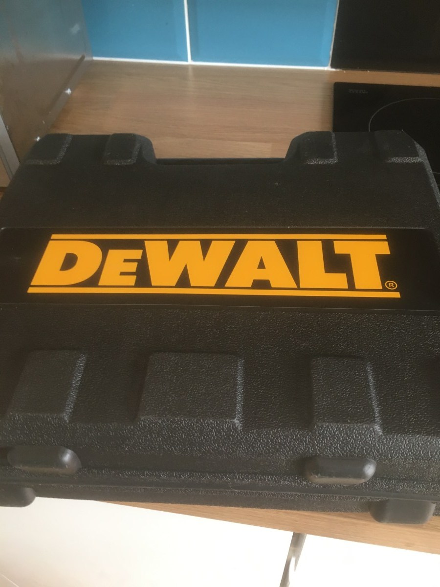

do you know if you can add photos on here, ill post some?
bigbadbobMember since Mar 2021
hi,
found how to add photos
RDCMember since Dec 2019
If those are 24v 5Ah packs, I’ll eat them.
That all looks sketchy to me. There are only 3 terminals on the Charger, the Li-Ion chargers have 8 terminals. That whole thing looks like some 12v NiCad setup to me.
ToolBaneMember since Jan 2018
They look like fakes

Because they are fake. And a bad fake at that.
