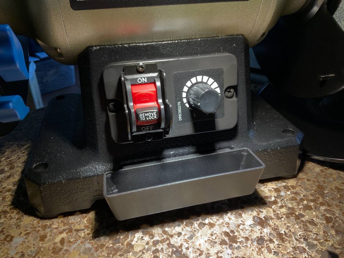

– 5A, 120V (maybe convertible to 240V?)
– wheel measures 7 25/32″, arbor is right about 0.625″
– there is an On/Off switch with pullout lock-key
– potentiometer knob for 2000 to 3400RPM
– there is a water dunking-trough right under the switch and knob

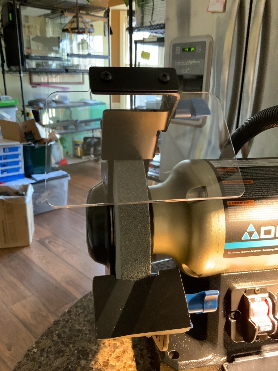

– toolrests and polycarbonate-eyeguards are a little basic, but adjustable snd well thought out

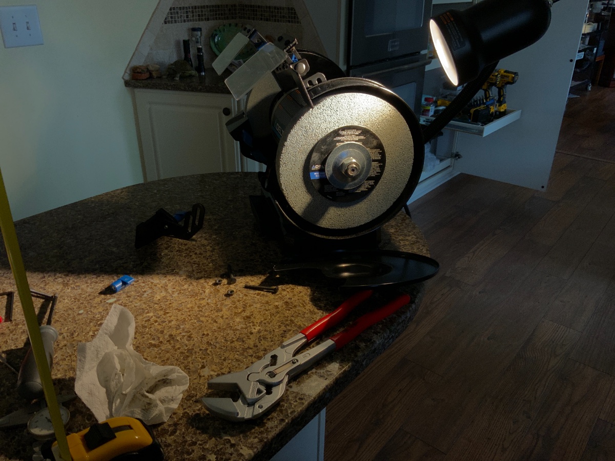

– the supplied wheels are 36 + 60 grit, slightly over 1″, and a little vibraty, but usable

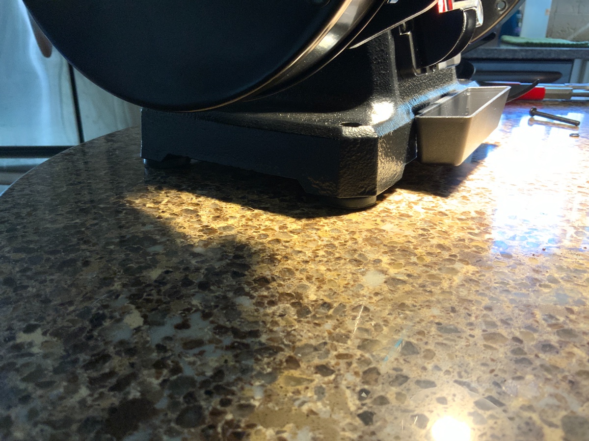

– finally, there are flat rubber feet on the bottom which help absorb vibration.*

There are some good toolrest mods on YT, but mainly for machinists who can pull out their
metal lathe, milling machine, cold rolled and al-angle scrap. Imma see what I can do, but
the supplied toolreasts are usable once you figure out how to assemble them: I had to
scout some pics on the internet, the directions are for s****!

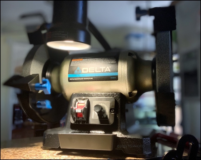

Maybe coulda found it for $20 less, but bezos had it in my hot little hands in 36hrs via prime,
less than U$155. I think it’s a rebrand of the white ShopFox, bothhave them made to order,
and apparently identical except for color and labels. If I’d had too much money, woulda been
happier with a Baldor version, but at 4-6x times the price? I’ll get some mo-betta wheels
in finer grit soon, and consider a CBN or possibly a lapidary disk and backing plate, hmmmm!
