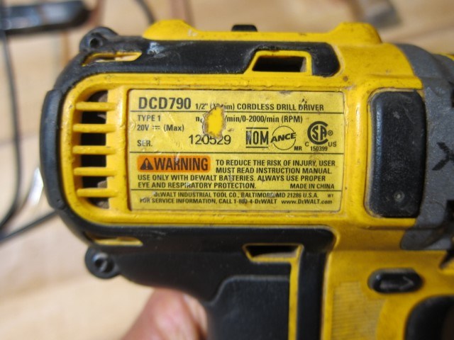

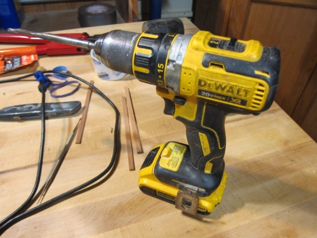

I have a great 20v dewalt drill (DCD790) that has developed a problem holding onto smooth shank drill bits. First I thought of roughing the surface of the bits and inside of the chuck with sandpaper, but then thought about how I have been disappointed with the feel of the chuck when tightening. I would usually hear a series of clicks and a more gradual tightening of the jaws, but now it really only has one, maybe two clicks and the absence of that satisfying cinching response. On a couple of occasions, I have tried oiling and working the jaws in and out similar to what this video recommends, though admittedly I probably fell short on this sort of maintenance. I would like to know methods for restoring life to the chuck or if at this point the proper course would be a replacement of the chuck.

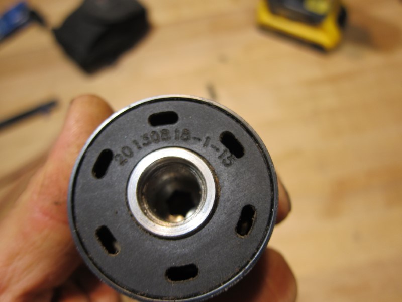

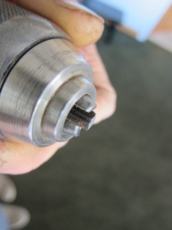

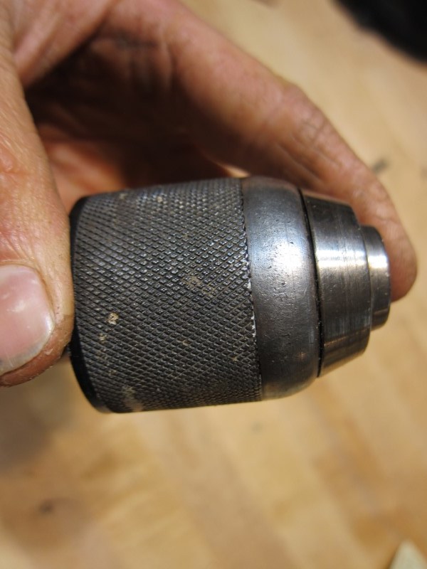

I took the old chuck off to get a look at what make of chuck came stock and how much of an upgrade this replacement would be. Nothing comes up with a search of the number on the back, but maybe someone has an idea?
paulengrMember since Sep 2018
Rohm. That is who Dewalt uses. Same with Makita. Milwaukee uses another one sometimes and they suck but Rohm makes one for them too.
Unfortunately it’s a fact of life that keyless chucks are crap. Rohm makes the best out there. If there was a better one I’d buy it. As you said at $50 each it’s cheaper than a new drill but I’d like to get more life out of them. The old keyed chucks last as long as the tool.
