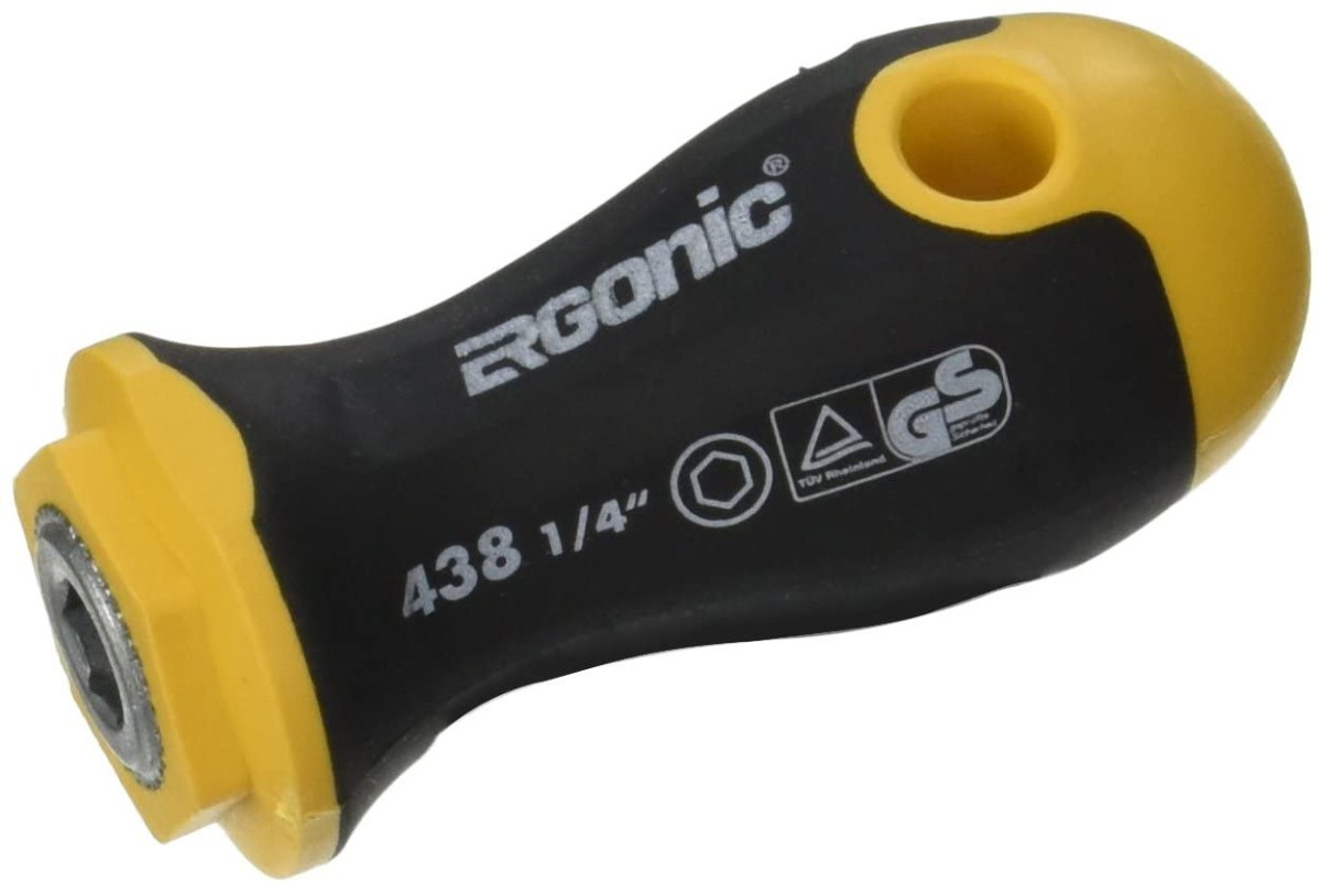

I would prefer to have one similar to this one in the photo (Felo Stubby Handle) but a bit longer (not stubby) and made of one piece of stainless steel with a bit holder in the middle exactly like this one, flush to the body which accepts E6.3 1/4″ hex shank bits, of course with a rough surface not polished.
