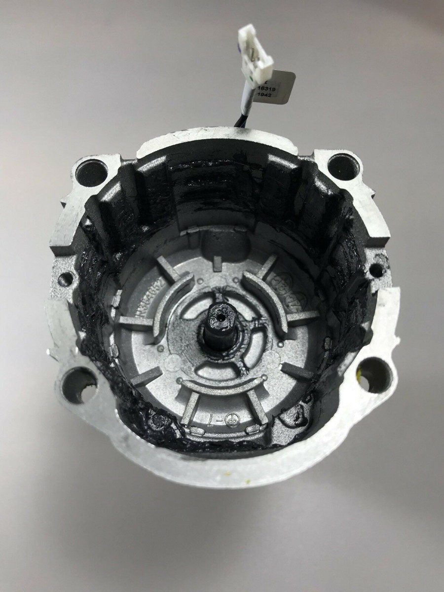

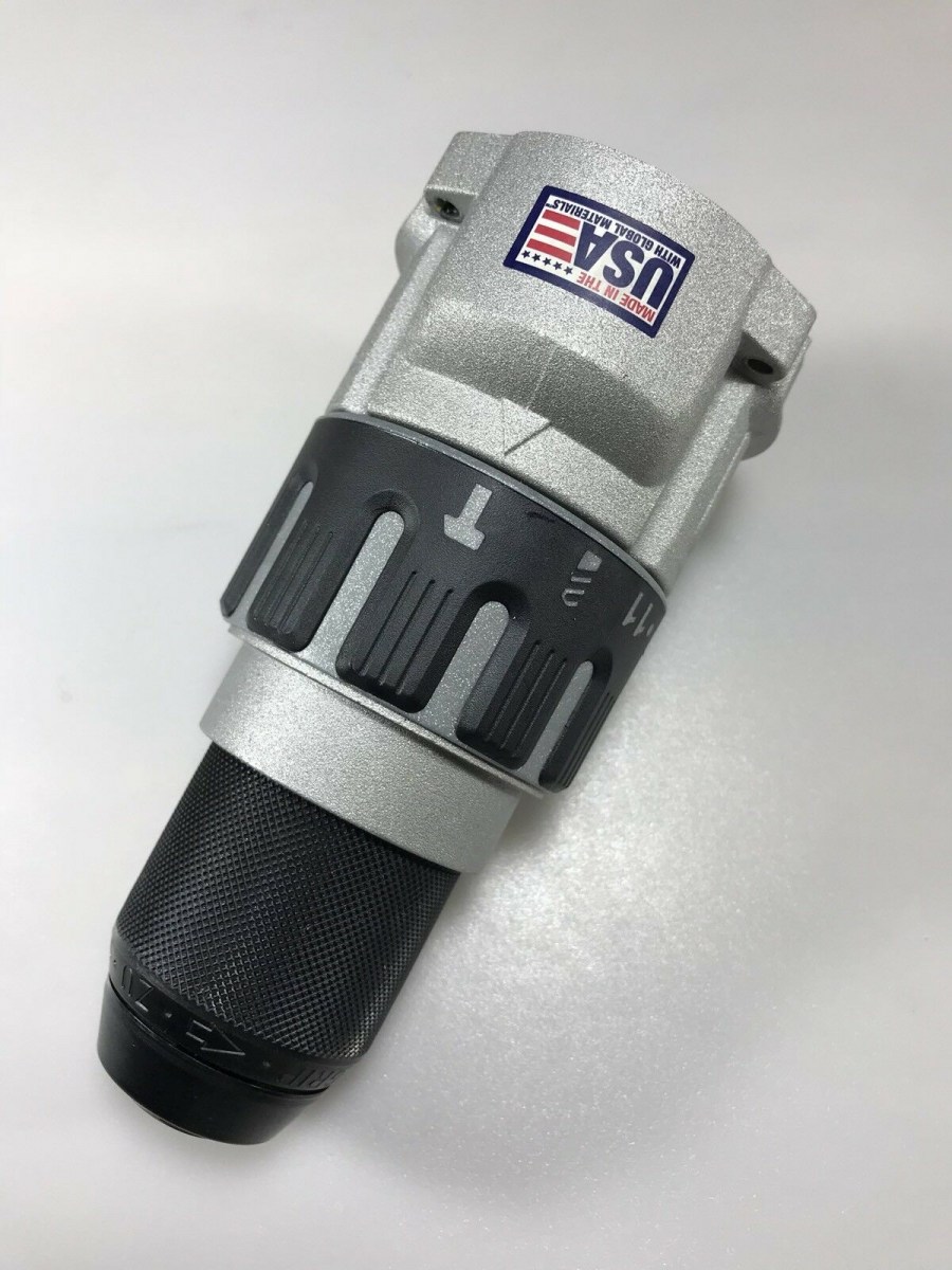

Sorry, but I don’t know what “I’ve lost the jaws to my chuck” means.
The chuck is part of the nose cone assembly, unscrewed by the four corner bolts and the impact connector unplugged.
