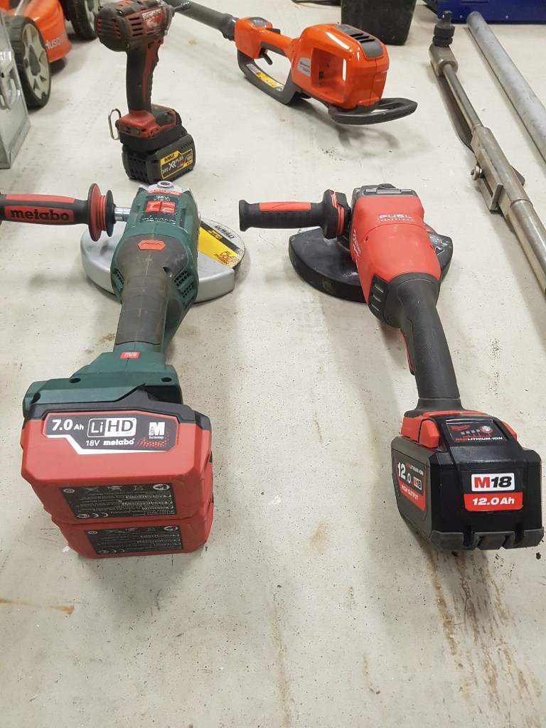

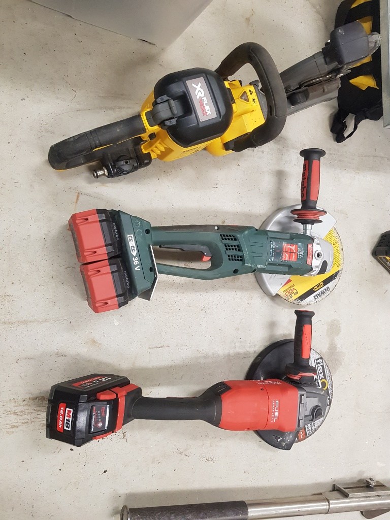

Hard to see the height differences in the photos but the Metabo is slightly thinner at the head. Length wise they are almost the same and the Metabo is obviously heavier at the rear with the twin batteries, knuckle guard and metal spark guard.
The case of the Milwaukee is huge!  I think it’s unnecessarily large as the Metabo case holds more and is smaller but the Milwaukee case handle doesn’t crush your fingers like the Metabo case does.
