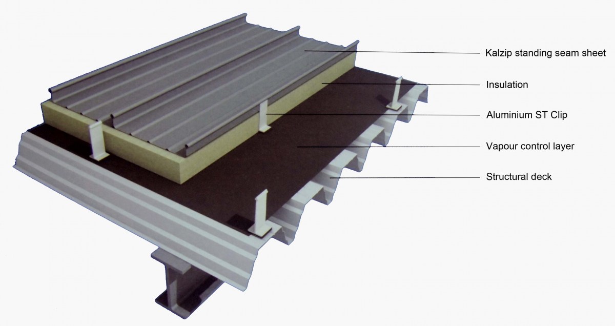

metal roof decking
Most metal roofing profiles are around the 3mm thick mark, increase that for stiffening ribs and where the folds for the profile are introduced and you’re going to spend a lot of time cutting these out with a 6″ hole saw. Depending on the profile I’d probably prefer to use a jigsaw or if the sheet metal gauge is light enough, a punch nibbler that will allow you to follow the profile.
I’ve recently been working with 100mm profile roof deck and had to cut to end of 30mm holes into it and I was sick of it.

When you talk metal deck roof what exactly do you mean? There certainly aren’t any metal deck roof sheets I’ve seen here in Australia that are >1mm in thickness let alone 3mm thickness? You wouldn’t be able to lift the sheets.

Depends who’s lifting them or how (crane/forks) but I mean structural metal deck roofing. There are a number of different brands with a wide range of gauges depending on load rating and span.
Most common one is Euroclad but I know Tata Steel do on, countless other brands. Some are 0.5mm + powder coat, some are 2mm + powder coat.
https://www.bimobject.com/en/tata-steel/product/roofdek-d153
www.euroclad.com/roofs/structural-decks/
