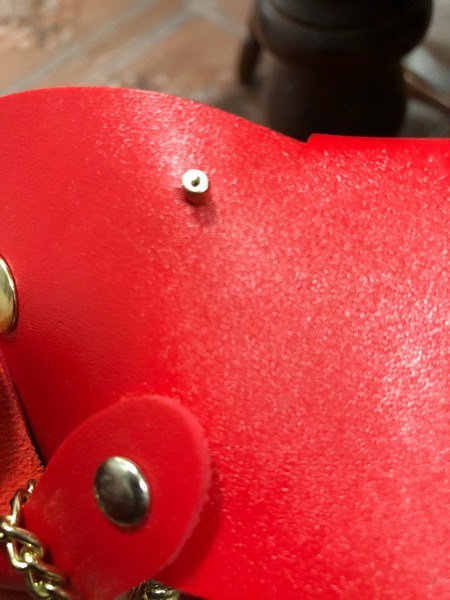

I have got couple of those keyrings that have their snap on fasteners broken
Looking to by a tool and fasteners that help me to fix them
