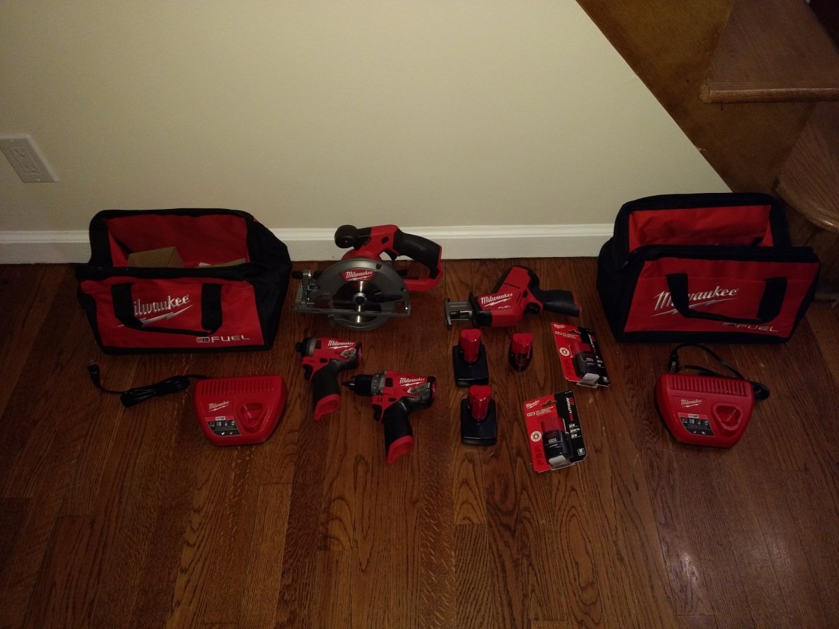

Decided last month to start my cordless tool collection. I’m a home DIYer who has tackled some medium sized projects. Wasn’t looking on spending too much money. Went back and forth on some different brands and decided the m12 line could probably handle most of what I ask it for and its the biggest 12 volt line out. So far very happy with the Fuel version of tools I got especially the Gen 2 stuff.
As far as the batteries the way I understand it is youll get a little more power when going from the compact to the XC. The compact has 3 batteries wired in series to get 12v. The XC has 6 batteries, 2 -3packs, wired in parallel. The extra set of batteries allows more current to get to the tool when it needs it. The 4ah is “noticeably stronger” than the 2.0ah compact because it has more batteries. The 4.0ah XC to the 6.0ah XC has the same number of cells just each cell is capable of a larger amp hour, so in that case I doubt you’ll see much of a power increase, but of course it will last longer.
