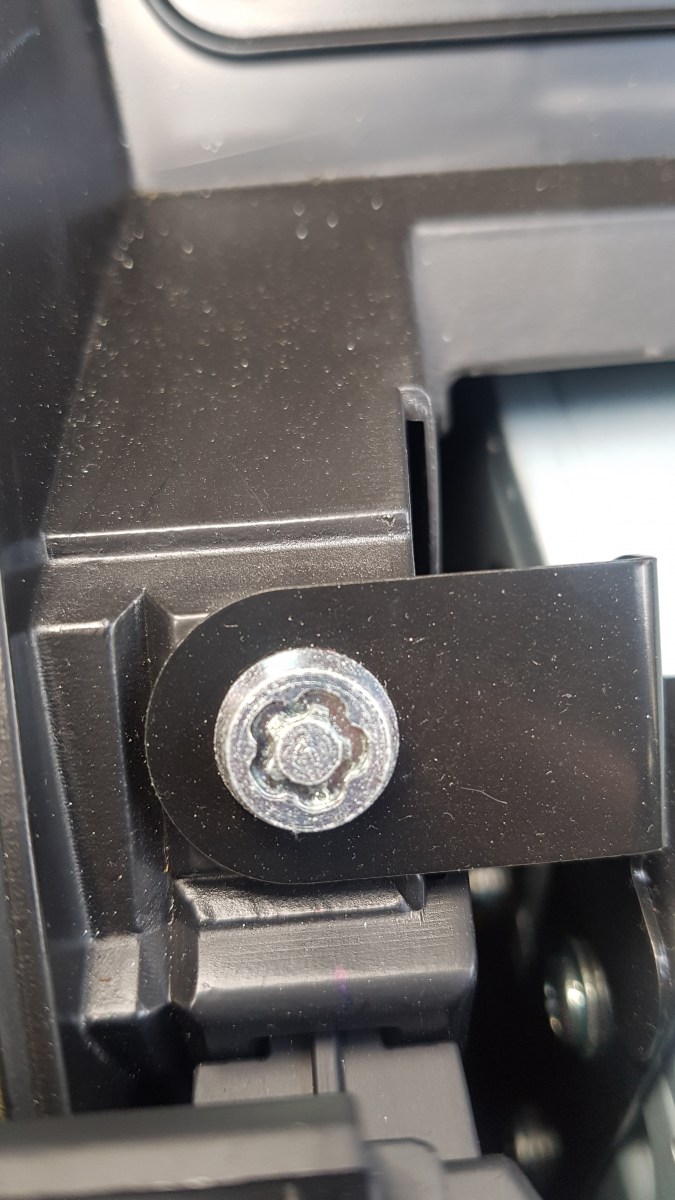

I’m stuck in a pickle been to loads of hardware store no solution, not even sure what i am looking for at all to open this thing.
The screws are holding my car stereo in place and its one of the weirdest ones I’ve come across.
Security torx plus.

the center isn’t round though?

Those are actual ridges not a lighting trick? What’s the make of the vehicle and radio?
JasMember since Sep 2017
Its a mazda axela sport 2012, factory radio which is a pioneer NVH-0228

Probably have to buy the tool from the car dealer parts department. I have a socket in my tool collection from a Porsche special security nut that was only available through their part system at the time I needed it.
drill it out and replace with conventional
If there’s enough meat on it you might be able to get a bolt extractor around it
looks like a security screw. I would guess they would be required now days so people don’t steal radios from cars.
Forgot about this. It does really look like tamper proof torx plus. See if that will fit in there, it might now fit perfectly but it might work. I know pretty much all the security fasteners but I’m drawing a blank on this if the inside ridges are pronounced like it looks. The easy way to do it… one of my most valuable tools in my bag: https://www.amazon.com/gp/product/B002L6HJAA
If you get those pliers, don’t grip very hard or you’ll chew the outside of the head up…you can reuse the hardware if you grip it lightly.
