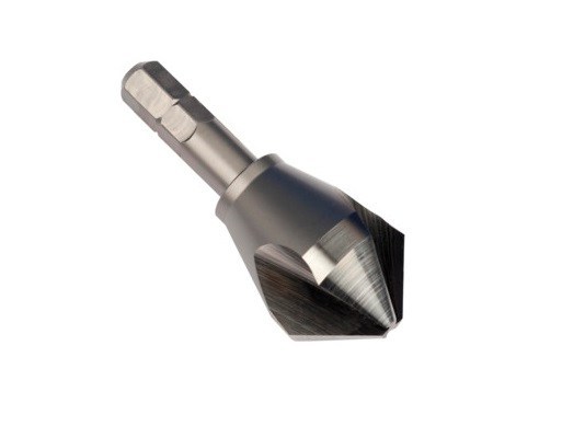

If you want to use it for metal better to go with HSS Co (Cobalt) ones, Dormer makes them with hex shank as HSS Co (HSSE). Snappy ones are made of HCS or TCT and are specifically designed for wood.
