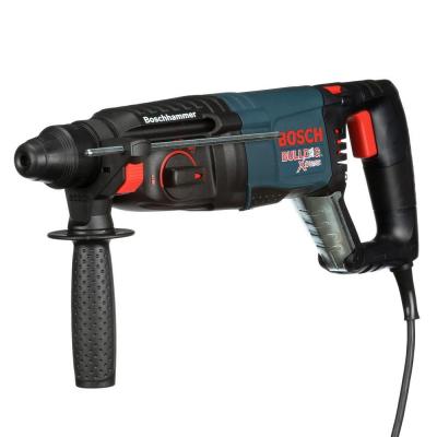

There are several manufacturers that makes smaller SDS rotary hammer that give you more finesse, easier to handle, it can carefully punch through masonry and not shake a wall and it wont punch through maybe a pipe or electric if it’s in the wall. You can get corded or cordless and a chisel bit to put in it. Just make sure the tool has the option for chisel only mode, some come with drilling or drilling/hammer only.
SDS rotary hammer dude, get a Bosch with a chisel on it and go to town. I have the Bosch bulldog extreme posted above,its awesome.
