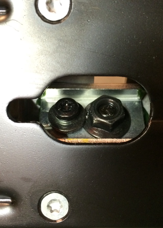

Edit/Update:  I seem to have fixed it! Replaced 1 of the 2 screws holding the base on, tightened them (nut first then torx screw w/ washers), & used loc tite on them + tightened all screws on the tool.
I was just at HD and saw a display Milwaukee Jigsaw on the clearance rack.  normally $129 for tool only.  I got it for $60!  My question/issue is that the base place seems to be quite loose/wobbly… and the arm that you open and close to adjust the angle on the bottom plate is also super loose.  you can open it just by turning to tool to that side.  Should I return it and forget it …or does anyone know how to fix this?

This is looks weird to me but can someone check. The screw on the left (front screw) has a small silver washer and then a bigger black one that is on top on the end of the bigger bolt on the right.

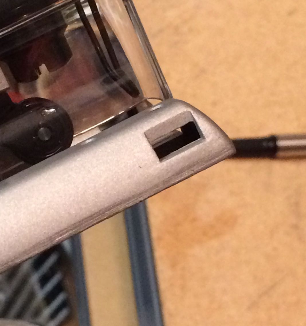

 I also noticed two empty threaded holes on the front of the base plate as well as horizontal slots on both sides above the anti-splinter clear shield. I couldn’t find any info about this at all, is this for accessories or my missing something.
Those holes on the front are for a rip guide.  It should have come with a little wing screw to tighten down on the rip guide but I’m sure that was lost a long time ago when it was on display.  You can replace it with any screw that size if you ever need a rip guide but they’re not used much on a jigsaw.
I’ll check about those washers on a friend’s if no one else gets back to you first.

Thanks so much for the info. I could not even find a single pic with this jigsaw using one hahha. But yup, that accounts for the 2 holes and slots. …this seems to have been a really good deal now haha. $69 for a fully working tool now!!

BTW I checked my friend’s jigsaw and it has the same screw setup.  Nothing to worry about now that you’ve tightened it down.
