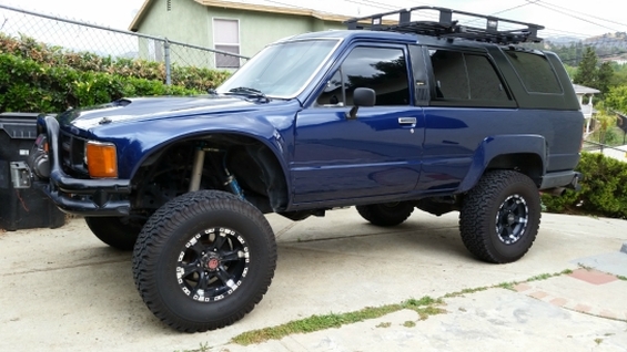

I installed the steering gear. More pics and a write up to come (after finals) but here’s a little pic to hold you over. 🙂
I installed more then pictured, including inner & outer tie rod ends but those pics are on my PC. This was my first time messing with IFS. Independent Front Suspension. It wasn’t too bad but I definitely made a few mistakes 🙁
Quick trip to get aligned
And a quick off road shake down. Note, hoods are up only to air-up. Compressor powered from battery.
I have a few more adjustments to make but it’s already x1000 better

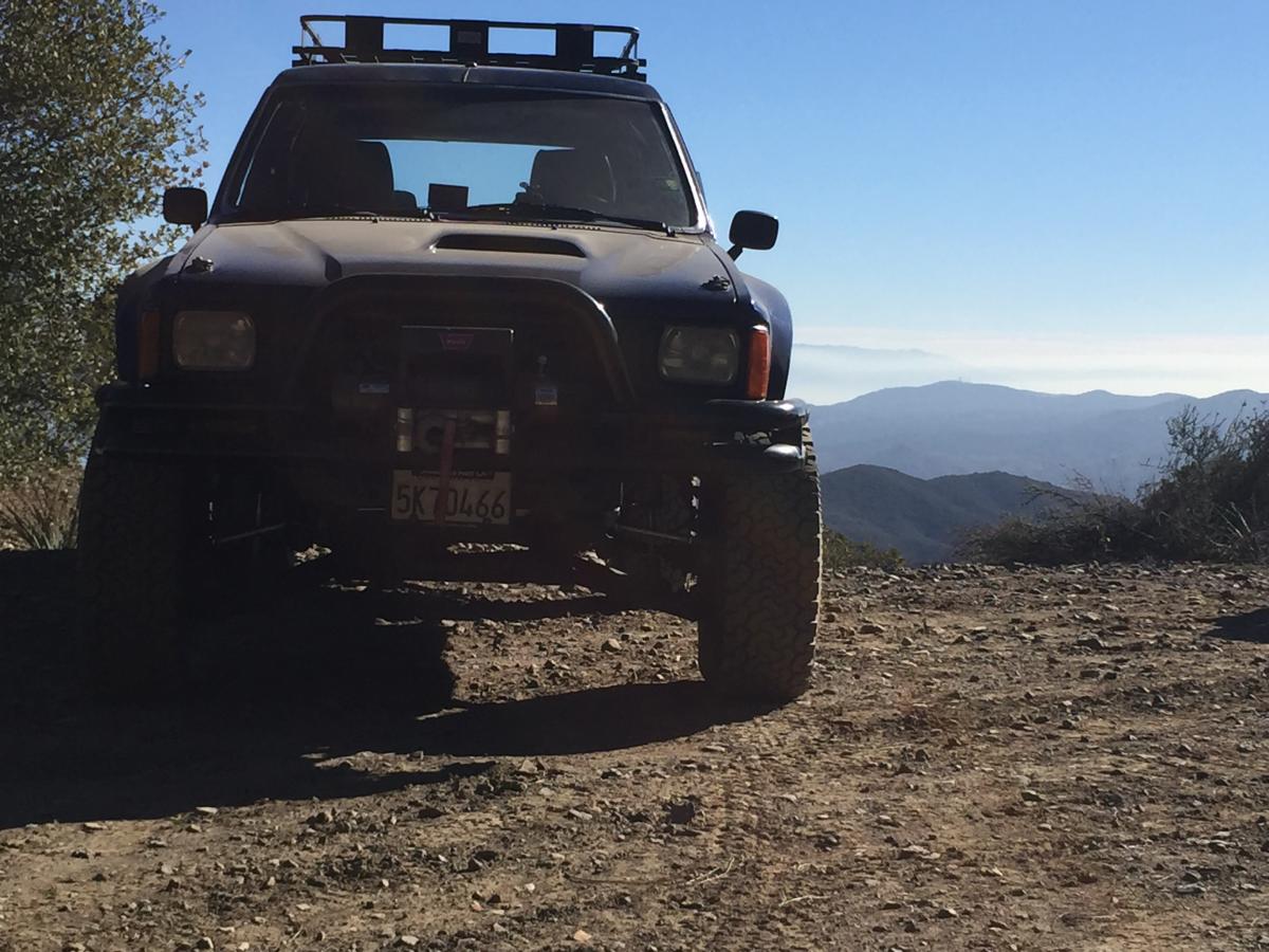

I took the 4Runner up a local trail, to the top of some cellphone towers. It did great, although I noticed an oil leak from the t-case rear drive shaft seal. Guess that’s the next fix.
It was nice and sunny going up the mountain then on top the fog rolled in.

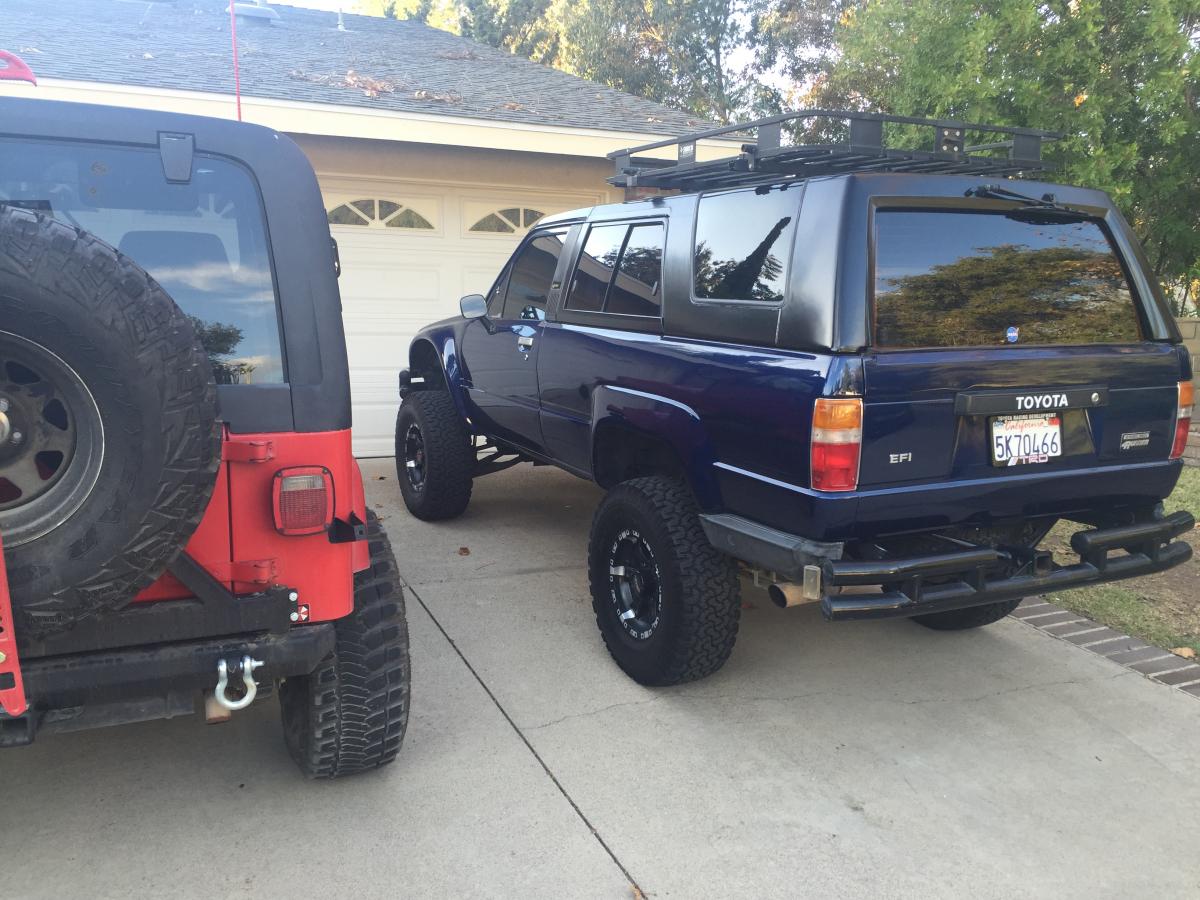

My blue 4Runner, brother-in-law with the red YJ, father-in-law white jeep trailhawk

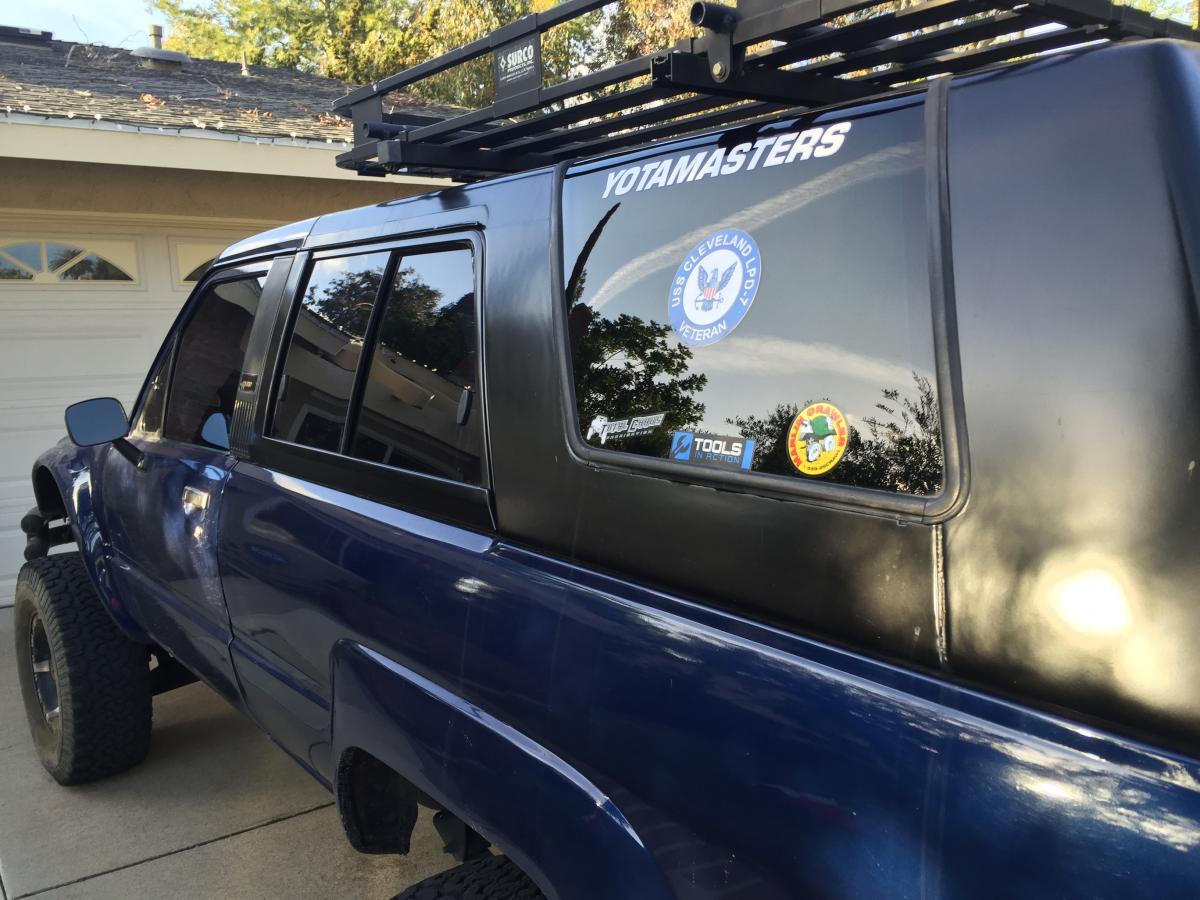

Bro’ed up the 4Runner today with some sticker bling.
1st to go on was obviously TIA
Then a few from some part suppliers
Had a big open spot so I had to rep my old ship
Need more stickers before I am full bro, but I’m getting there

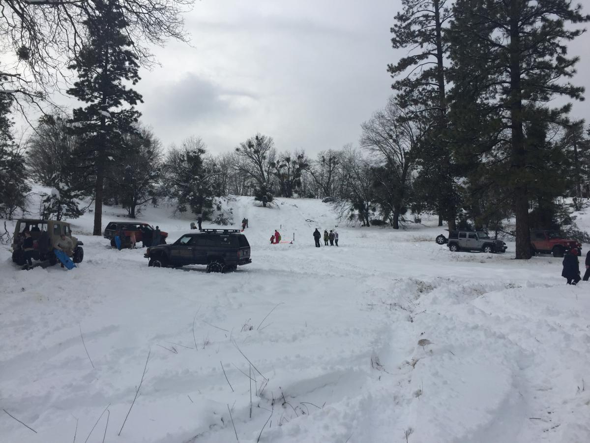

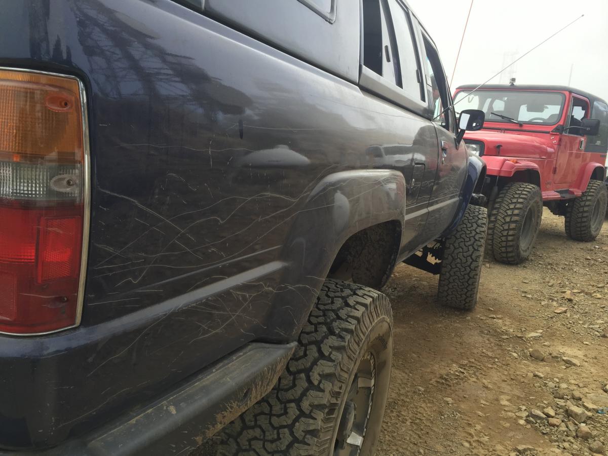

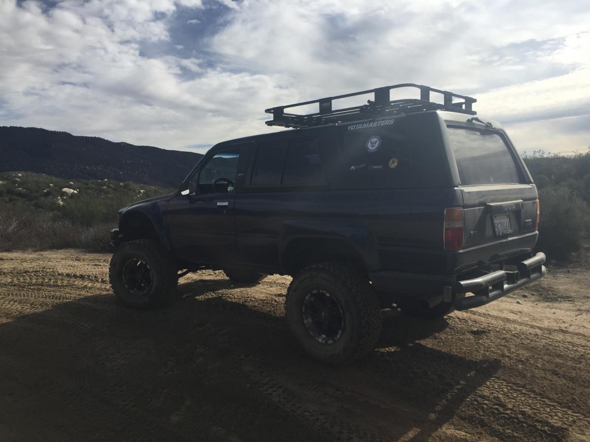

Took the 4Runner out today. On our way up to the cabin, hit a detour. About 15 miles of mellow trail. Started in the desert, ended in the snow. Only in California.
My brother-in-law & his girlfriend (white Chevy) were camping in the area and headed home. We planned the trip so we would intercept midway. Didn’t bring my camp stove, otherwise lunch would of been perfect.

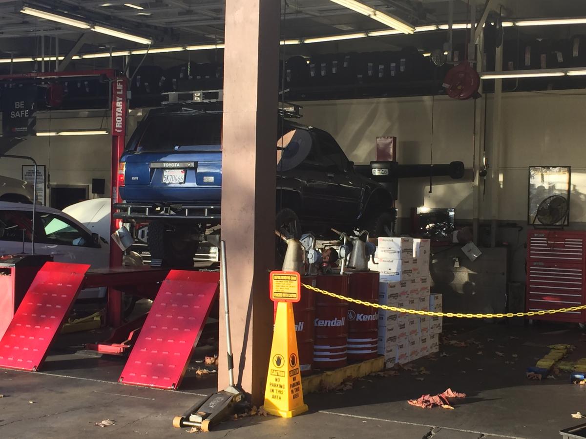

Sold the jointer today. Sad to see it go but I haven’t been using it much. Took my truck to a local driveline shop, they specialize in race trucks so my baby is in good hands. The drive shaft was short and u-joints were bad. Previous owner used a vice when replacing u-joints and marred/dented up the old shaft pretty bad. I pick the truck up tomorrow, very interested to see how it responds. About $360ish for new shaft, u-joints, & balance.

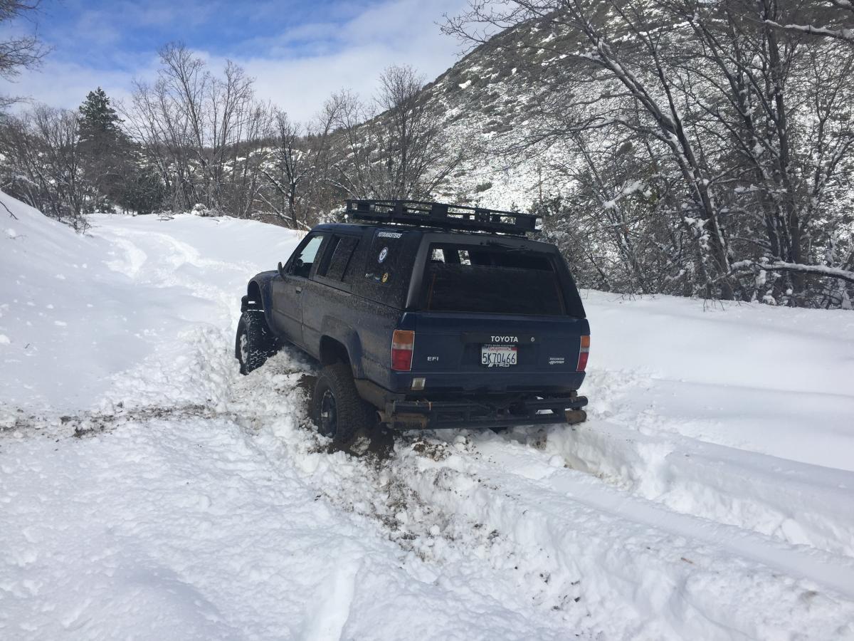

Good news bad news
Good news: Drivelines are awesome!

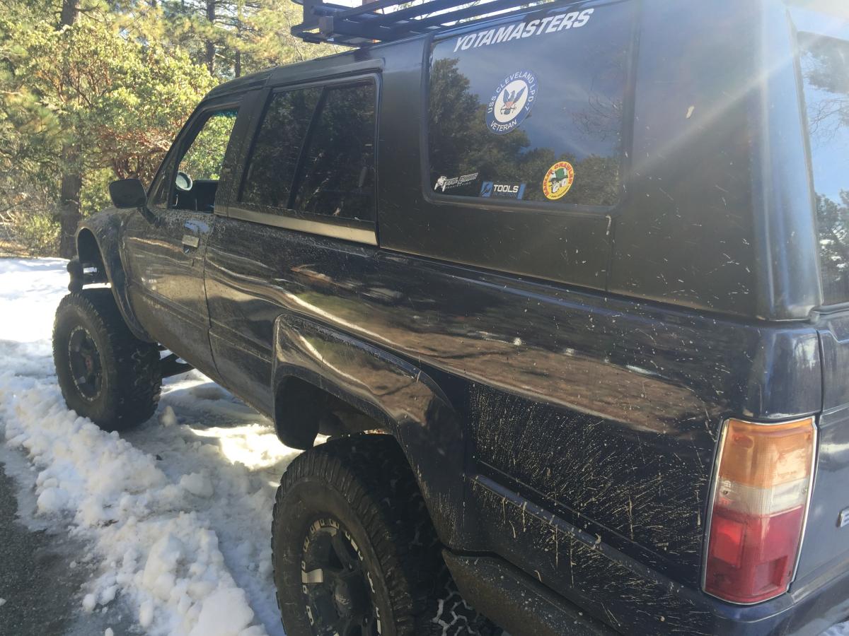

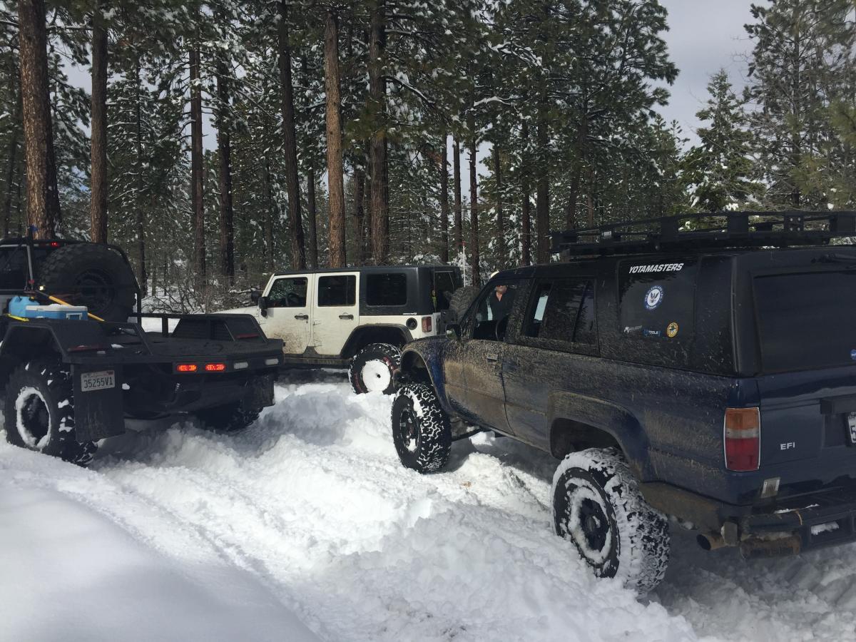

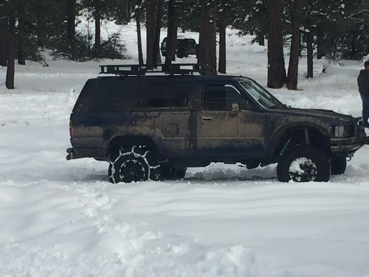

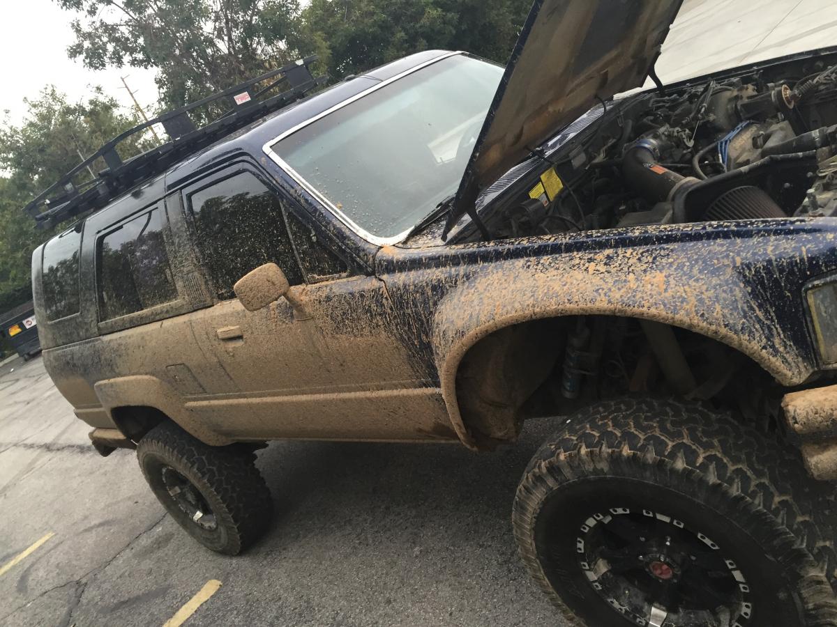

Bad news: I broke lots of other stuff playing in the snow
Photo from the original forumPhoto from the original forumPhoto from the original forumPhoto from the original forumPhoto from the original forumPhoto from the original forumPhoto from the original forum
Looks like it was a lot of fun tho!!

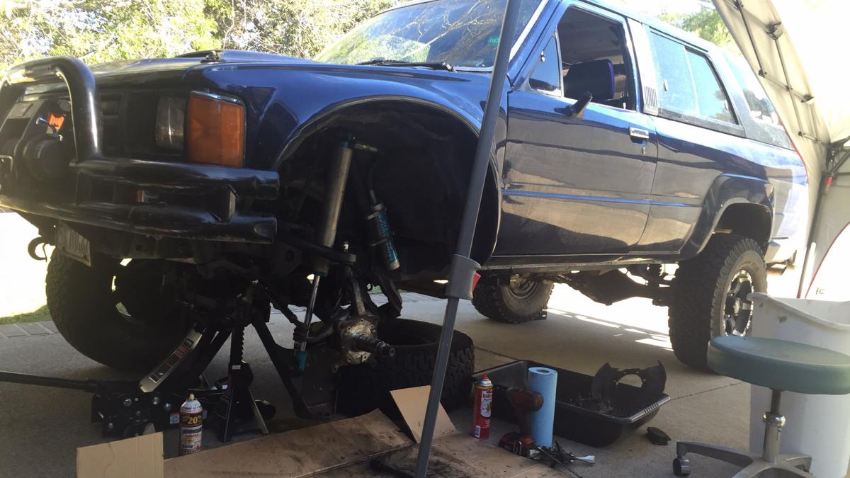

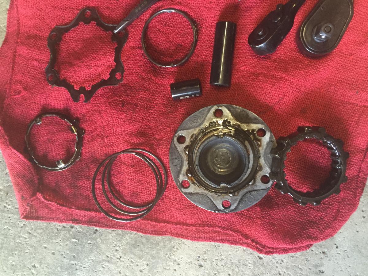

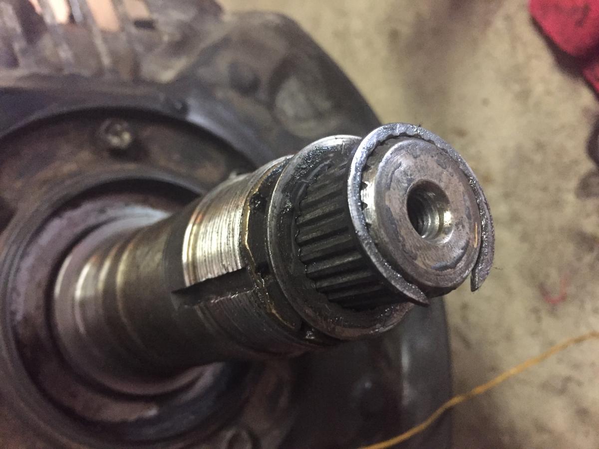

I spent this weekend working on the truck. Pics to come. replaced wheel bearings, CV axles, lower ball joints, and rebuilt the manual locking hubs. I didn’t do my math homework though… math sucks.
Did enough math adding your parts bill lol
Yep, turns out a 30 year old truck is expensive
