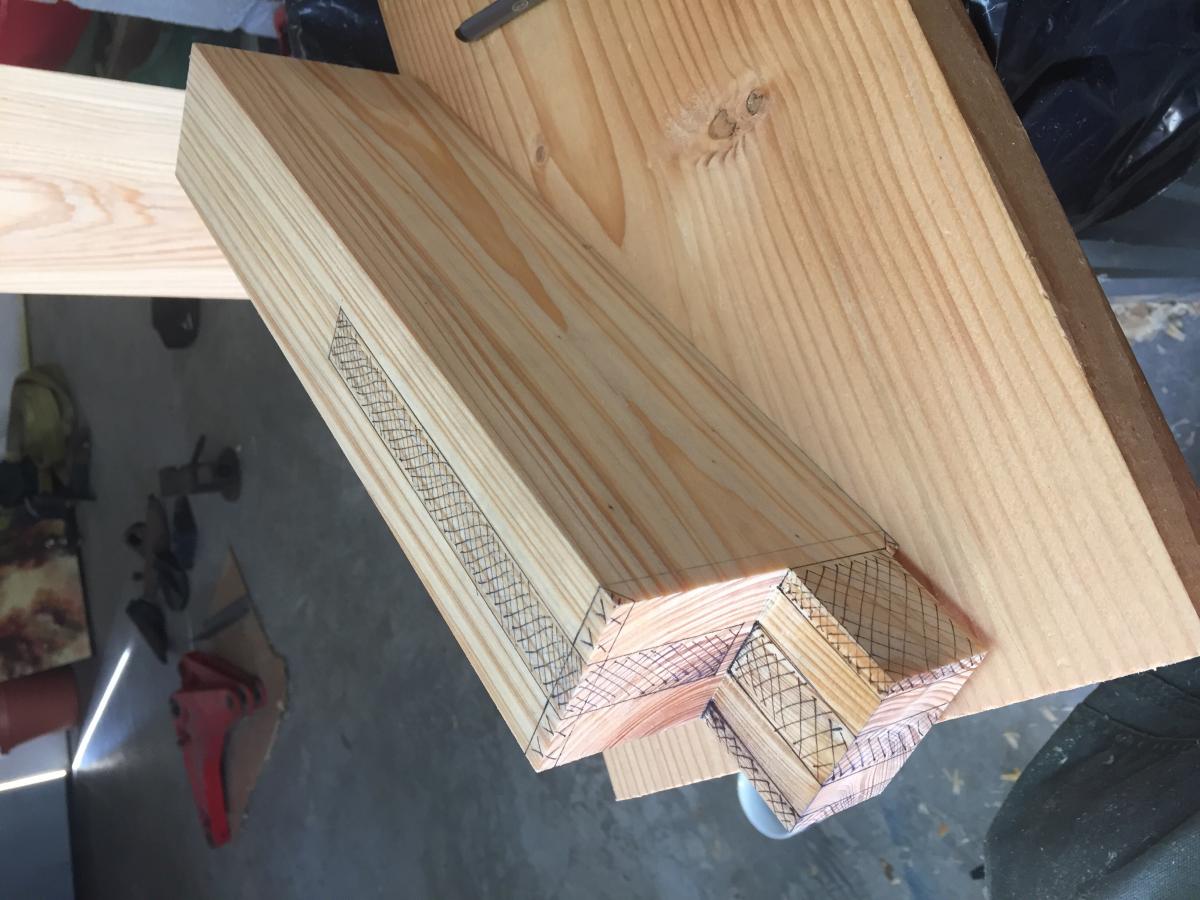

Layout:

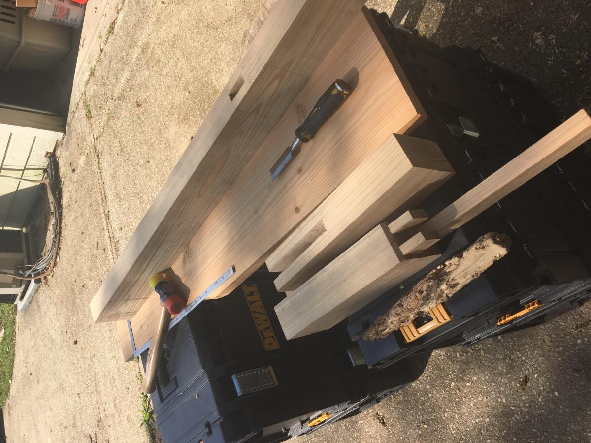

Roughly cut pieces:

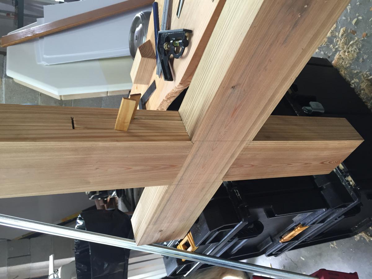

Partial assembly:
Instead of draw boring with wooden pegs, Japanese joinery sometimes uses these tapered keys that lock in the drawbars. They’re called shachi-sen and are made of a harder wood than the parent material. These were from scraps of Osage Orange.

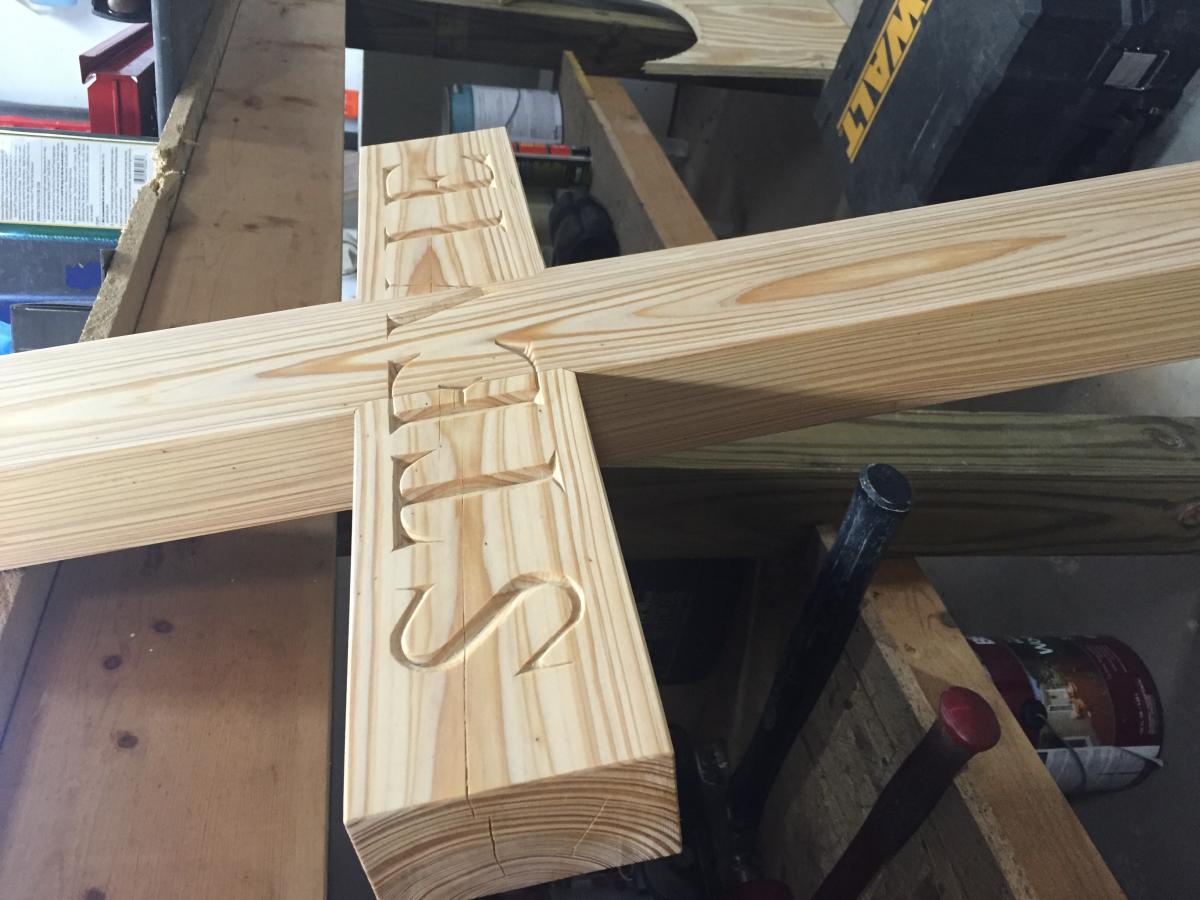

And the finishing touches; my first try at carving wasn’t terrible but really nothing to brag about.
