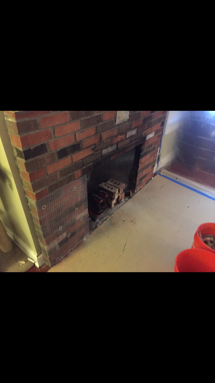

It is finally over and I can sit back and have a drink!
Starting with the mesh and scratch coat.
Starting to take shape
All finished with a touch of patience to spare lol.

Looks great!! My friend has a problem with his fireplace it’s got textured pink brick. He wants to do something with it but isn’t sure. He doesn’t know if he can tile or do a brick veneer like you did.He might just end up painting it as a quick fix. I wish I had a picture of it. A woman had to have picked the brick and color it is crazy how bad it is.
Painted brick is a sin against man and beast! That’s my opinion haha.
Good news for him he could do either one.
There are two routes. He can either do the lath and scratch coat like I did, or cement board anchored to the brick.
The cement board is better if your finish product is going to be a tile and scratch coat for a stone product.

I was wondering, can this method be used over an existing tiled fireplace?  My wife wants me to reface our tiled fireplace, but I don’t know what’s the best approach to take on this project.  Good work on the fireplace BTW.
You have to start with a good base that is key. If your tile is sound then you can attach a cement board backer or lathe and scratch coat.
If you message me pics of your fireplace from different angles I could try and send a few pointers your way. I’m not a stone Mason but i can offer input.
