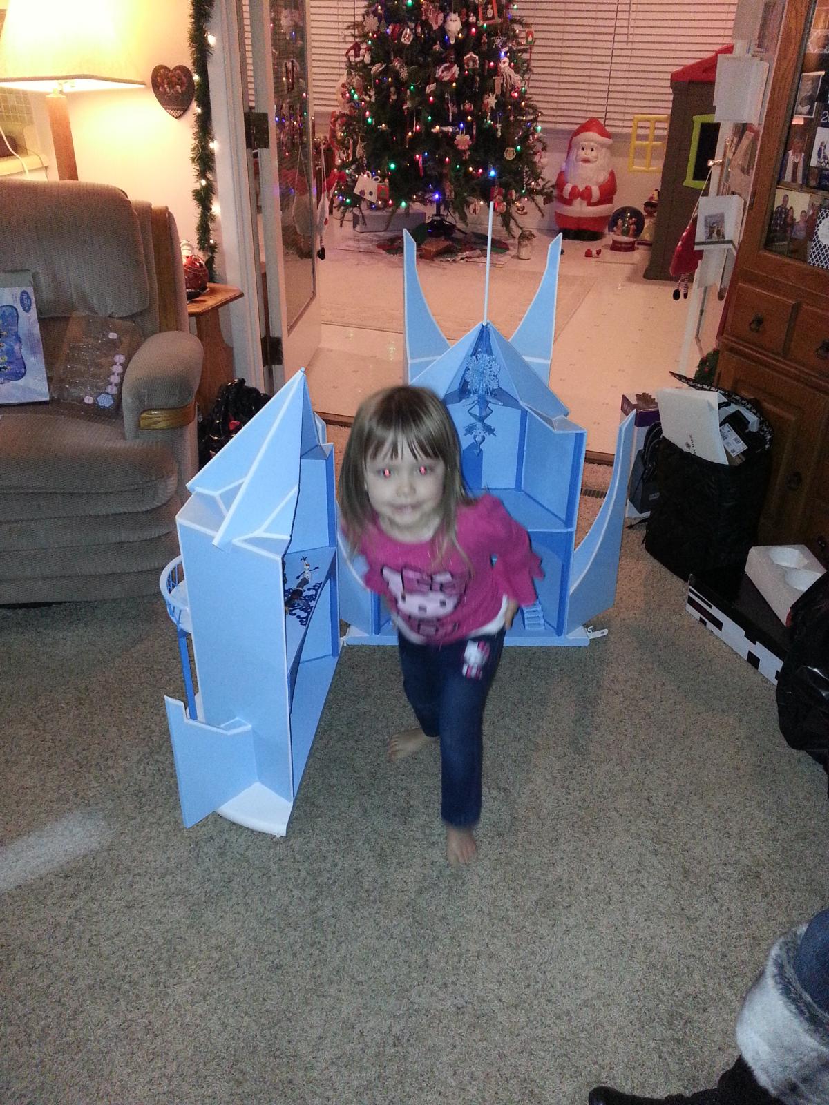

I made a doll house for my niece with a “Frozen” theme.  Not the best thing, but its the first time Ive tried anything like this so it is what it is lol.
That is really cool! Get it??? Cool??? Seriously, awesome job! Looks like she is enjoying it too!
Wow! Looks like you did one heck of a job.. all those angles could not have made things easy.
nice work!!
great job, thought you posted a video and it froze……..lol
Great job! How long did that take to make?
Very cool man great job!

Thanks, roughly 2 months of time after work and days off.

yeah the roof annoyed me for what felt like weeks lol!
Wow that’s amazing Hatter!! I don’t have the patience with projects that small typically. Hopefully they keep it in the family for a long time
Nice job hatter, she looks like she loved it.
Great job! That’ll last her a lot longer than a store bought one would have.
I know she loves you

What materials did u used and was it ur oen design? I was thinking of doing something like this for my 2 year old daughter.

The last pic, those red eyes with that grin kinda creeped me out…lol. I like the doll house though =) very thoughtful.

Sorry for the late reply, i haven’t been on here in forever! it entirely wood and wood glue.  I think it was called like drawer liner of something at home depot. For the design i tried to copy the movie as closely as i could. I basically gathered a bunch of screen shots of the castle in the film and tried to visualize it. Basically since its a snow flake type thing, everything is hexagonal or based of 6 somehow. 6 sides to the main part, 6 towers, 6 sides pyramid for the top, etc. I drew out most things on printer paper, and sometimes made exact paper models. Then traced those lines onto the wood and cut and sanded to fit.  If i had multiple pieces that were supposed to be identical I cut them all out on the outside of the line, then clamped them together and used a hand plane to get them all the same on each side. Then used high grit sand paper to smooth it out.  Clamping a hexagon together to let the glue dry is tough. ( i used a lot of masking tape to hold things until they dried)
