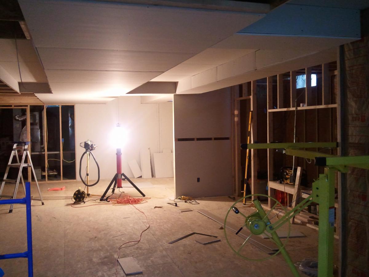

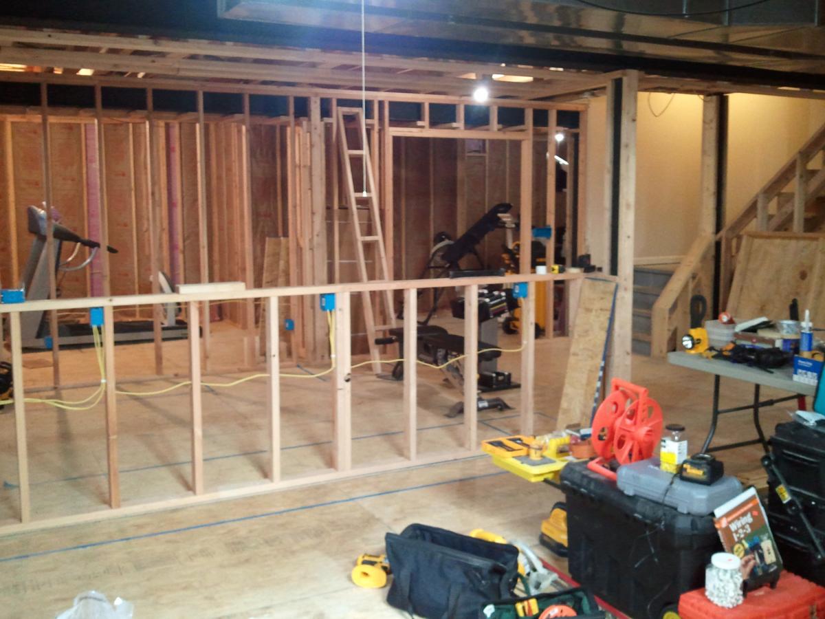

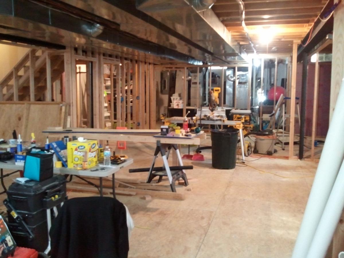

Here are a couple shots during the framing and electrical rough-in
During boarding
During electrical trim-out

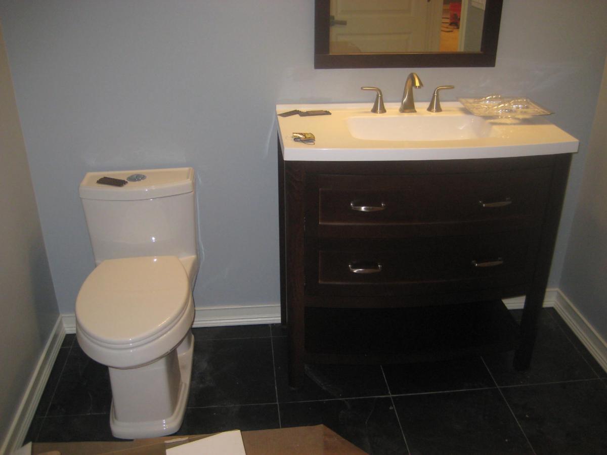

Here is the bath room from just about day one to almost day done.
The basement was already plumbed for a full bath but any layout that we could come up with, with the existing stub-outs made for an awkward layout. The toilet would have been in the middle of the room so I moved it.

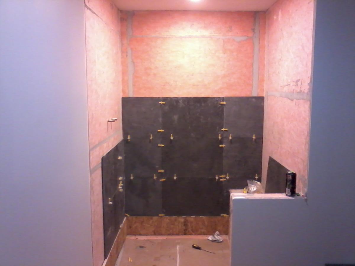

Photo from the original forum Photo from the original forum
Kerdi shower under slate tile. Slate tile is a b!tch to work with. Not one piece was the same size. Every tile needed to be cut (my Dewalt tile saw eased the pain of this task).

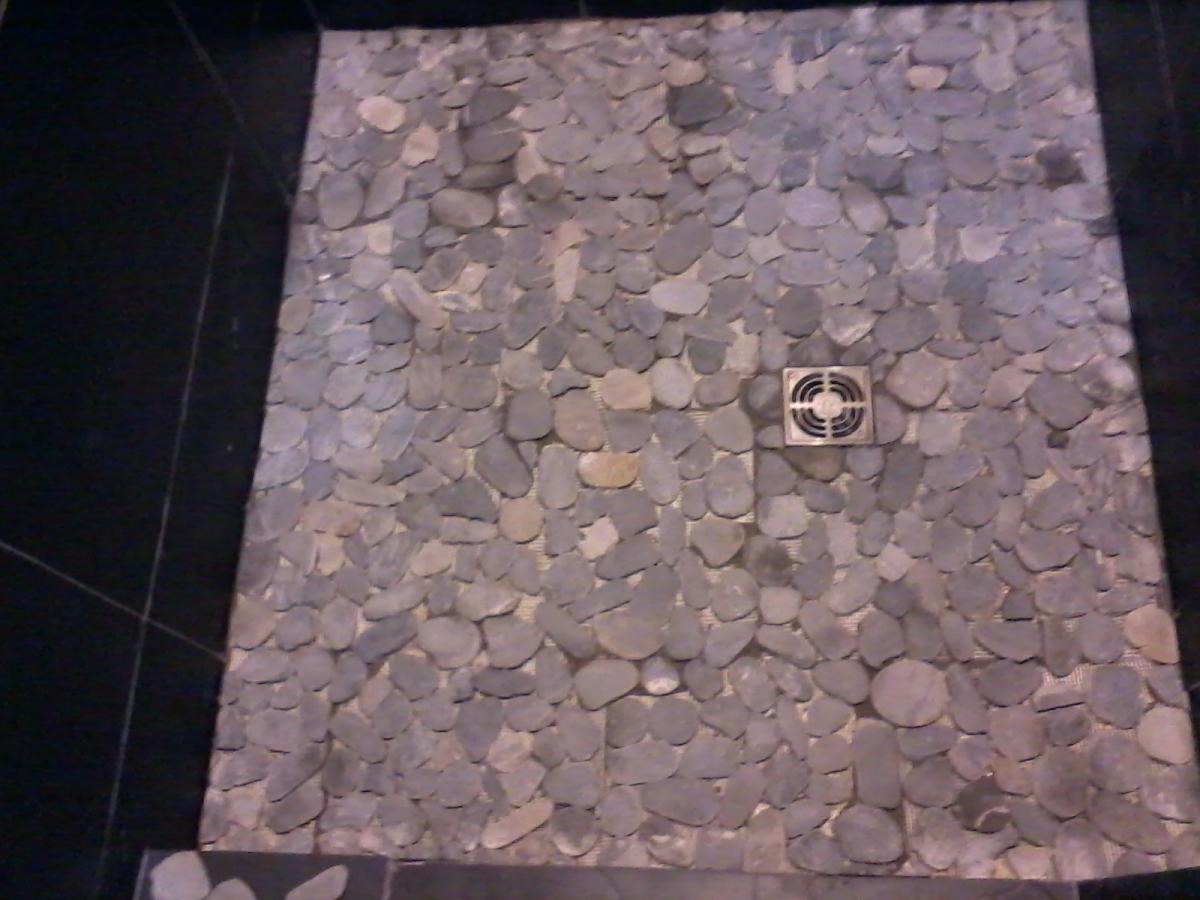

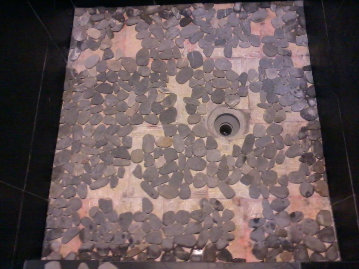

Shower floor

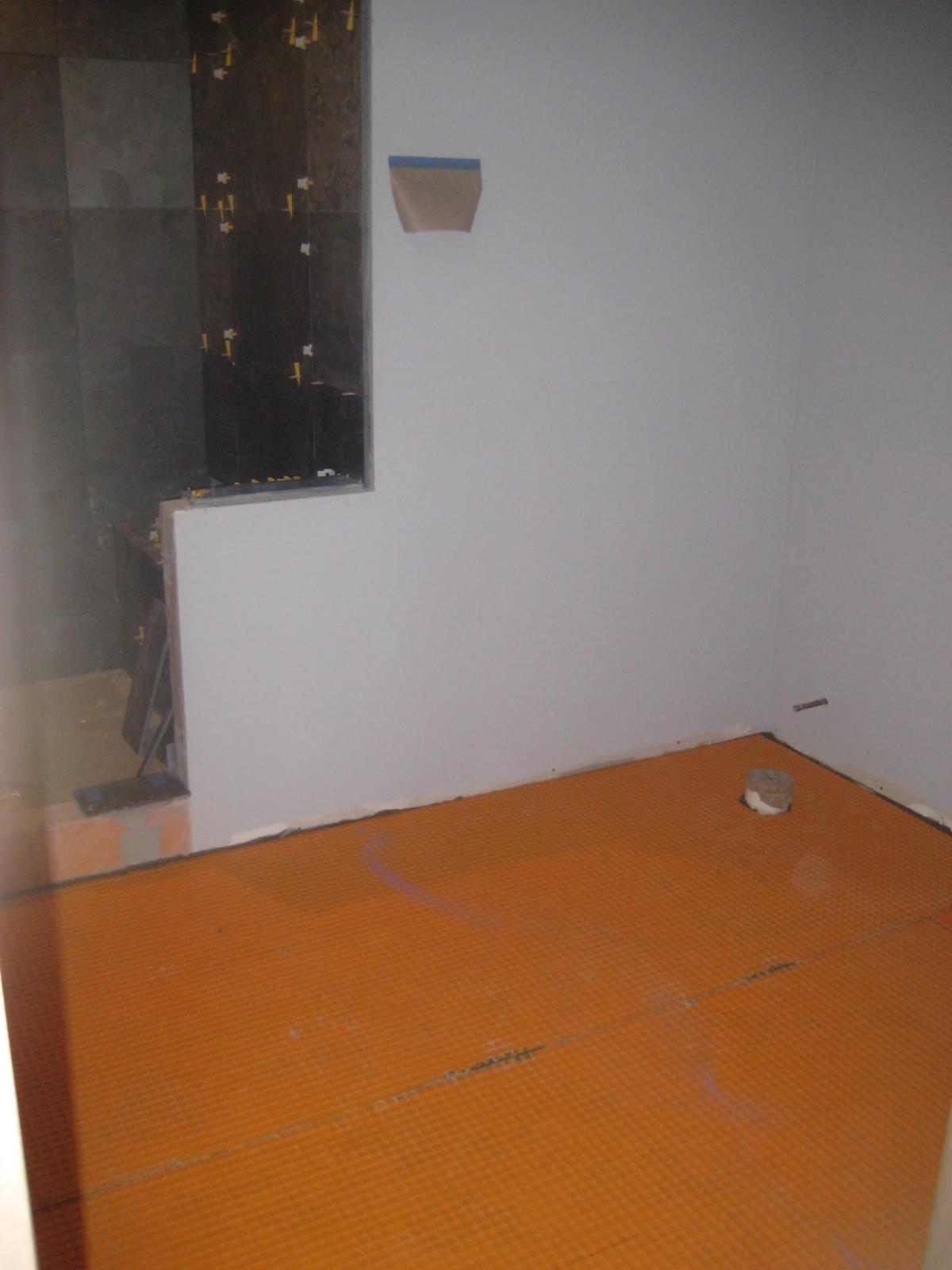

Ditra Floor

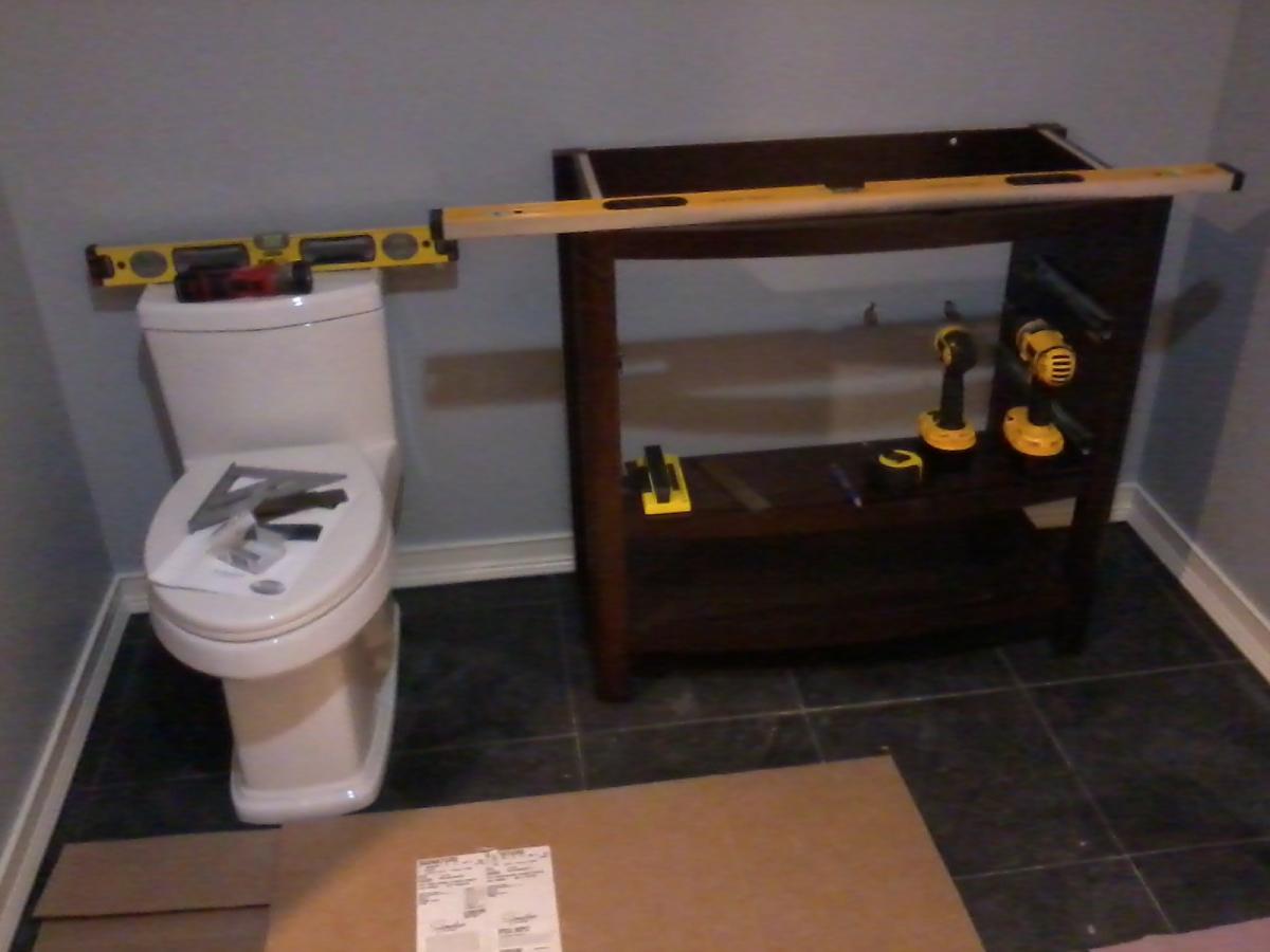

Vanity

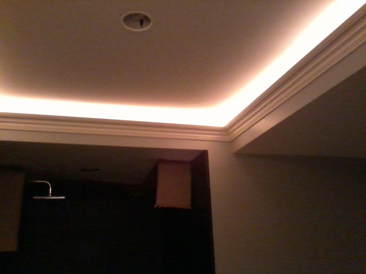

Back-lit crown witch I have since change over to LEDS.

Wow! You did an excellent job.! You’re really talented. I love the lighting job that you did. I find lighting to be the most difficult part of the project because it’s so easy to either overdo it or underdo it but it looks like you hit the nail on the head.
BrienMember since Dec 2013
Thanks DR and Matt,
Over the years I found that lighting is more than just for task. It can set the mood for the whole room and with open concept basements you can use the lighting to define the space.

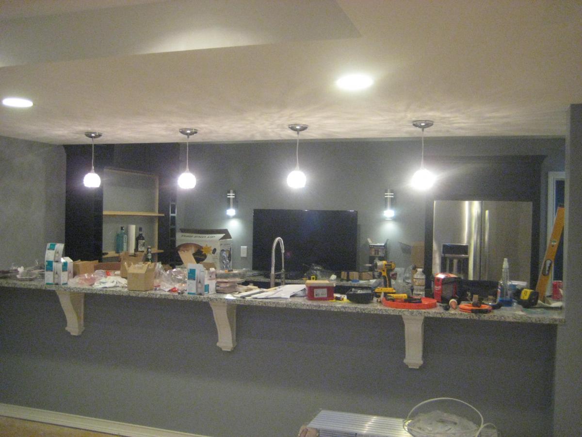

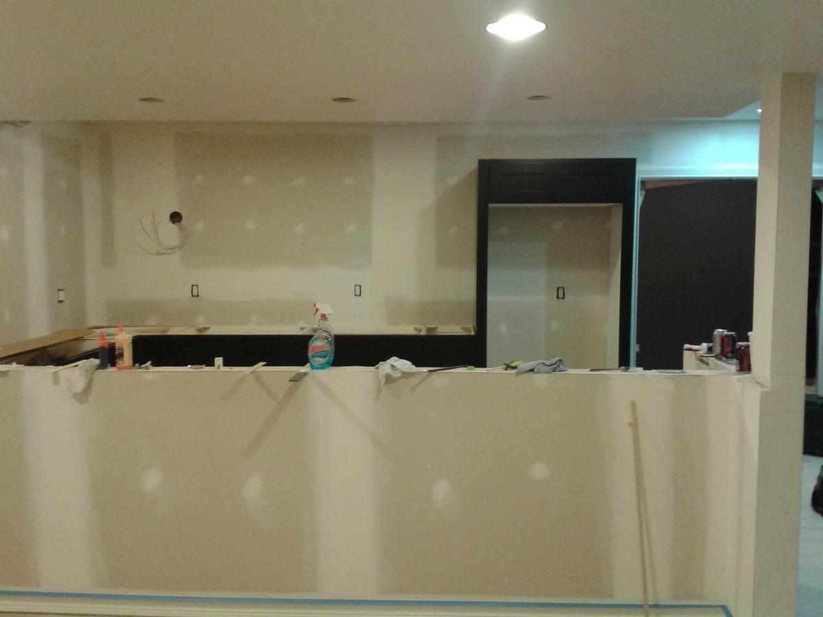

Here are some bar pictures but don’t get overly excited (DJ). It is more of a Kitchenette. It is only missing a range and an oven.

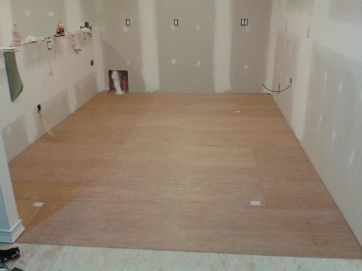

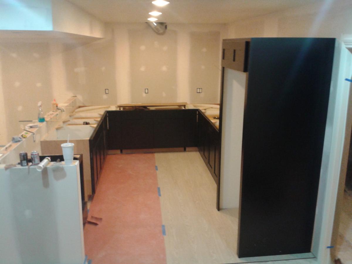

Here the Bar is ready for flooring.

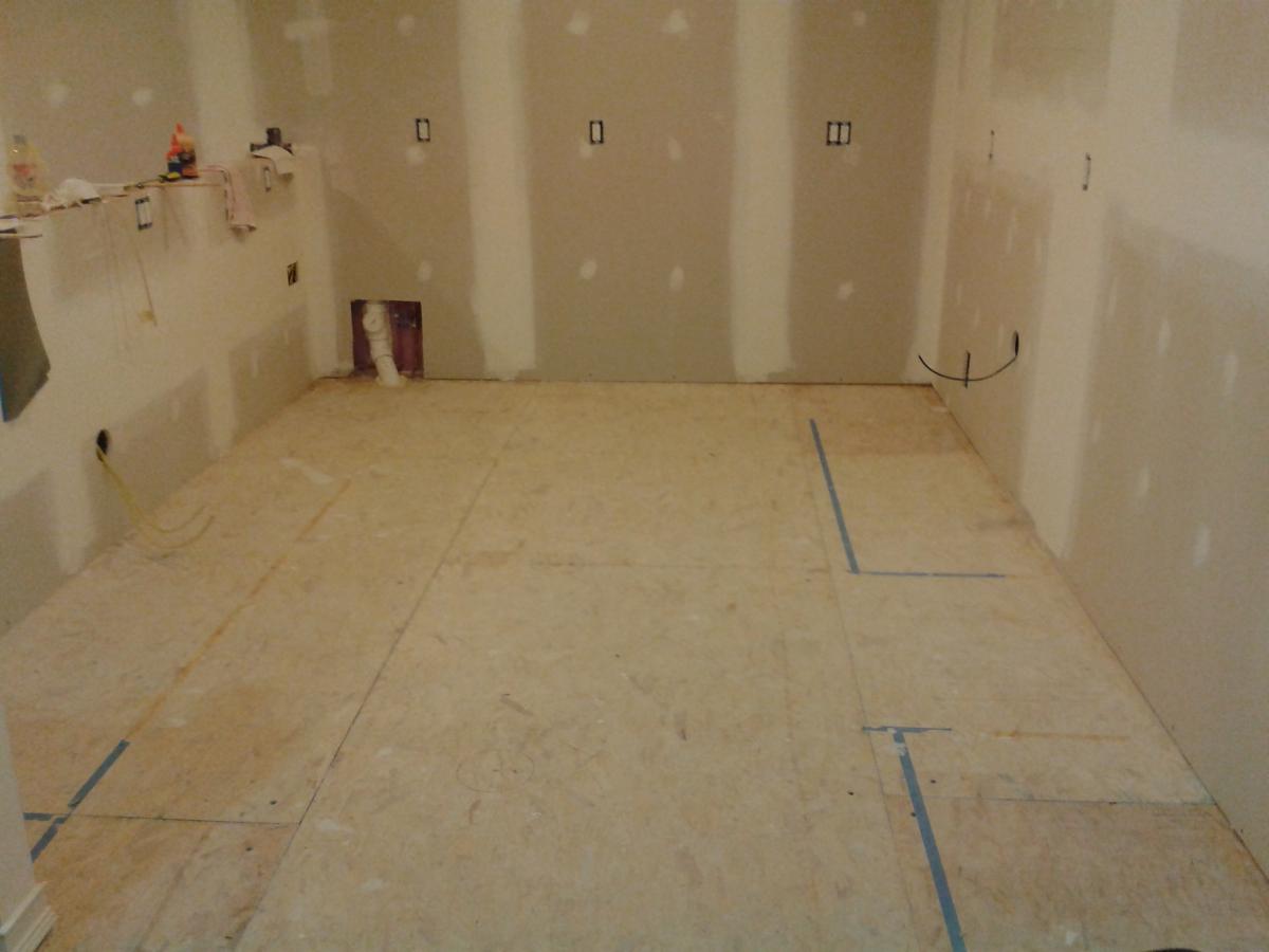

I added some underlayment to raise the finished floor height so the transition from the carpeted section to the bar floor is smooth.

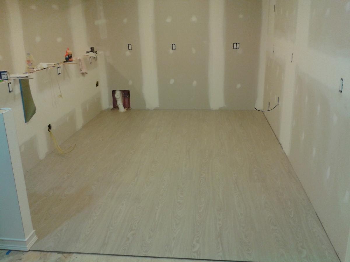

The flooring is an Allure click lock product. Super easy to install.

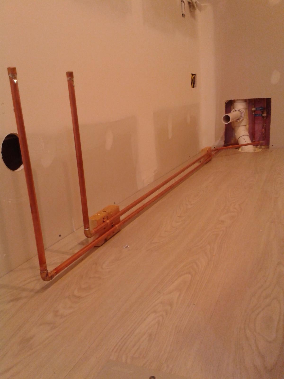

I ran the water supply under the toe kicks of the base cabinets and tied the waste into one of the main stacks. I used a threaded male adapter and coupled the run so it can be removed to meet code.
Cabinets going in… I practically had to rebuild the corner cabinet in order to meet plumbing code access for the plumbing stack cleanout.

Big ass TV and done.

Great job. How did you like working with the Dirta, it is great stuff but it can be a pain in the ass to install.
I have been using Ditra for some time now. In fact my Home Depot stocks it now.
Sometimes it can curl up on you but a well placed board and tool bag can go a long way.
It is a great product and I have never had longevity issues with it.

The Kerdi Shower System is a great product. It is a huge time saver and makes the shower completely water proof. It is practically fool proof too.
The pans are all pre-pitched and come in different sizes. If you can build the shower stall to fit one of their pans you will be in good shape. If you can’t I would advise you to buy a bigger pan and scale it down to your size so the pitch stays consistent around the perimeter. The best part about the drain is that you don’t need weep holes.
Once you go Shluter you wont go back.

Quality work right there..loving the shower floor!
