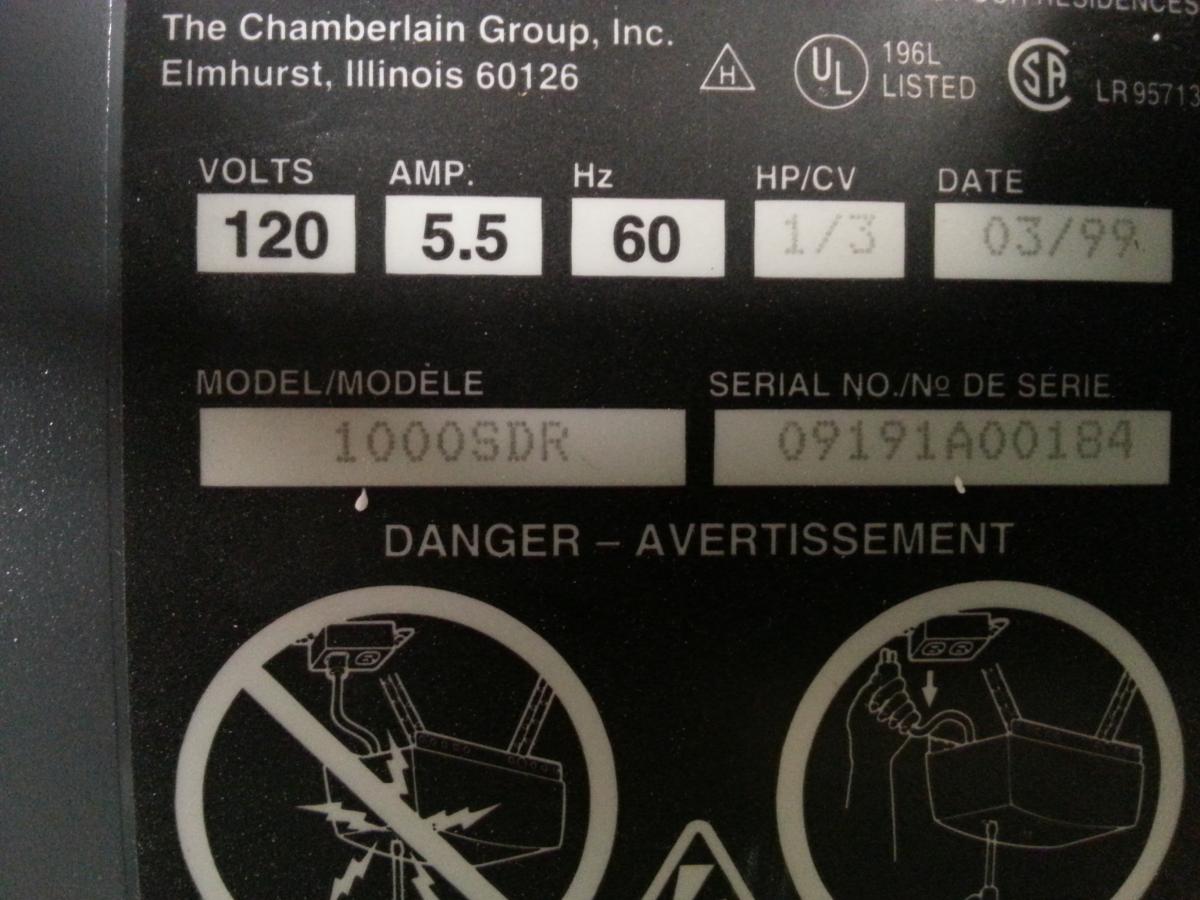

1: the model number is is “1000SDR”
2: The label on the opener dates it to “99 the remotes were the same age and the replacement was brand new at HD and would not work either

Here is the user manual for your opener. http://www.liftmaster.com/CatalogResourcesV3/en-us/shared/files/tucmanuals/A2094M.pdf
First check the lock feature. If the door push bar is flashing, your lockout is active: Press and hold the the push bar for 2 sec. The bar will flash for as long as the lockout is active. Push and hold for another 2 sec and the flashing will stop, lock disabled. (Page 28)
If that does not work, you need to reprogram your remote. First clear all the old codes out. Press and hold the “smart” button on the opener unit until the indicator light goes out. (6 sec)
To program a remote, press and hold one of the buttons on your remote. Don’t let it go,
Then, press and release the smart button on the garage opener unit.. The indicator lights on the opener unit will begin to blink, when your remote is paired the lights will flash, after the light flashes ones.. You can let go of the remote button. The remote is now programmed, test it and program any other remotes. (P29)
