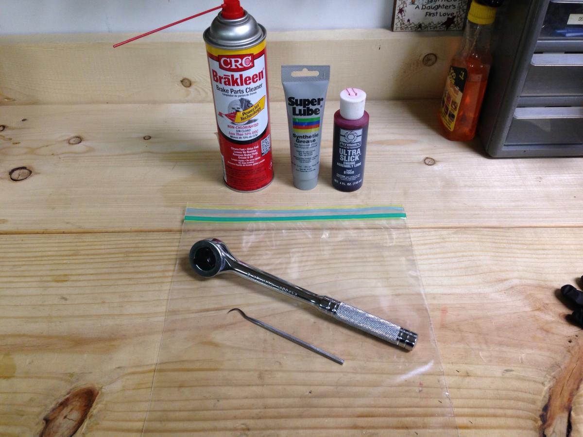

What you need:
A pick of some sort
A freezer/sandwich bag
Brake Cleaner
Lube of your choice
Any kind of pic will do. I use dental picks I got at Harbor Freight for under $5. As for lube, it really doesn’t matter. I use either SuperLube or Permatex Ultra Slick Engine Assembly lube part # 81950 (Often referred to on tool forums as RLL or Red Lube of Love). HF carries SuperLube whereas I typically order the RLL online. Either typically runs under $5 a bottle.

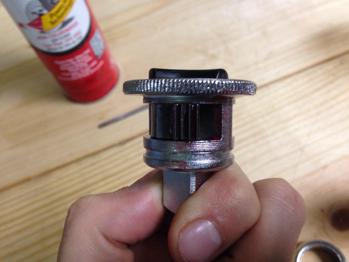

One the ring is out, insert the ratchet into the freezer bag, then pull the gear assembly unit out. The bag is to catch any springs or bearings that might go flying. It isn’t nessecery on this particular ratchet, but it’s always a good idea the first time you take a particular ratchet apart. This ratchet has a 1 piece unit that comes out, but not all ratchets are this simple.

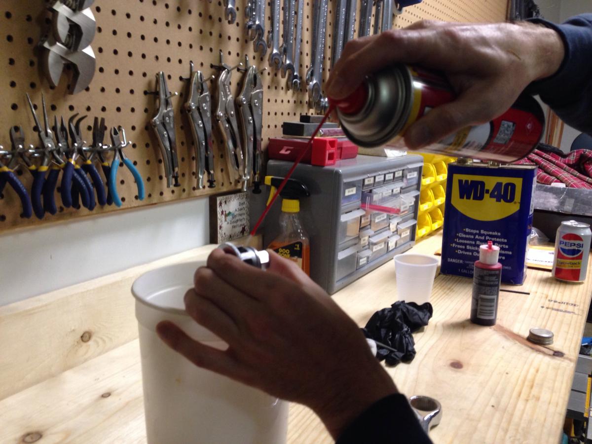

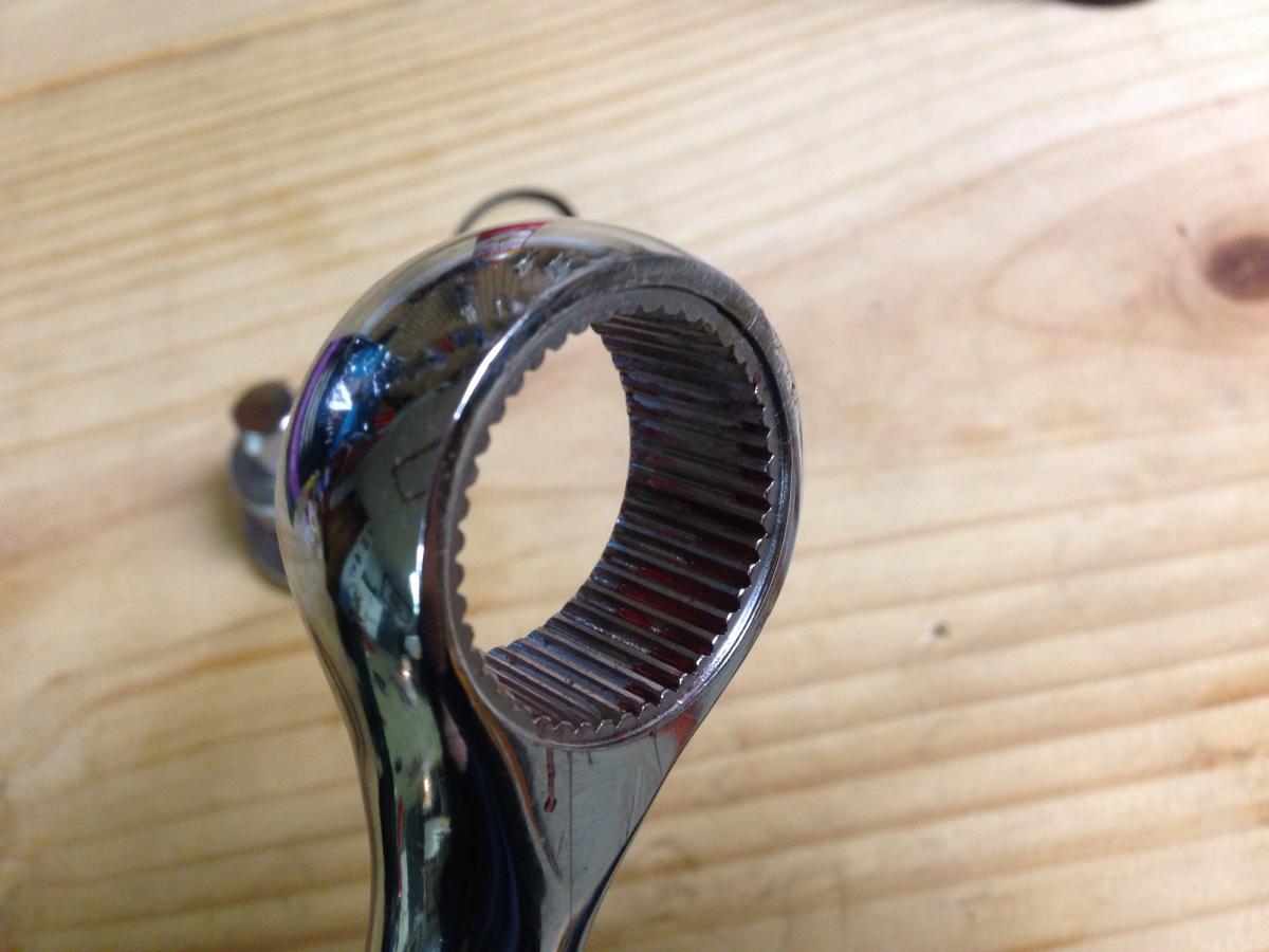

Using your pick or something similar, scrape any excess grease from the assembly as best you can. Once you’ve done that, follow up with you Brake Cleaner. Be sure to spray down inside the gear assembly thoroughly and inside the handle portion as well. This eliminates old crud and gives your new lube a slicker surface to work with.
Lubrication:
The RLL works best on these style ratchets. Putting a dab of RLL on your finger, rub it around both the outside of the gear assembly as well as the inside of the opening in the handle. Be conservative with the RLL. A little goes a long way. Also, put a dab down in each opening behind the pawls and work the pawl gently a couple of times with your finger. Now you should be ready to reassemble.
Reassembly:
Re-insert the gear assembly into the handle. This may require a slight turn or depressing of the pawl with your finger to get it to slide in. Once you’ve done that, all you have to do is work the retaining ring back on. This might take a little practice, but you’ll get it. Your ratchet should now be as good as new.
