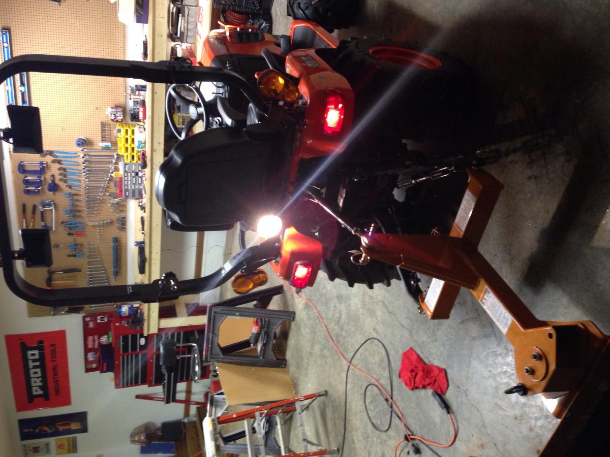

We went the next morning or so and picked up a work light kit for the rear and a driving light kit to mount forward facing from the roll bar. Over the last 2 days I’ve worked on it little by little. I didn’t snap as many pics as I’d have liked, but I did snap a few.

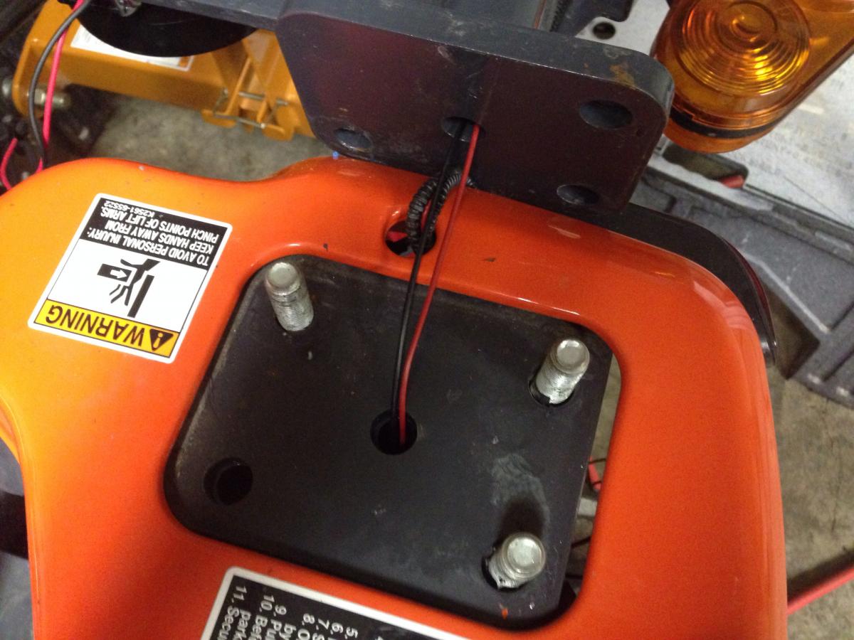

First I selected the location of the work light and drilled the mounting hole for it. I opted for an offset mount rather than center so as to not conflict with the stabilizer bar when in the up position. The metal is thick. I didn’t measure it, but I’m guessing it’s 5/16 or so, and while it provided an excellent mounting platform, it took a minute or 5 to drill. I used my M18 drill, Craftsman Pro Cobalt bits, on lots of cutting fluid. Low and slow the drill performed flawlessly as it always does, the bits….don’t waste $100 on them like I did. You can get far superior Norseman Super Premiums for the same money.

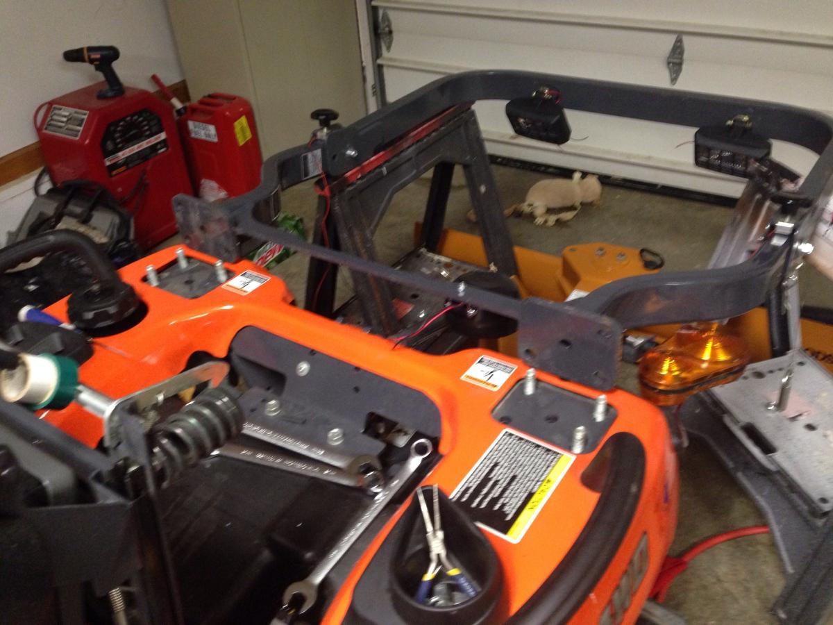

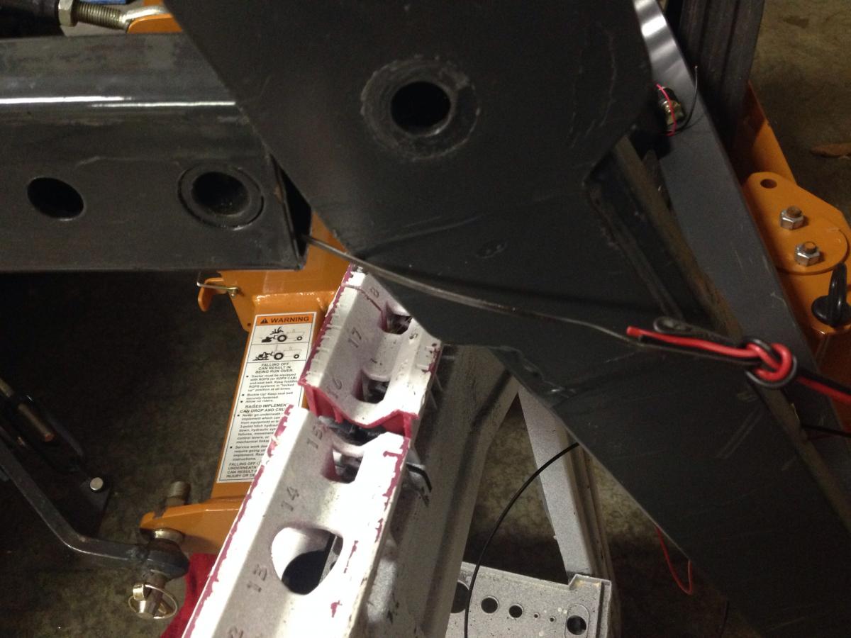

I watched a few YouTube videos to see what others were doing with this. I found all manner of people mounting lights like me, but most just ran the wires down the roll bar, exposed on the outside, and some even put their switches in a box on the bar. Sure, that makes it easy, but it also looks like dog shit and tells me they’re lazy. Conductor does shit right the first time so he doesn’t have to do it again. I pulled the roll bar off and fished the wires down through the fender like everyone should. I don’t like to half ass anything, especially not on a $16,000 machine.
The only way to fish the wires effectively was to break the ROPS completely down. A little more time consuming, but worth it IMO

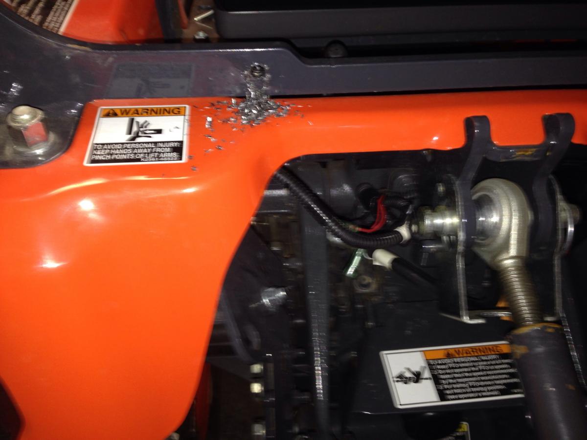

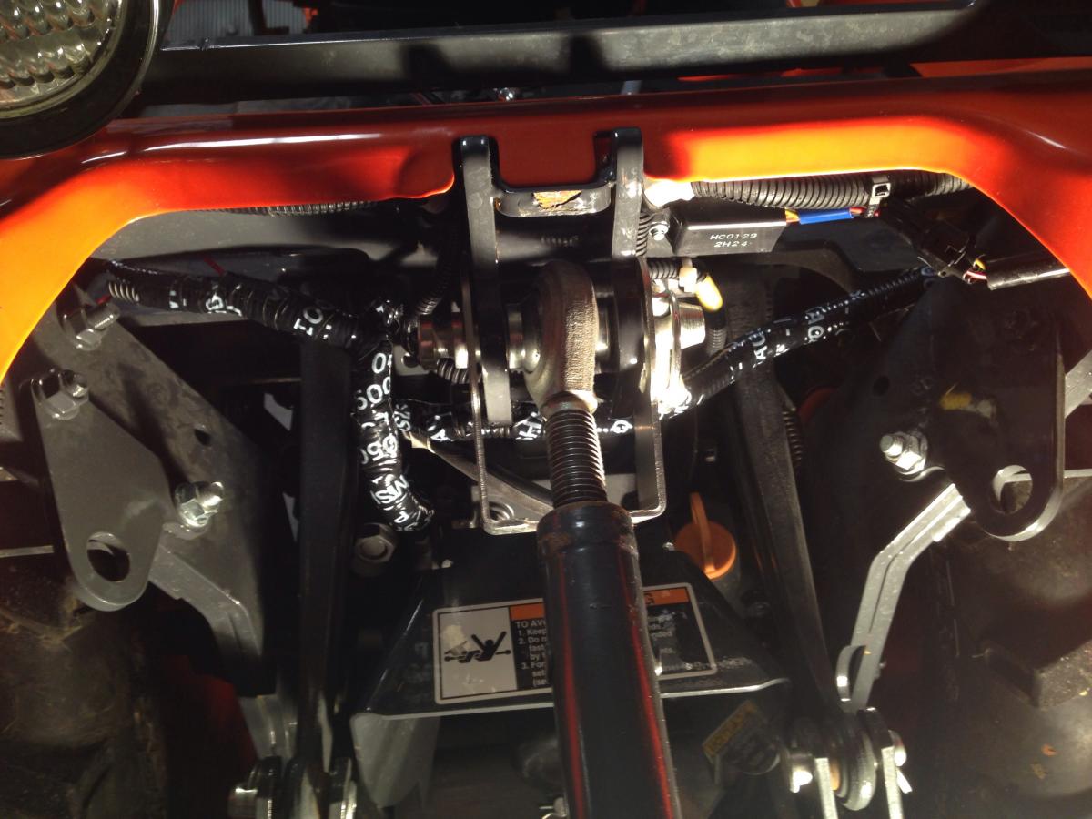

There were a couple of things that made this project easier. If you notice in the first pic, it was pre-wired from the factory with a 20amp accessory hook up. That alone saved me at least an hours work running it to the battery and allowed me to bypass using an inline fuse that I’d have to dig out if it ever blew. 20 amps is plenty for 3 55W lights. The other blessing was the presence of the hole in the ROPS mounting plate. Drilling them would have been another 20 minutes or so.

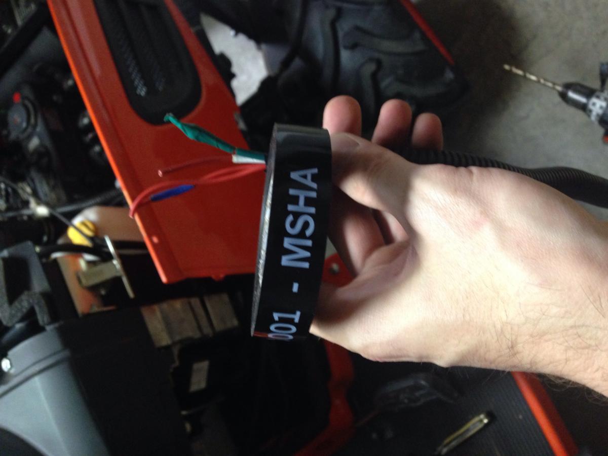

Duct tape is the mark of true redneck workmanship. Another staple item in the redneck shop is MSHA approved electrical tape which you can easily identify by the white lettering on it. Besides being awesome, heavy duty, tape that was unknowingly provided free of charge by Peabody Coal, it makes identifying the auxiliary lighting wire jacket easy if the need to service should ever arise.

I was very careful to wrap all the wires in the tubing and wrap them good in my “borrowed” MSHA tape. The lettering doesn’t look the best, but it’s damn good tape and easy to identify.

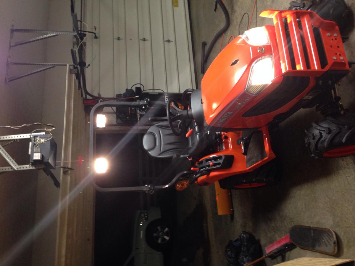

Finally, the moment of truth. I flipped the switches and the lights came on.
I pulled it outside to line everything up and I was amazed at the difference.

Total cost for the project was a hair over $100. I could have shaved that down, but I’m not the type to cut corners. I had about 8 hours invested in it, but a lot of that was due to pulling the ROPS apart by myself. I’m happy with how it turned out though.

1. The BX Series comes prewired with 2 hot accessory wires tucked into the factory wire cover just above where the stabilizer bar connects to the tractor (mine were slightly left of it, but that likely varies). One is red with a blue stripe and the other is red with a black stripe IIRC. One of them is perpetually hot meaning you can use that light with or without the ignition switch on while the other is wired throughout the ignition switch. I don’t remember which was which, but circuit tester will easily identify it. I wired my accessory light to the perpetual hot so I could use it to hook/unhook implements or whatever in the dark with the tractor off.
2. I did not use an inline fuse. Being factory wires, they are fused in the fuse box (20 amp Mini Buss) on the left hand side of the tractor (from sitting position) under the dash. No soldering necessary and super easy.
3. Yes, both lights have a switch leg running to the switches I installed which are pictured above. I bought the wiring jacket to cover the wires and wrapped it in with the factory runs of wires that runs from the rear to under the dash. I used the distinctive MSHA tape to be able to easily distinguish them from factory wires in the future.
4. No, see answer 2.
