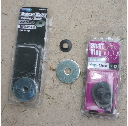

The Problem (Ryobi One+ 18V 33cm Cordless Lawn Mower Wheel / Wheels come off)
The solution

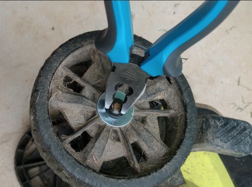

The procedure (clean out groove in end of shaft, place washer, place shaft ring, strike pliers with heal of palm or tap with hammer)

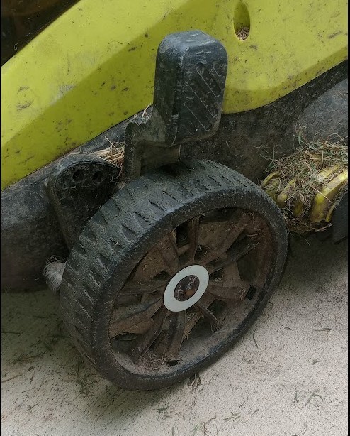

Our mighty machine is reborn. Let’s cut some grass!
Sweet, thanks for sharing.  Nice fix.
