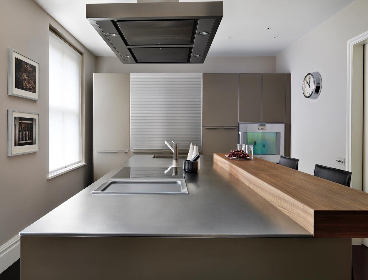

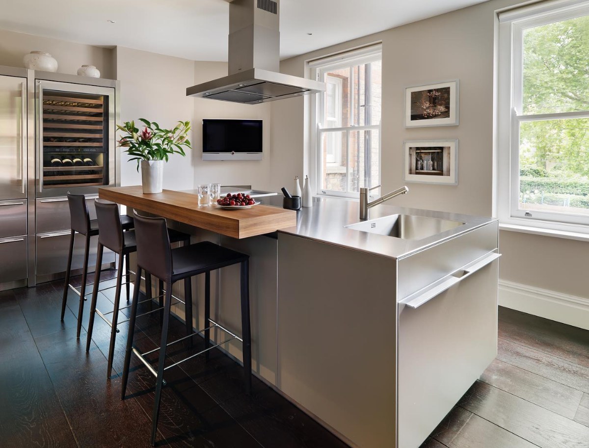

As you can see in these photos the sink is welded to the worktop and I am thinking of having the stainless steel cooker hub welded to the worktop as well. I have seen AEG makes stainless steel cooker hub. So no silicone used around the sink and cooker hub.
Polish won’t remove the scratches.
Sanding (w/ appropriate grit) as an attempt to recreate the original “grain” pattern will have limited success, except in corners where that is not possible to access. The initial “grain” was done by machines, repair / rework will be done by hand. The repair will have slight random angular differences that will be visually evident.
The brand new stainless looks great in pictures though.
Agree looks awesome but after a while the scratches will come through.  Looks great
