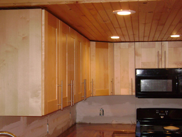

start of the rebuild
[External image (i856.photobucket.com), not copied]

As for me and my son we put his Ikea cabinets together most of this afternoon. Hope to get the T&G pine ceiling done Monday

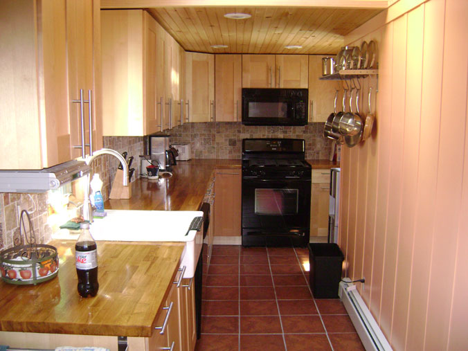

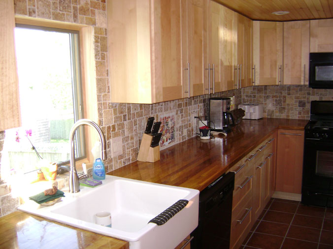

We are coming down to the end
even Jason’s step mother is pitching in
Photo from the original forum Photo from the original forum

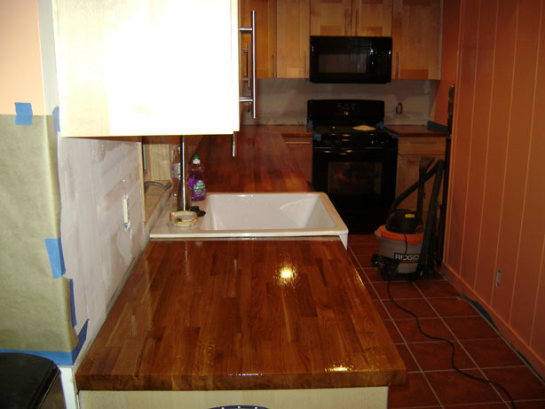

Just some trim and a back splash
Photo from the original forum Photo from the original forum Photo from the original forum
Looks great. Did you make the cabinets?
No Ikea
Wow that looks awesome.  Is the counter top Ikea also?  That kitchen is night and day from before.
The counter tops are from Ikea they have 4 coats of waterlox
Wow! What a turnaround. Looking great man.

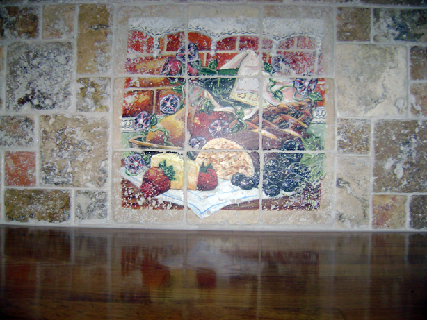

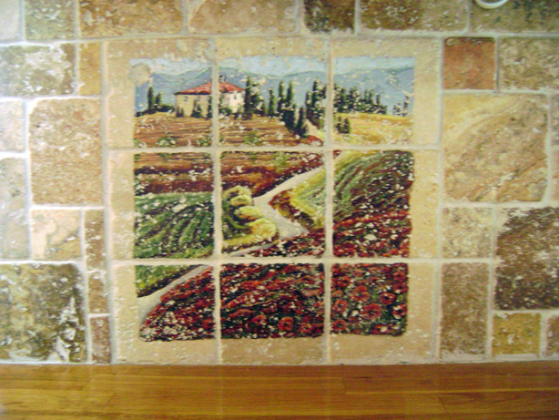

Sunday afternoon I, Jason and his wife headed out in the middle of a snowstorm to pick out his backsplash at the HD.  After about a half hour, he and his wife had it down to 2 or 3 tiles.  Jason’s mom passed away from cancer when he was 12 and when I told him if you pick the tumbled marble I have some hand panted tiles your mom did you can place in the field. That made for a fast decision. When I stopped by this week to see how far long he was, he had the backsplash in and it turned out nice for his first tile job. Now he has some more painting and trim to finish up.
The best thing about this whole job is for the first time in 18 years Jason started to talk about his mom and asking questions about her.
Photo from the original forum Photo from the original forum Photo from the original forum Photo from the original forum Photo from the original forum
Love everything you’ve done. Very clean and professional
Very nice looking!! Looks great!! Also touching. I too lost my mom from cancer.
Looks great. Nice for him to have something from his mom in the house.
