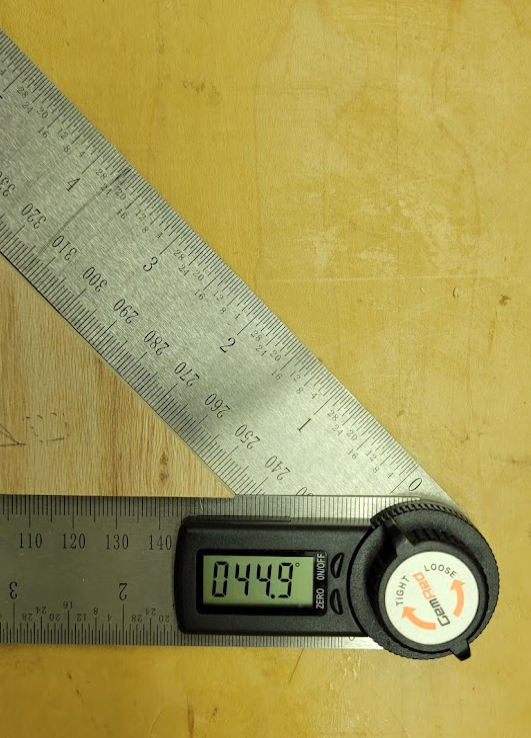

One other note: unlike some miter saws, there is no option to unscrew and move the detent plate… see pic below.  (not to mention that it is 0.1º short both ways, so turning wouldn’t help).
It looks like the slots have tapered sides.
The mating detent probably also has tapered sides.
Could careful application of a file on the appropriate side(s) of the slots (possibly also on the detent) cause the resting position to shift slightly, with the spring loaded detent sitting higher in the slots?
PM222Member since Sep 2021
Yep – that’s where I was going to go. Just wondering if I was missing a simpler and less destructive option.
