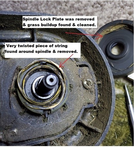

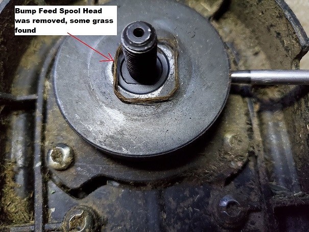

2.  Cleaned trimmer from all debris.  Removed Spool trimmer head. Found a spec gra  When I removed the Spindle Lock Plate, found a very twisted piece of string & grass debris. Removed. Reassembled trimmer, inserted battery, no action.
3. Google search found that many have experienced problems with this trimmer within few months.  Many replaced the DeWalt bumper trim head with a Husqvarna T35, with success.  We ordered part, installed & hopes for it to have solved problem ~~ fizzled ~~.  Unit would not start.

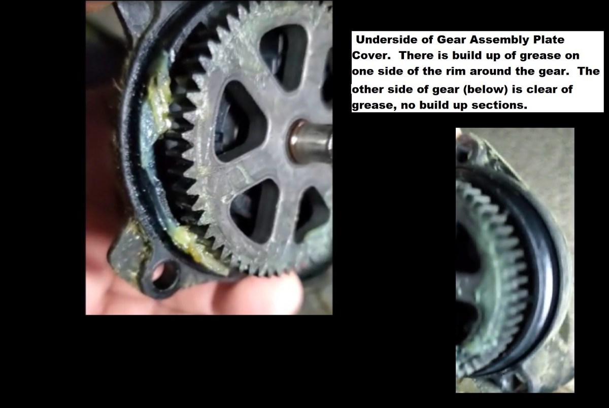

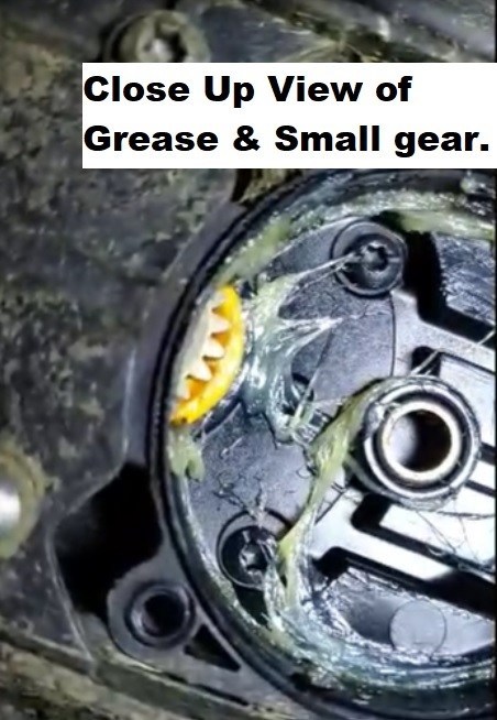

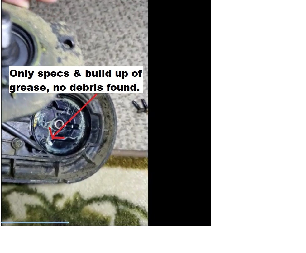

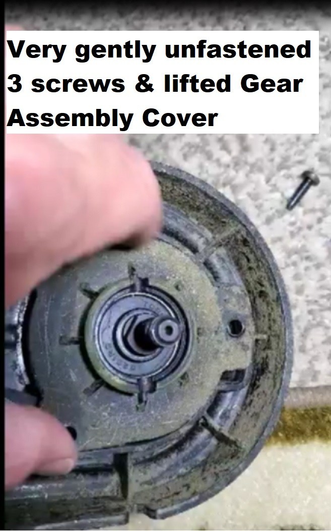

4. More google search, suggested removing Guard Assembly and just the cover of the Gear Case Assembly, blow out any debris found.  Very little grass found was blown out.  However, areas of grease buildup on gears & other areas grease free.  Is that a sign of something? like over heating?  We did not explore further. Reassembled, and trimmer did not start.

See pics below.  How does one determine that motor is problem?
