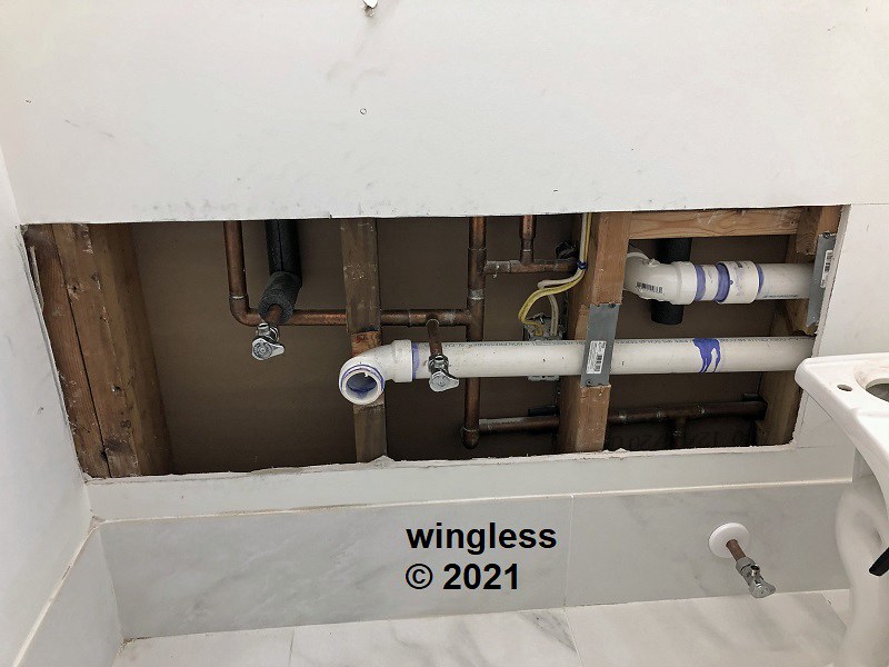

The bathroom was completed, the kitchen cabinets installed and the countertop company installed new quartz w/ a sink so I could finally install the disposal and faucet.
Unfortunately the “professional” plumber that cut the slab and replaced the drains, not only installed the bathroom vanity drain too low, they also put the kitchen drain too high, both by a lot.
The only solution was to remove the bathroom vanity, cut the wall and transpose the drains, making the kitchen lower and the bathroom higher. It was impossible to service from the kitchen side w/o destroying the brand new countertop and removing the cabinets.
The kitchen drains were “cheated” as much as possible because even with this fix it is still higher than I wanted / needed, making the disposal drain horizontal to the tee, instead of attaining the correct slope. It works okay.
A complete fix would have been to dismantle the new stack, going up through the roof, but that would have been a VERY extensive rework, removing lots of the bathroom wall and playing w/ the roof flashing, just to improve / correct the slope from the disposal (not gonna happen).
All was implemented, the bathroom wall replaced, patched and painted.

All of the 1½” or 2″ Schedule 40 PVC drain plumbing was routed after OMT or drill cutting, or demolition hammer for concrete cutting.
