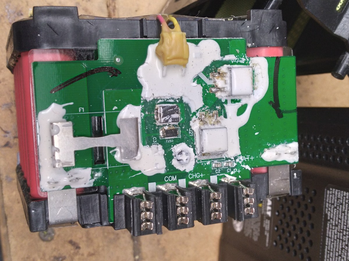

I have a separate issue with two 5.0Ah 60v.  Twice I’ve had these batteries quit on me when the mower is pushing through taller grass.  Both times I’ve cracked open the case to find the metal piece on the board snapped.  I assume this is there for protection (not an engineer, but enjoy taking things apart).  Could a fuse not have been used?
Is this repairable with a weld or replacement part?  Would love to get these batteries back in the mix.
Pictures here, good battery on the left.  Appreciate the guidance!
https://photos.app.goo.gl/oLdxUTsK3V3Jod419
Great question.  Not sure but someone should jump on and let you know.  That is weird that would happen.  I am guessing it’s some overload but doesn’t seem right that it would be internal like that.

I had a fault where one of the connections on the opposite end to the led arrangement had failed.  It happened while I was using it and I think it was likely a poor connection to begin with and under a high load condition it has let go completely.  In my case the fuse link that Collins showed was still good and I accidently put pressure on the failed connection when the battery was upside down and resting on the test button.  It started to light up as I was poking around and led to me to the dodgy connection.  Soldered back on and good as new.
The symptoms in my case was that it would not operate the trimmer or show any charge with the test button.  It also tried briefly to charge and then would cut out suddenly.

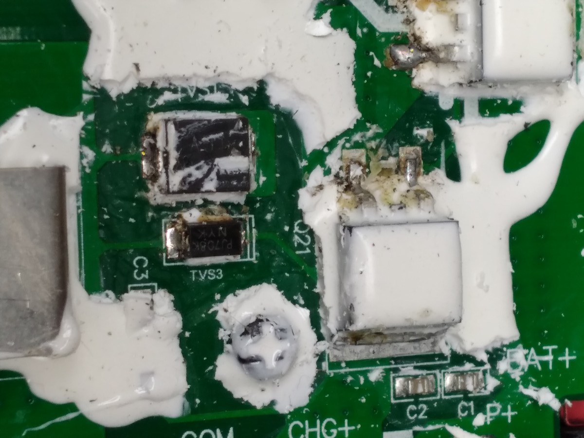

hey morning did you ever figured out what the problem was on the bms boards?  now kobalt, greenworks and briggs & stratton are basicly the same.  i’m working on a kobalt 80v and i swap a good bms with what i thought was a bad bms turned out the bms wasn’t the problem.  its the back board which connects to your tool or charger. i think i found the problem in the  TVS3 # PK708K NYK.  not getting any reading on the multimeter either way.  i made sure the solder connection were cut and resoldered and still nothing.  i will try to replaced it but hard to do with 1 half-axx hand and the other blowing in the wind.  in other words disabled.  i hope i’m right.  we’ll see in about a month from now.
