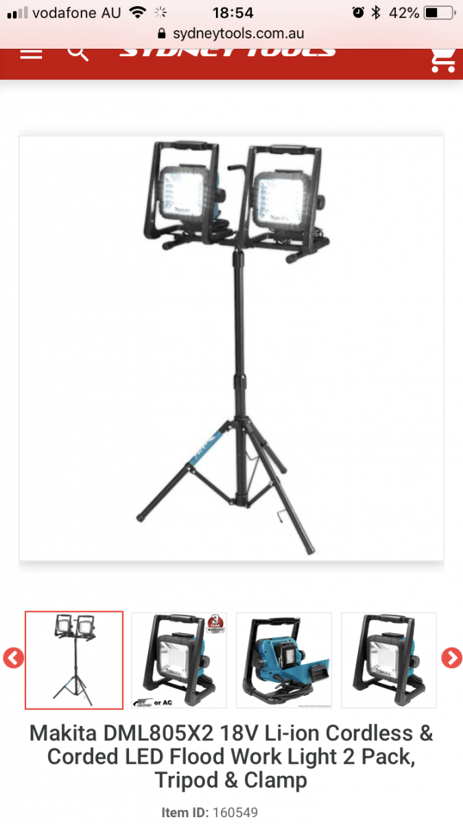

Why does it seem like Makita is lacking lighting options?  Milwaukee and Dewalt have the rocket style lights. I’ve seen the Milwaukee lights in action and they are insanely bright and I saw a video on YouTube comparing the rocket light to the Makita light and stand and the Milwaukee blows the Makita out of the water. So do you think Makita will step up their game and add a light like these?

As mentioned, Makita don’t play keeping up with the Jones. However the lighting products I own from Milwaukee are built like shit compared to the one’s I’ve used from Makita.
Milwaukee lighting is pretty much all I use on site currently as it does exactly what I need it to, but it was expensive, it’s not the most robust equipment and I’ve had to do repairs on it and I’m worried it’s going to break down on me well before it should. Flashy doesn’t always mean good.

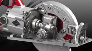

Worm drive gearing has a much higher reduction rate than hypoid gearing (in most saws at least), this in turn means motors can be lacking in torque while requiring a much higher running speed compared to a hypoid.
However the DeWalt is a offset/spur drive. The term worm drive was simply used to describe the body style borrowed from skil and many have taken that to mean it’s gearing is also the same.

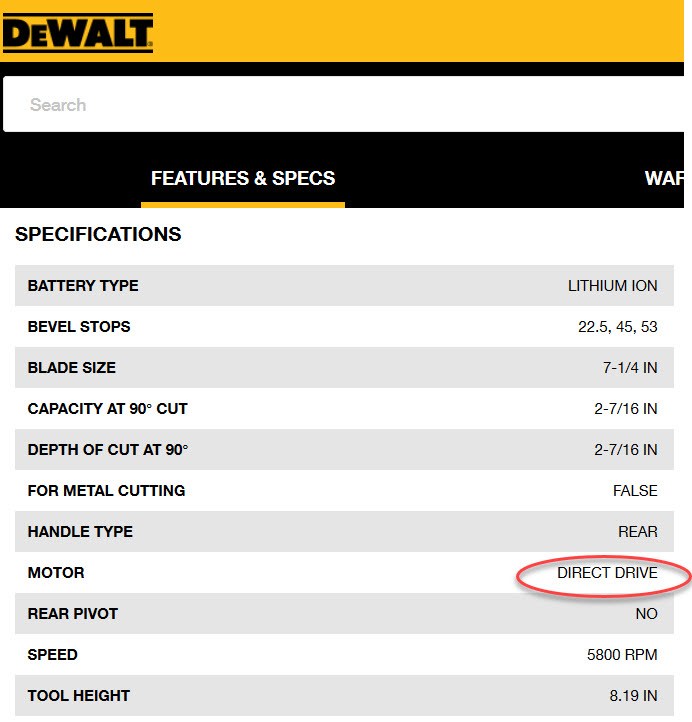

Wait how do we know the Dewalt is hypoid as well? They seem to have pulled one over on some reviewers if that’s the case. But it had not escaped me that Dewalt consistently refers to it as “wormdrive style” on their homepage without any further disclosure or clarification. A real wormdrive would have justified more bragging rights in the eyes of some customers.
Shame, Dewalt
Shame

Exactly that. Calling it styled like is the get out clause. The dead give-away is the motor positioning.

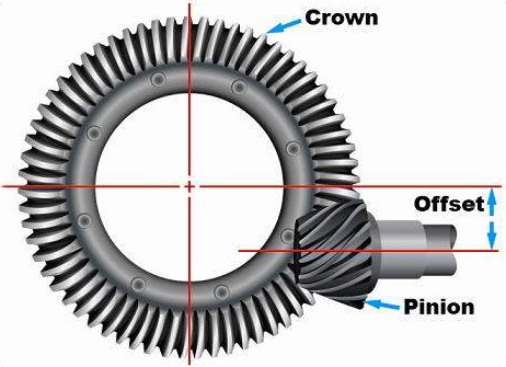

It’s not actually a hypoid saw either (foolishly, I called it one, but it’s not), it’s an offset drive spur/gear. A hypoid acts much like a worm drive however it’s a spiral cut offset gear mounted 90deg to a face/crown drive.

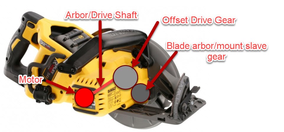

Just found this:
The motor seems clearly off set from the center of the blade no ?

That’s correct, as I’ve illustrated.
