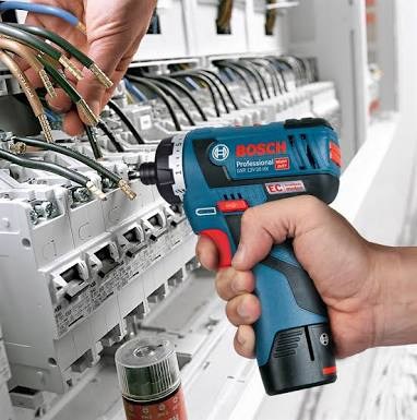

Some reviews and online videos mention that it can take 25mm bits. Bosch even has this photo on their website. It’s misleading. The chuck is too deep for them.
That’s indeed rather misleading id say
I don’t think 25mm bits exist that have the bigger indent right ? 🙂

No as far as I know they don’t, but I’m talking about the small thin grooves that are usually on each of the 6 corners of a 25mm hex bit. Different to the longer bits with the single large indent that goes all the way around.
This is apparently supposed to hold both types, and the locking pin/ball bearing inside the chuck is positioned in one of the corners so it does hold the 25mm bits, just like in the photo, but you can’t put too much pressure on the bit or it will slip and go deeper into the chuck.
I just looked up the user manual and it states that “One inch bits should only be used along with a bit holder”.
I guess that’s the answer. But there’s more photos:
Those small grooves ( as far as I know ) where never meant to be held in the hex bit holder.
I think Bosch marketing with their pictures got Abit out of hand :/

Thanks Korno.
The chuck on the ps22 is strange. It’s much deeper than the impact drivers I’ve used. Actually, that era for Bosch is strange (bad ergonomics on 18V grips and no rubber over mold for example).
A 30mm or 35mm bit would be needed to work like the ones in the photos above.

Also, mine does work as expected with 25mm bits. The chuck is just deep enough to hold them about the same is a bit holder or just like the Bosch images.
I have a ps42 impact I got from Korea a few years ago and it’s chuck is as you describe, being a little too deep.
