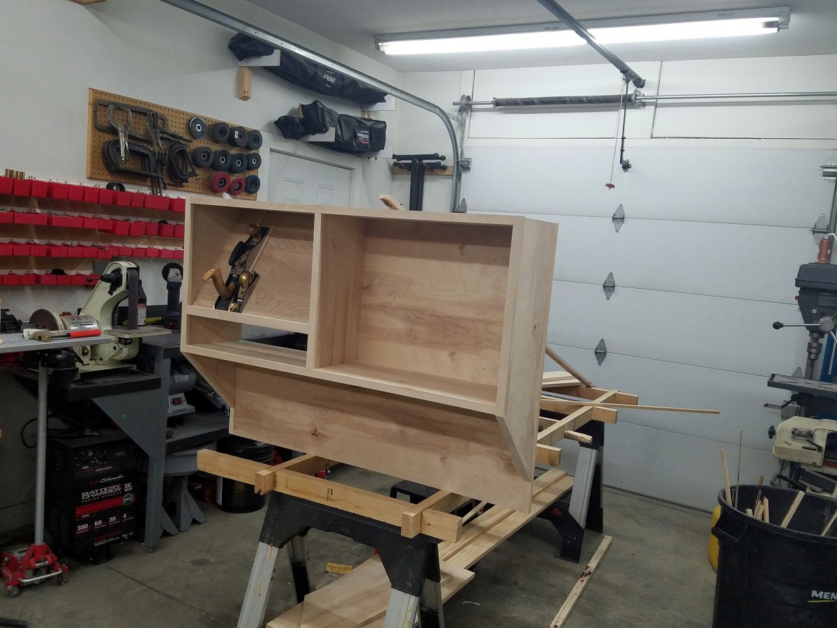

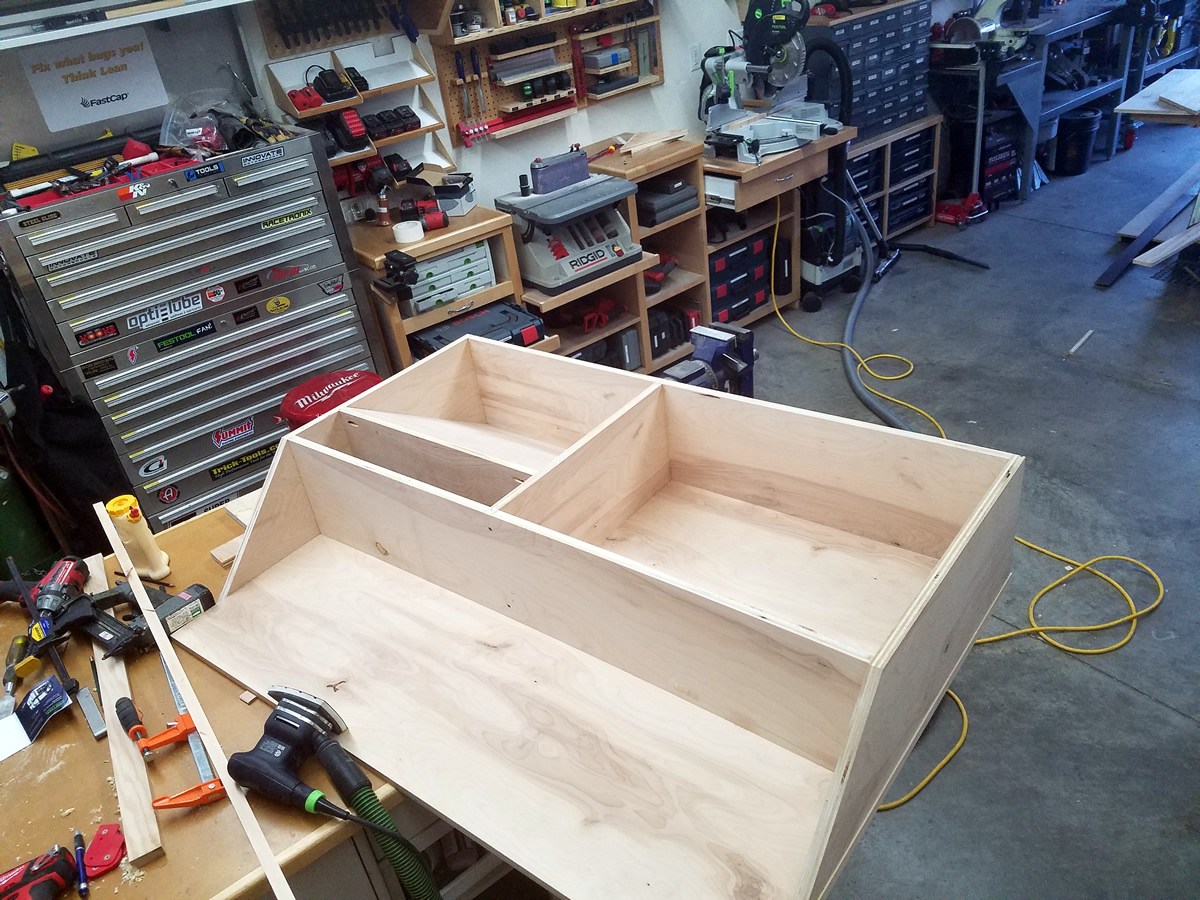

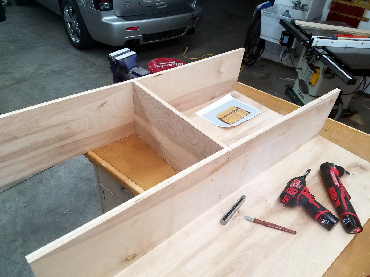

Little assembly today.
Have to say, I am liking this new Domino. Going to change how I build things 🙂
This is the clamp and miter saw rail rack.

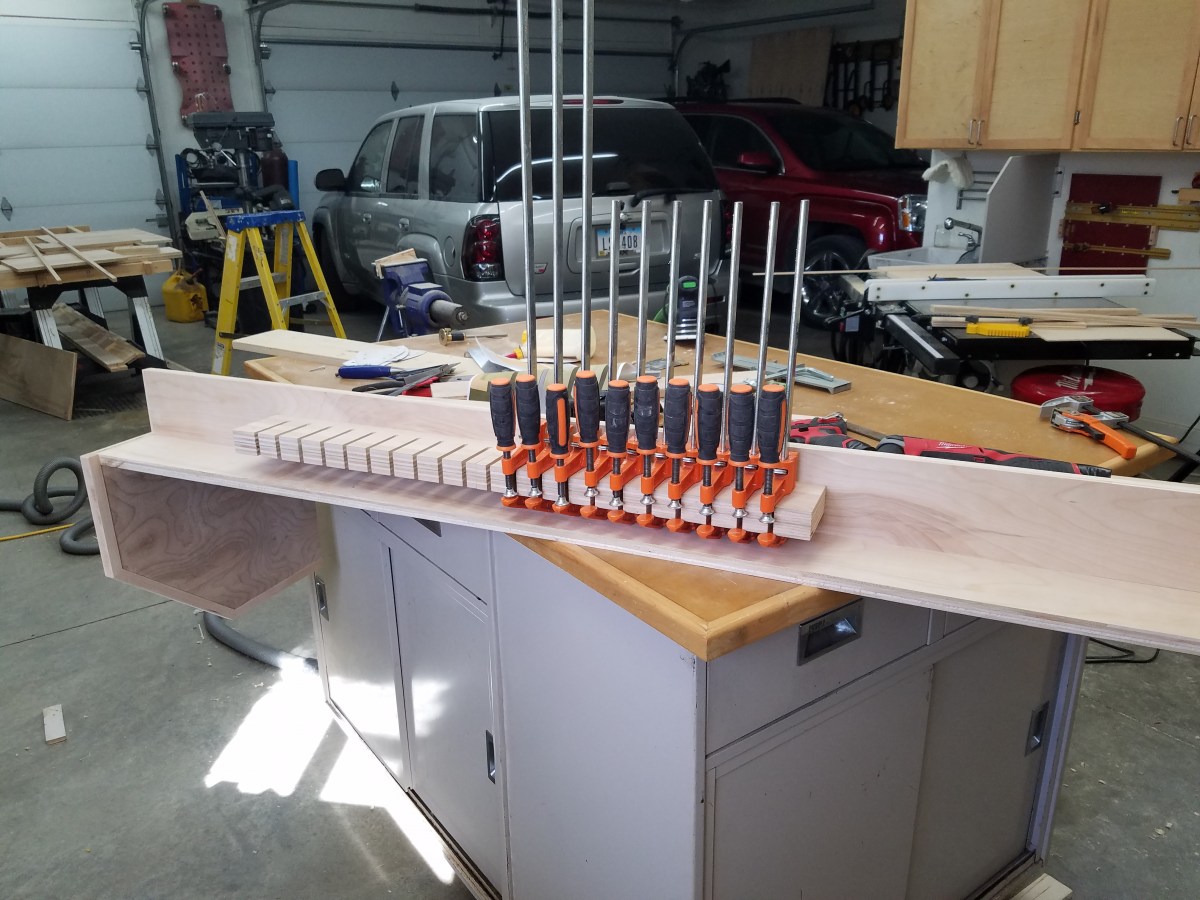

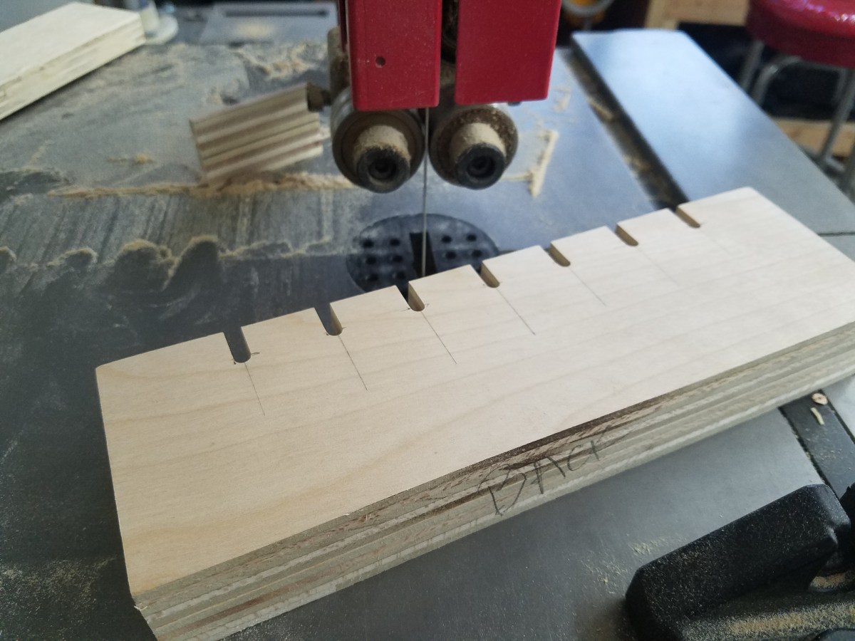

Just finished cutting the last of the fingers. This set is for the smaller Irwin Quick Grips. Did a dry assembly and need to route a 1/4 round on top edge and can give it a final sand and apply polyurethane.  Then will move on to wall tool cabinet.

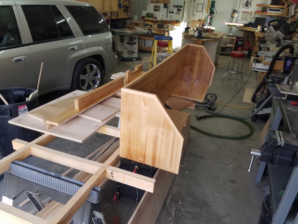

Now for my least favorite part.
coming along good, what is that good wood doing in the trash can?
rrmccabeMember since Jan 2017
Scrap I used on back edge of boards while cutting to prevent tear-out.  Not much left of it. All cut up.

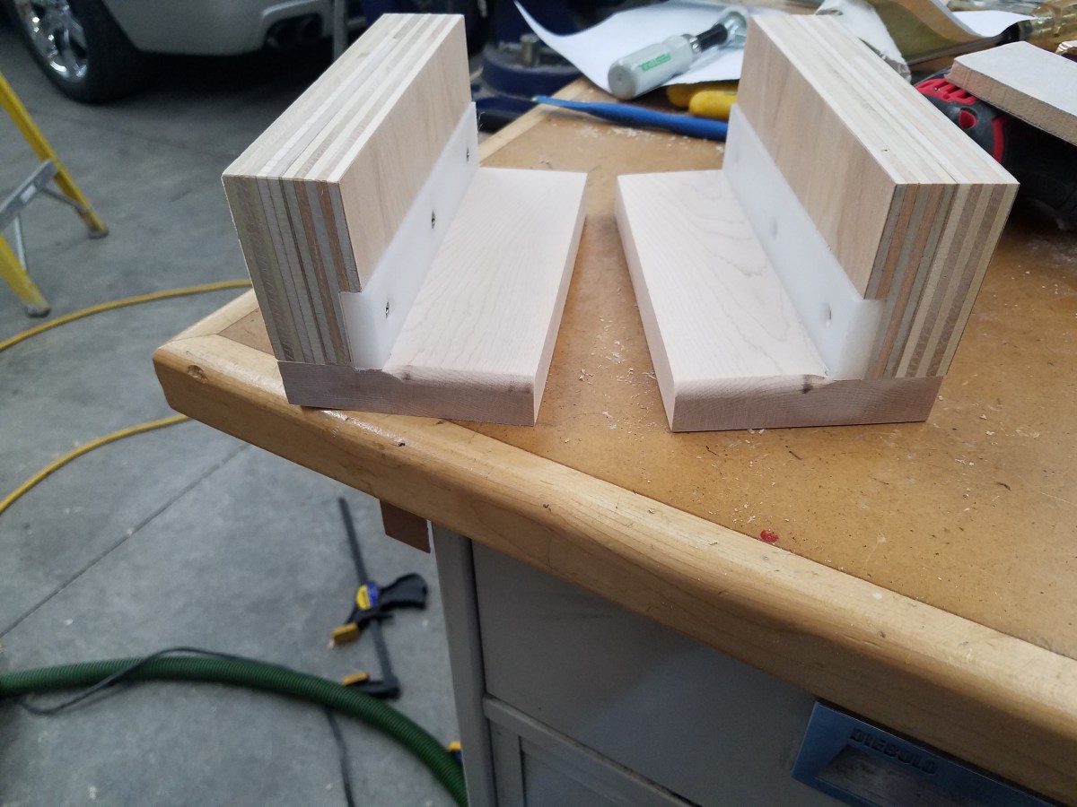

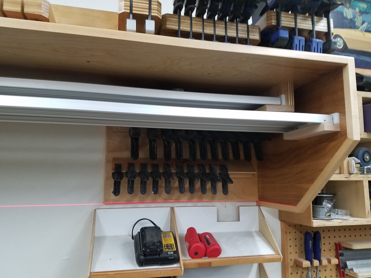

Made some brackets with UHMW on the sides to hold the FastCap Rails for my miter saw and got the clamp rack mounted to wall. Have to polyurethane a couple mounts and it will be done.
Then can move on to tool cabinet.
khariVMember since Dec 2014
I like how you used the vertical space to store the clamps pointing up instead of the traditional, downward pointing clamp racks. However, I’m pretty sure that I couldn’t do the same because A. I’m probably not tall enough to reach over the top of the shelf and around / behind the clamps to undo the screws and B. sooner rather than later, I’d bonk myself on the head with one of those clamps putting it away or taking it down.
I have had my clamps in this spot for a while but have been just clamping them to a shelf.
The improvement this go around is that I do not have to unscrew them. They are not clamped to anything.  The blocks with fingers are placed at a height that captures the fixed head of clamp. So they  just slide in and cant tip because of the tight tolerance.  You will notice every type of clamps has a different finger block height.  The only exception to this is a couple odd clamps on far right which I do have clamped

Grizzly is closing Jorgensens out so ordered five 24″ clamps and six 6″ clamps to fill up my rack.  Similar price but cost me $18 freight.

The tool cabinet is going together. Screwing everything I can that does not show and using the Domino on the rest that does show.
Tonight  I should have the carcass together and can start working on the trim.

Time for trim. I am sure its going to take a lot of time making little maple mounts to hold all the saws, chisels, planes, marking gauges, etc.

Ran out to the Woodsmith store and picked up some maple dowel rods, screws, little project wood axles that might make good tool hangers and some finish.
So this weekend I can start the task of making tool mounts so I can hang chisels, saws, marking gauges, rulers, squares, etc. I am sure that will take longer than building the cabinet.
Off little early today.
So fun begins.
