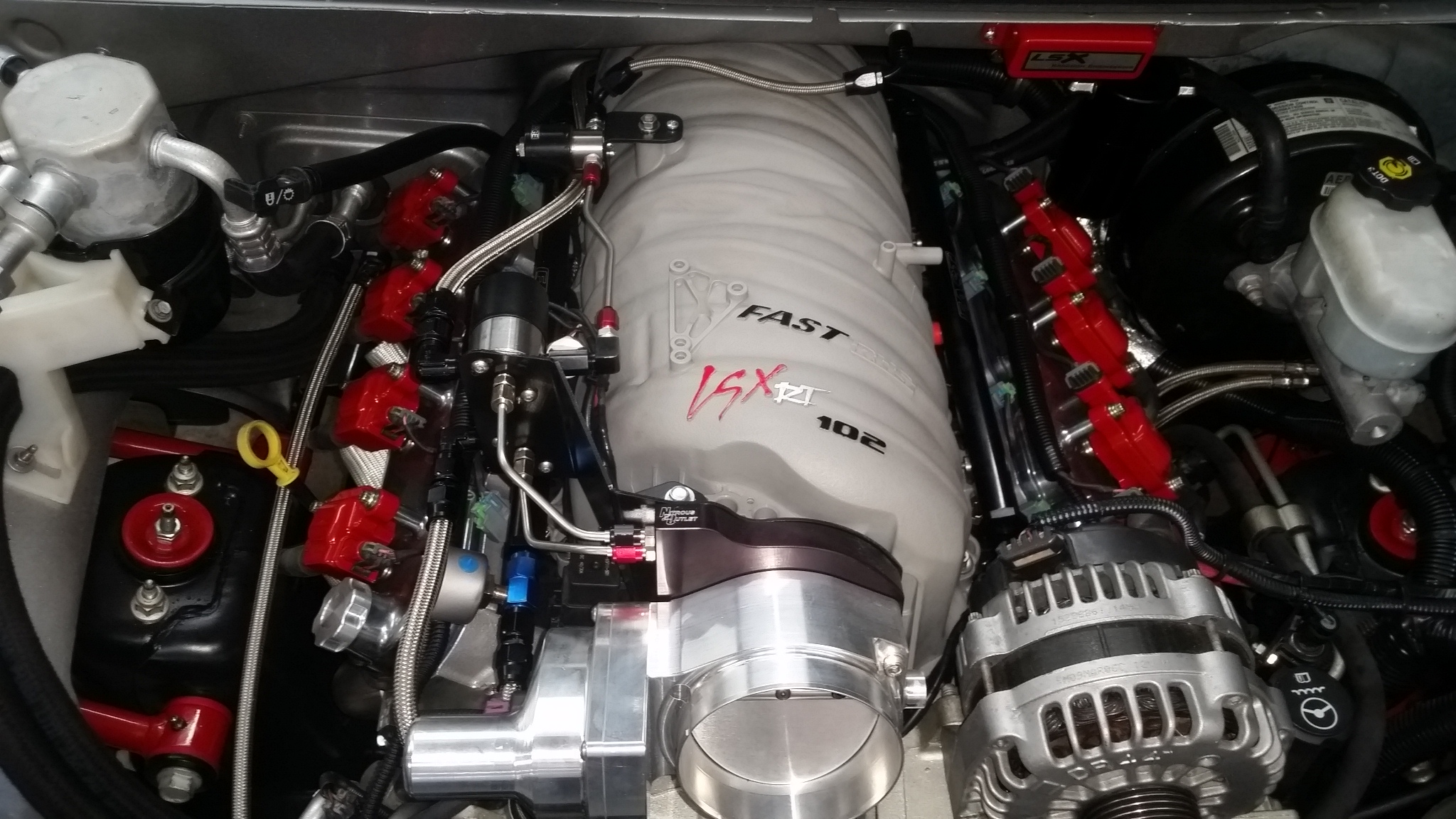

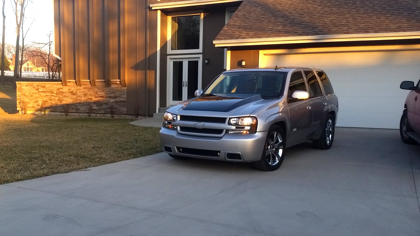

So a year ago I jerked the motor out, repainted the frame, inner fenders, firewall and cleaned everything up cosmetically. Had Texas Speed build a 650HP stroker motor and installed that. Added a carbon fiber hood, custom real valance that would allow dual quad tip exhaust and a few other things.
It now has about 34,000 miles on it but only sees about 3000 miles a year during the summer months.
Its AWD and first time on the dyno put almost 500hp to all 4 wheels without the nitrous. I expect it to make about 750HP to the wheels when I “flip the switch”. Maybe more.

Is that a stroker LSX or something else. The LSX is a crate engine GM sells which is a beast, the new 454. The logo is different than the LSX logo I’ve seen…but obviously work has been done to it.

Its a new 408 built by Texas Speed based on the LQ9 block. Callies crank, rods, etc
If you are talking about the LSX logo on the intake, That is the fast 102mm intake logo. Nothing to do with the motor build. Just the intake I chose. See link here
This motor is custom built from the ground up. Not a crate motor.

Thats what I figured, most people don’t even know the LSX motor exists because it’s super expensive…so a lot of people name stuff or call stuff LSX using X as either a placeholder for the engine designation number or a name of a product for LS engines.
