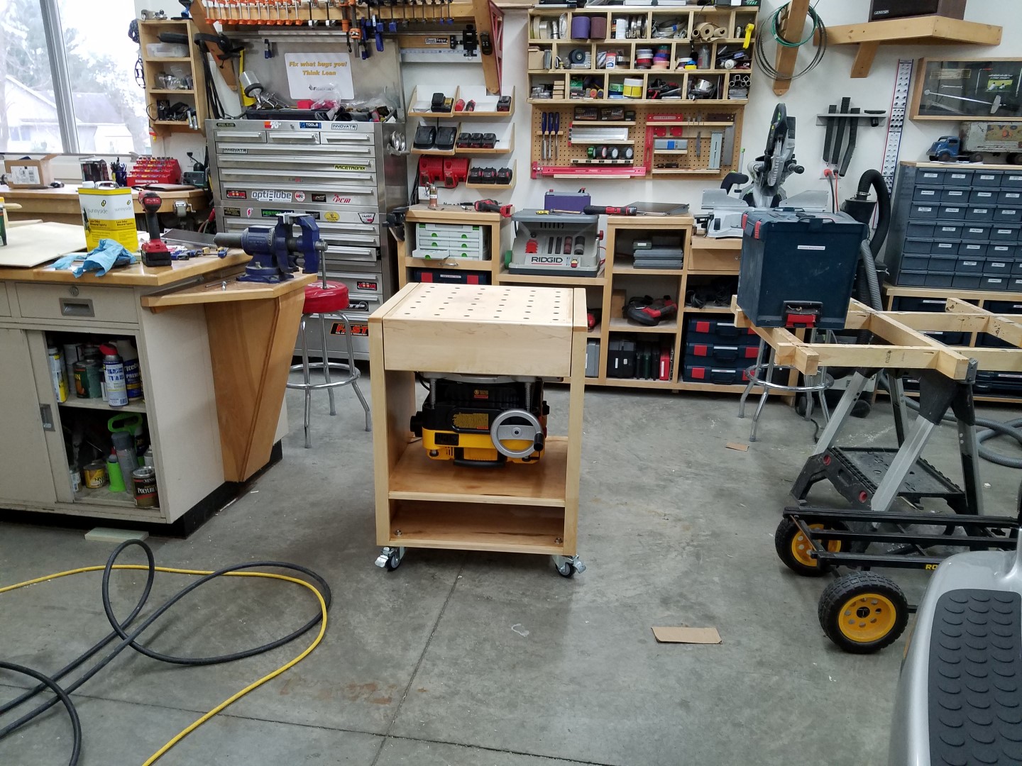

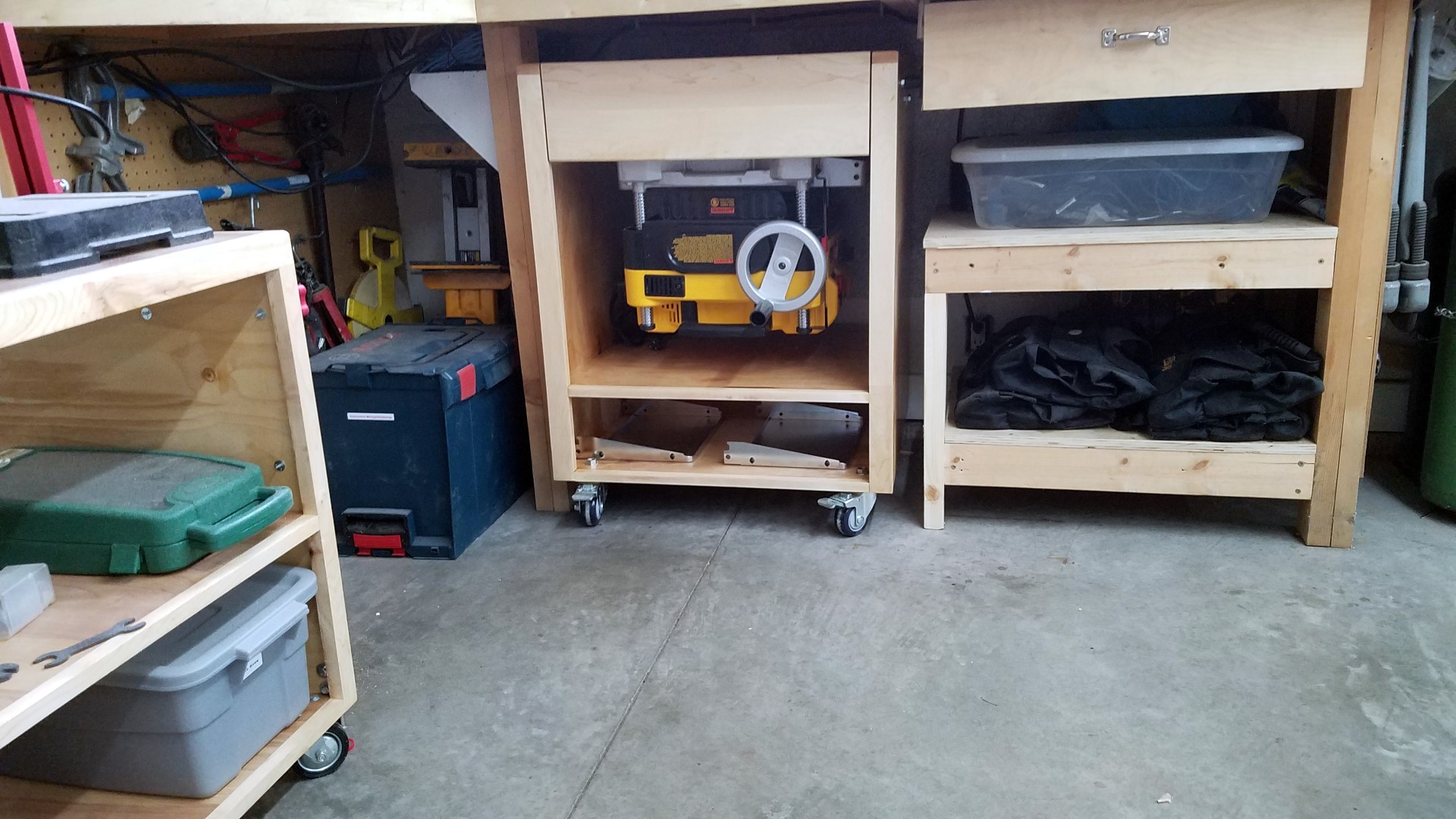

The main reason for my flip top design was to have the planer at a comfortable working height and then be able to flip it down and slide it under one of my work benches. I would have loved to add a second tool on the top but then it would not fit under my bench. It seemed like a waste to have the second surface with nothing on it so I decided to incorporate a section of old Festool MFT top into the flip side which will allow me to use my 20mm dogs and Festool clamps.
I built it at the exact same height as my Festool MFT table so I can use it as a support extension if needed.
Everything I built starts in CAD.  I used to do everything in AutoCAD but switched to Sketchup a few years ago.

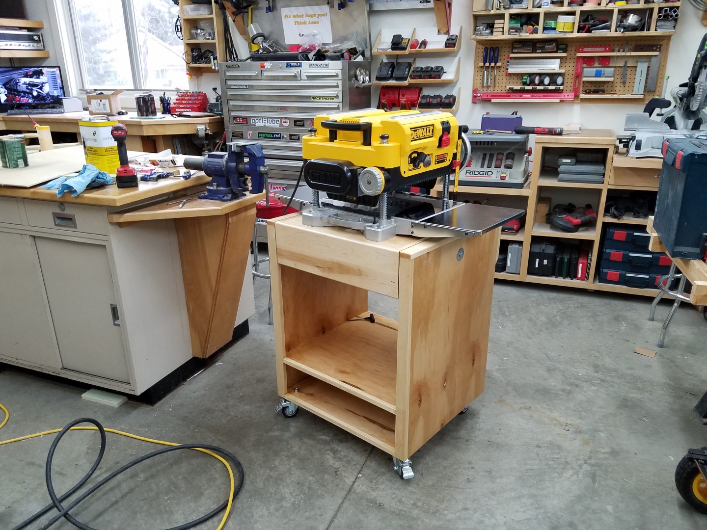

So here is the stand with the rotating tables shown in both locations.
Here it is with the planer in working position.
And here it is flipped over with the Festool top up.
And finally, the main design objective with it stored away.

Rich, how easy is that to flip over with the planer mounted on it? I know that planer is really heavy.
Does the top rotate or do you need to physically take it out and flip it?
When I move my planer around on its stand, it feels like it could tip over if I wasn’t careful.

That flip top stand looks great. I am really liking mine so far. @tugnut you don’t take the planer off. It is easy to flip over. With only one tool it is top heavy so you have to steady it when you flip it. Mine is slightly off center due to me using too big of a bit the first time. It works thought to help clear the out fees table.

tugnut1 wrote:
Super Easy John.  One handed.  The handles on top of planer are in perfect spot and ideal for rotating it.

Looks great, but do you have to push it against a stationary bench to use it?
I could imagine it trying to move around as your feeding a 10ft board through it.
Very nice work, love the shop.
rrmccabeMember since Jan 2017
It seems to hold great with 4 locking casters. I had a fall back plan to add jacking screws or something else to stabilize it but doesn’t appear I am going to need to do anything.
